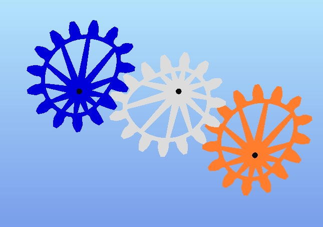

PS Meshing on blue and white is perfect Orange not so much but better that it was.

Re: New version 1.15 of GT.
  Your meshing may be off because you have a wheel running on a wheel? With modified ellipticals you can only run a pinion off a wheel or a wheel off a pinion, but never a pinion off a pinion
or a wheel off a wheel..
Ooops - sorry on the meshing third gear - senior moment!
