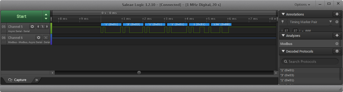

- Posts: 152
Re: Functional overview
so far so good , one little weird bit
myser.SendTable();
does nothing unless preceeded with a senddata() at least once
so I did it this way , result below :)
myser.SendTable();
Code: Select all

- Posts: 152
not sure whats happening here , vfd[3] and vfd[4] don't get sent at all they just vanish

- Posts: 152
ToInt() does the trick for sendhex , will try table again
thanks
thanks
- Posts: 152
ToInt() does the trick for sendtable too
next step crc calc
next step crc calc
Richard:
Ill look at adding a crcfromtable command..
