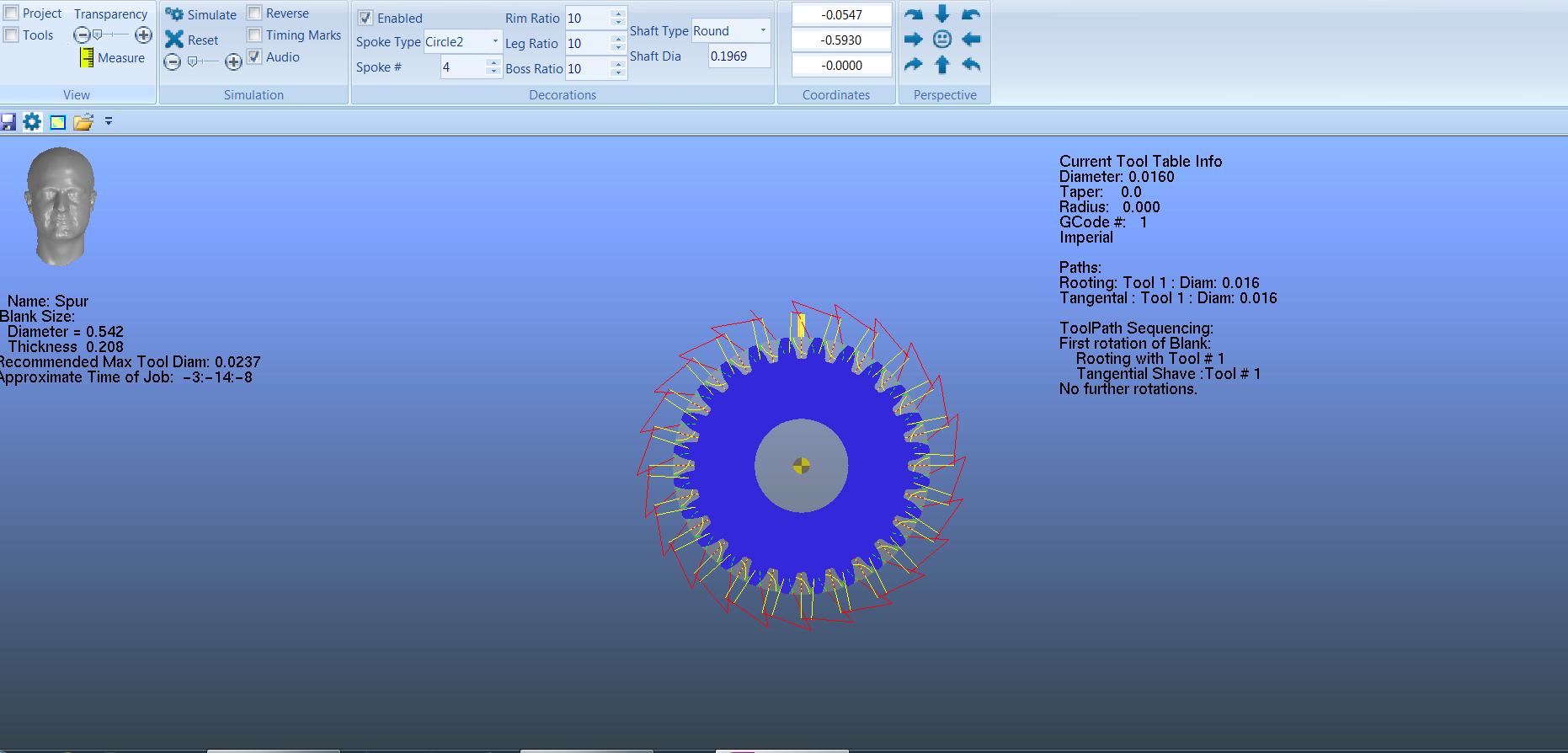

Hi,
I am new to this but am trying to cut a straight spur gear, 24 tooth, 48 D. P., 20 degree P. A. using a .016 cutter. One problem I was having was that when clicking add wheel to project the teeth would disappear so it looked like a clock gear. Now it doesn't do that but when I click on tangental and look at the tool path it looks like it is cutting out the tooth rather than the valley in the gear. Its even worse when I click rooting, and then tangental where it cuts out the valley then jumps over and takes out the tooth.. I'm assuming I am doing something wrong due to inexperience but cant figure out what?

  Can you post the project file here so I can take a look. I cant imagien why the teeth diappeared, but I am aware of a bug where it is possible for the graphics simulation to mess up and be 1/2 tooth out of position making it look as if your machining the tooth rather than the valley. ( In this case though, the cut still works, though the graphics are wrong.
  Ill check the project and see if I can see the mabiguity that causes this..

I think what you described is what it is doing. I can see the tool path lines going up both sides in the center of the tooth. I must admit that I am more familiar with other forums and actually don't know how to post the project file on this forum. I was able to do a screen shot but because it's a .png file I can't save it here as an image. And can't change it to a .jpg file. I thought the screen shot would show you the tool paths but I cant get there from here. Is there somewhere on the forum that gives directions for doing these sort of things?

Re: 4th axis gear cutting
Art:
Just thought Id mention, Ive checked and the epicycloidics in some circumstances will draw the path in the tooth rather
than the space, however, the path is fine, just a graphics issue, on my list for repair.

I'll try this again. Well as far as I know I have attached Val timing gears.gth, and val screen shot.png. If that didn't work as expected Ill have to try it again.

Hi Art:
  As I suspected, its a graphics bug, its on my repair list for fall.
Thx for the report. Your toolpath will be fine, this shouldnt affect
any cut work. :)
