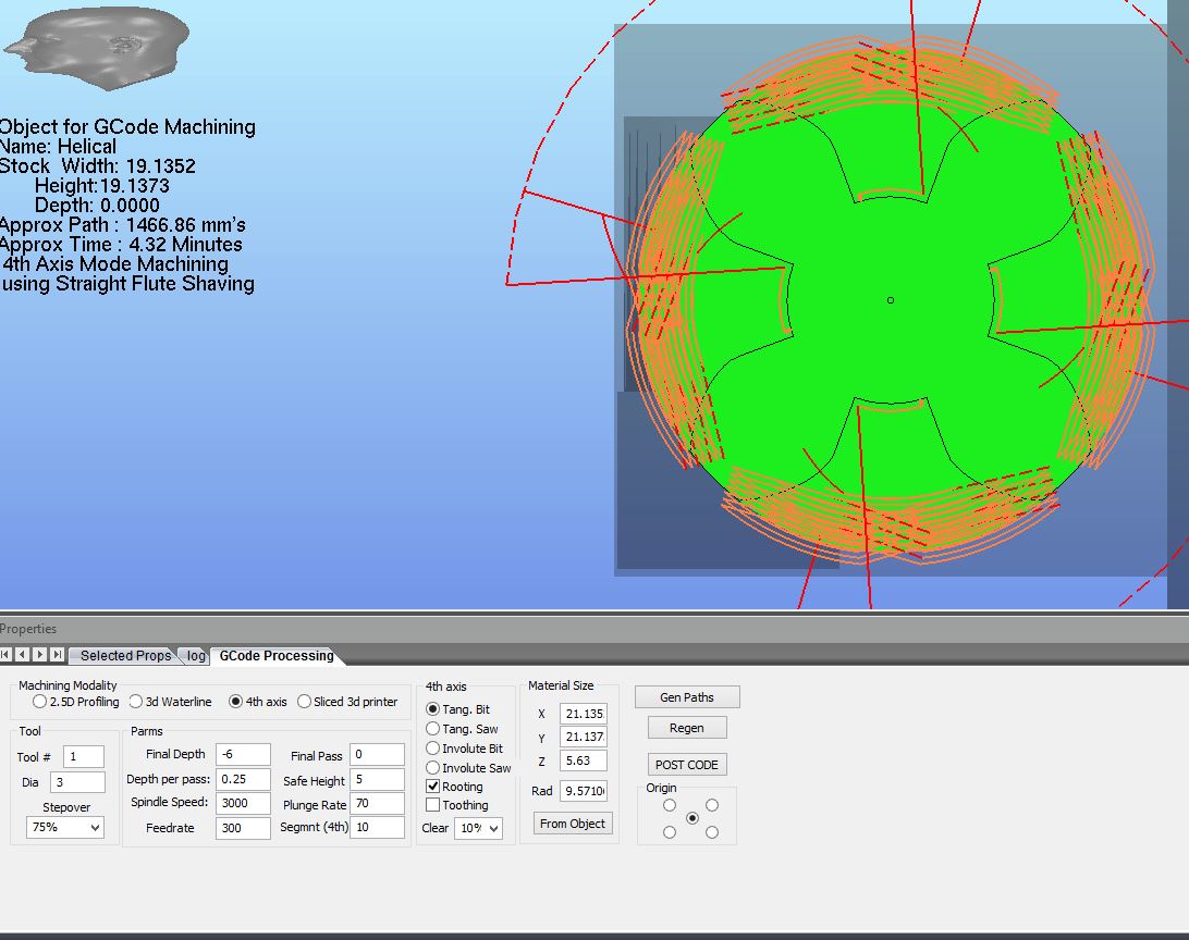

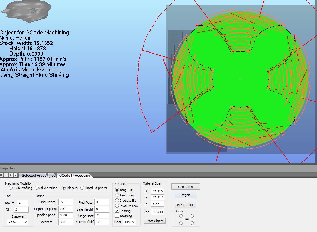

Hi Art, I'm not sure what's going on when rooting. With a step of 0.5 things look as expected. If I have a step of 0.25mm it steps correctly to a depth of 2.0mm then it jumps to the full depth of 5.625mm?

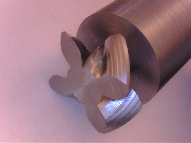

Success, very well done Art.

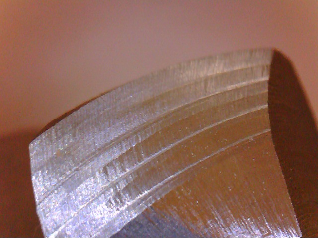

PS: Again the tool marks look worse than they are, although I thing they may be significant enough to result in excessive wear. Does the algorithm put the flank of the cutter at the tangent point or the cutter tip at the tangent point?

Regarding the tool marks on the tooth flanks. I checked for lost motion on my machine and I have only 0.02mm on the y axis and 0.003mm at a 10mm radius on the A axis. In any case looking at the code the y axis movements are all in one direction and the only cut where the end corner of the end mill is at the tangent point is the first cut. So the most probable cause of the tool marks may be left-overs from the rooting stage, although the number of marks doesn't seem to match the depth per step for the rooting. I may have to play with the rooting clearance some more. I'm not sure using the same tool clearance number as used at the end/beginning of each pass is a good long term solution.

The marks are more from that plane thing I was talking about, as the plane of the profile goes flatter and flatter to one Z plane, the tangent functions approach infinity. ( Tan(90) = Infinity) and it causes such things. Raising the rooting path can help.
Im unsure why the rooting was so deep, there is a bug that causes it to be weird if the stepdown is too large, the stepdown has to be small enough for at least 1 pass otherwise it fails to make any passes. Im looking into it.

Yes but the first tool marks are way down close to the base diameter so the tangent shouldn't be to tough down there, or should it? The tool marks are the same magnitude all the way up the tooth flank?

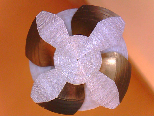

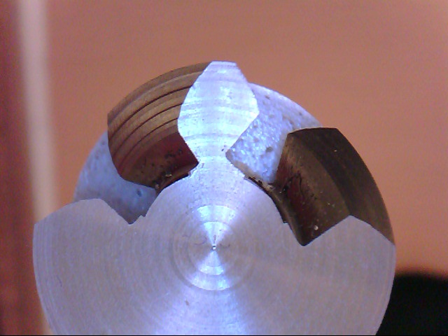

Sorry Art but I don't think we are there yet. See attached photo: Left tooth space is set to 25% clearance and the right tooth space is set to 50%. The tooth profile includes the toothing cut in both cases. I'm not sure I still have the file but I think yesterdays run must have been set at 10% clearance.
Also the tool marks are from the toothing cut not left over from the rooting cut. I managed to get close enough to see what was happening. Z may stay constant but because of the blank rotation the tool tip effectively rises up the tooth flank for each rotation step. If the tool flank shaved at the tangent point rather than the tool tip at the tangent point then the tool marks would be avoided. Probably much easier said than done. Possibly all that is needed is to subtract a small % of the tool diameter form the z height. for each toothing pass.
