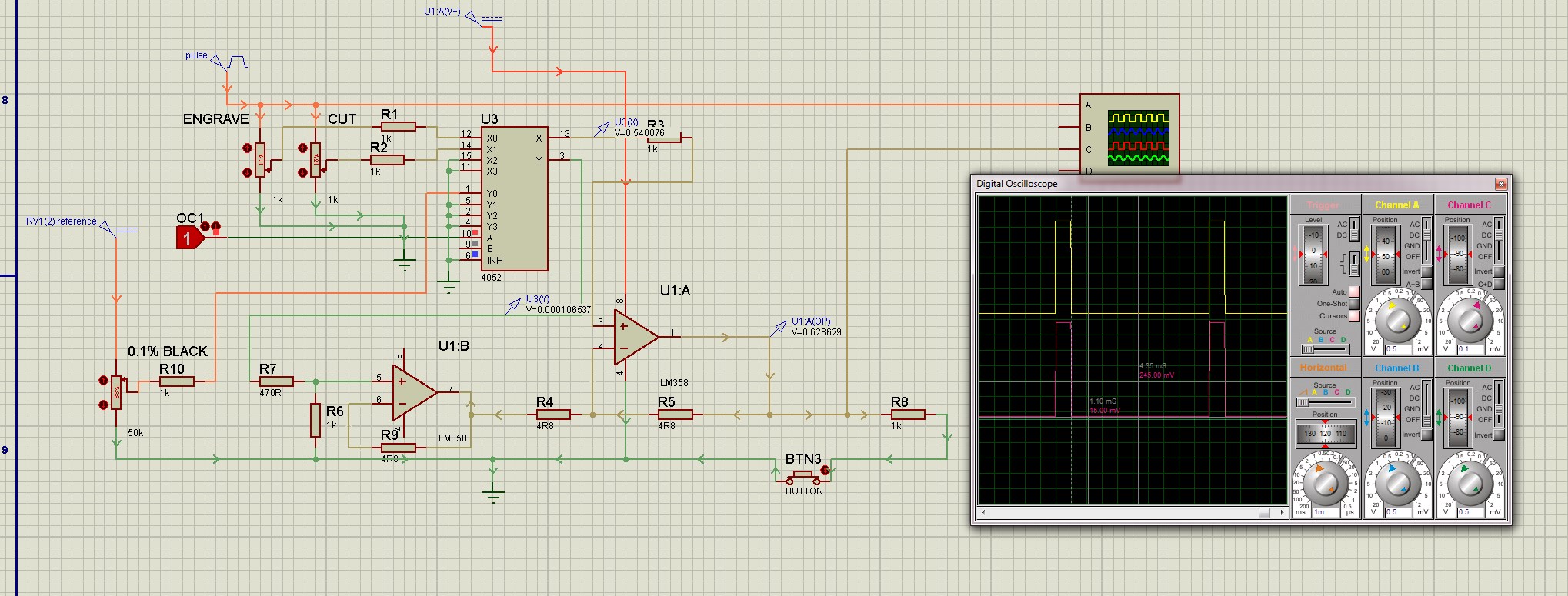

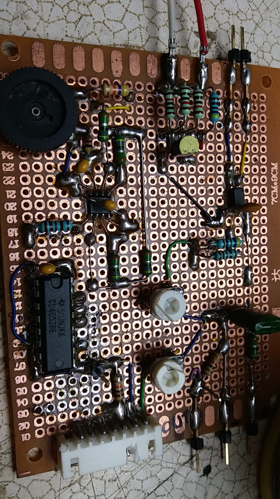

I post the schematic , is simple easy and working with no delay
as analog do. The interface was made on the knees " just for test"
but is working . And to be honest i dont think i will bother to made
the circuit board in the future.
I give up with NPN open collector transistor for function switch ,
seems inducing some bad ripple in the system.
I end with a very cheap MUX and is way better and remain more channels to "update".

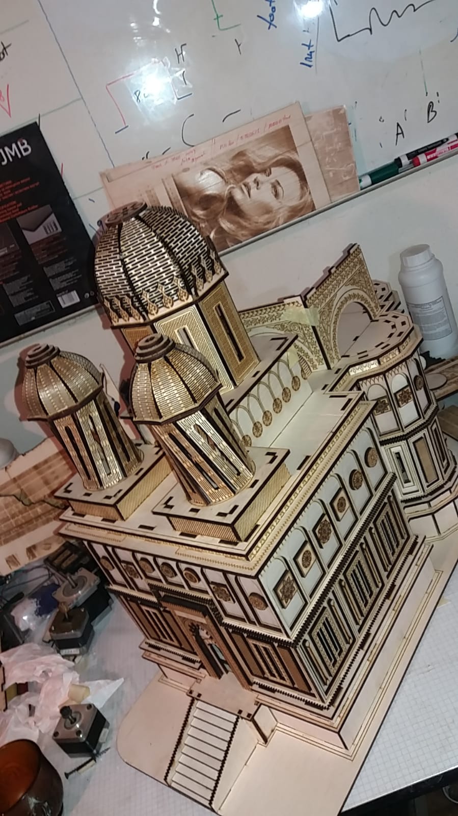

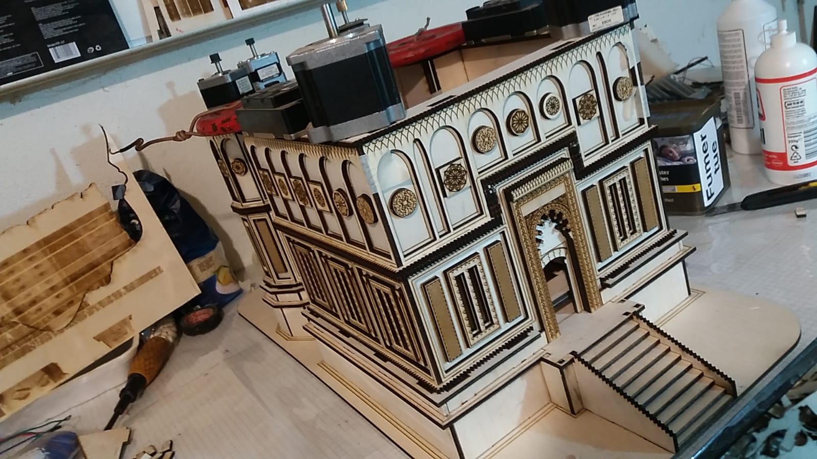

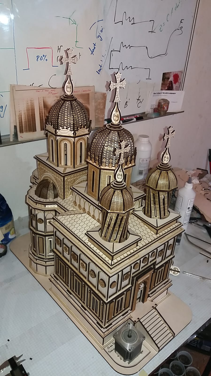

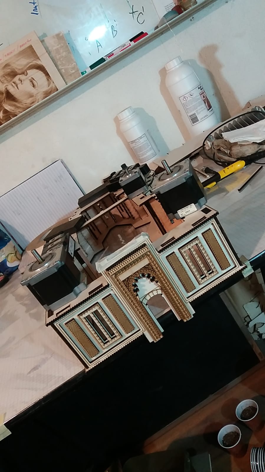

Hi everyone .
Time by time , getting experience . Never work before with
stuff like that .
Seems not only engraving give u a satisfaction.
It is a monastery from my town . Was made it long time ago
and my wife give me a chalenge .
I hope u like it

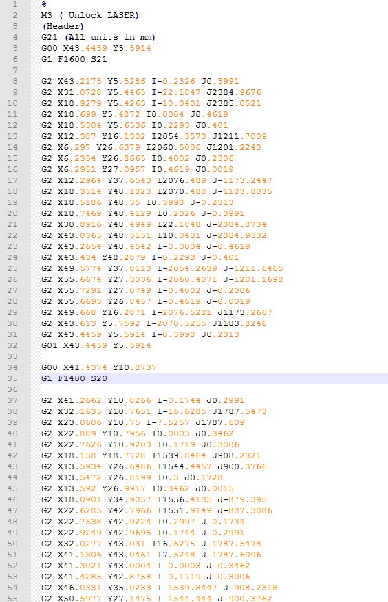

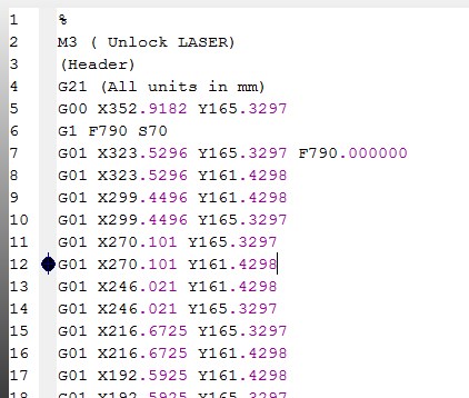

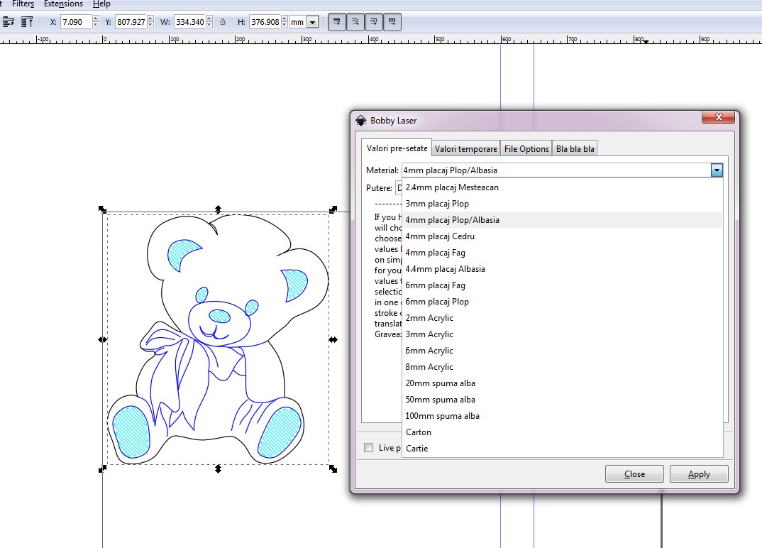

Now i have a huge problem and i can't solve that . I just dont understand what happen
and that have connection with my old issue about laser power .
I made a extension for inkscape to burn and cut with different powers on different
type of polywood . I remove all unnecessary comments in GCODE as you advice was.
I remove even the path names and print comment on Auggie script , hopping
the system don't get spammed.
The problem appear when i made any shape with more than one power set.
The system will start engraving the paths with different powers and on last
path with engrave power, Auggie show the right power set but the PWM will go out on full
power . After last engrave path (of course with wrong power) the system will
run normaly.
Doesn't matter if i create 2 or 3 or 1000 pieces , if i keep same power in same code
is ok , if i change it , my laser jump in 100% power :(
I dont know how to solve that and what is the problem .
I put below the file of GCODE and SVG with simple test
maybe someone will figure out what's going on, that make me crazy ???

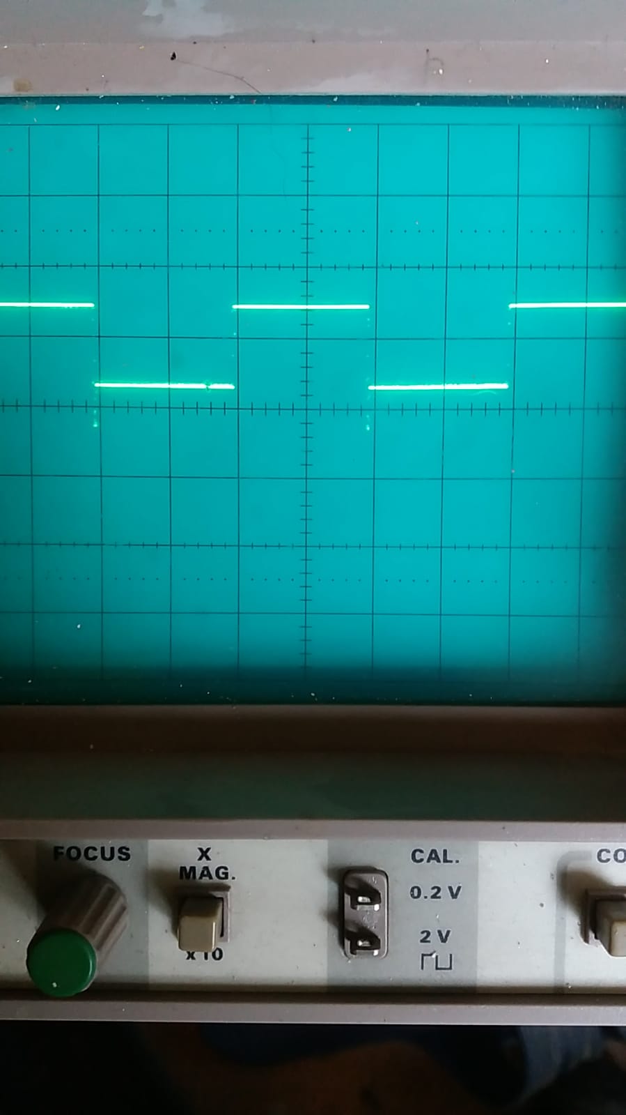

Note. I remember was some time , i didn't has that issue . After i change the PWM to 0.000625
Anyway i try different type of PWM thinking is my analog mux fault but after i put the osciloscope
i saw the PWm going out in full power.
Also i notice in Auggie the GCODE dont have the spaces as i created to be .
Bobby

Re: My laser engraver from 0 knowledge to 32.461% .... probably
This sounds like a rewind bug of some sort. As if the system is resetting due to hitting the end of the file, but the
job isnt yet done. Can you try adding a G04P10 at the end, this will force the system to complete everything
it is doing before actually running the G04 delay. The mode switch will stop it from rewinding till done...
Im curious if that has an effect..
Well , you right as usual . Yes has effect , i try it with P10 , P1 and P0.1
I think P10 is 10 sec , so i need less possible of course .
Now i will try to implement in my extension at the end of each path and i will try more complex
"colors=power" to see how that work .
Let me some time to write that and i will comeback with answer with big test "at least 4 power levels in code"
Thanks for now .
Bobby
Hi Bob . Well , i don't say is any issue with M3 ,but long time ago i made a extension for Inkscape to be able toBobL wrote: I'm personally not aware of any issues with the M3
generate the GCODE in a single file with different powers and speeds by line color. As example for "poplar plywood "
need very low power and high speed for engrave a text and for "oak plywood" need a different power and speed. Also for cutting
so unless to manual adjust , i put all together in a single GCODE file. In same example i use RED for half cutting, BLUE for deep engrave
GREEN for light hatch fill engrave and BLACK for cutting.
On that time i put on the start of each path M3 and M5 on the end. Art suggest to don't put that on each path because i will " spam "
the system. He has right and i remove the M5 and M3 during the job and i let it only on start the code and end.
The extension work great but if any error happen , or EStop get disable by random reason, can't start again the M3
in the middle of job . So i put back the M3 command on each path job begin.
Like that i will lose a small part of cut or engrave until the path job are done.
I'm sure exist a way to do full path rewind but i'm not expert in programming , is just for my hobby.
I attach below, i writed in 2 languages as usualy i do " bad habit ;D"
Hi again.
Well that didn't take to long.
Looking on my post with M3 essential picture , i notice where was the error.
In the extension i duplicate in the mistake the " feed " before the "path"
with G1 and also in time of job with G01.
Actualy i looking on G4 comment "delay 100ms " and that was modified as 10ms :D
I don't know if that make sense , but for sure is not necesary to double the feed in same path job.
The luck was when i made a screenshot , the yellow line was exactly on that point where was
doubled the "feed" and jumping in my eyes.
So i remove now and i will do some test's. ::)

All good , but i don't engrave day by day , is just for my knowlegde and do stuff for
some friends , but yesterday i engrave a small photo and of course to cut after
i switch to cut mode , i go to zero and from the last line"right corner" when the laser
return in rapid move i think G00 , was ok , and after i go " g1x10f7000 " to eliminate the
ramp 10mm i got the big line burn at full power. That's mean the M3 still on.
I look in program and i think the system got spammed because he don't hit the M5 .
Is how look at me .
Before this version was ok , that happen after Art update the BIG screen photo editor.
I mean that was a blessing for me , i just want to let you know Art what i found out .
That is what i use at the end of any program and work like a cham
Bobby
Some time ago i made a interface to switch between engrave and cut
with one button and also to calibrate the minimum laser power
to start a burn , like a laser offset.
Code: Select all
M30
( Augmented Machine Controller Program End)
M5
M30 Before this version was ok , that happen after Art update the BIG screen photo editor.
Code: Select all
(Footer)
M5 (LOCK)
G00 X0 Y0 (Return to 0)
M2 (END)
M30 (rewind)Bobby
