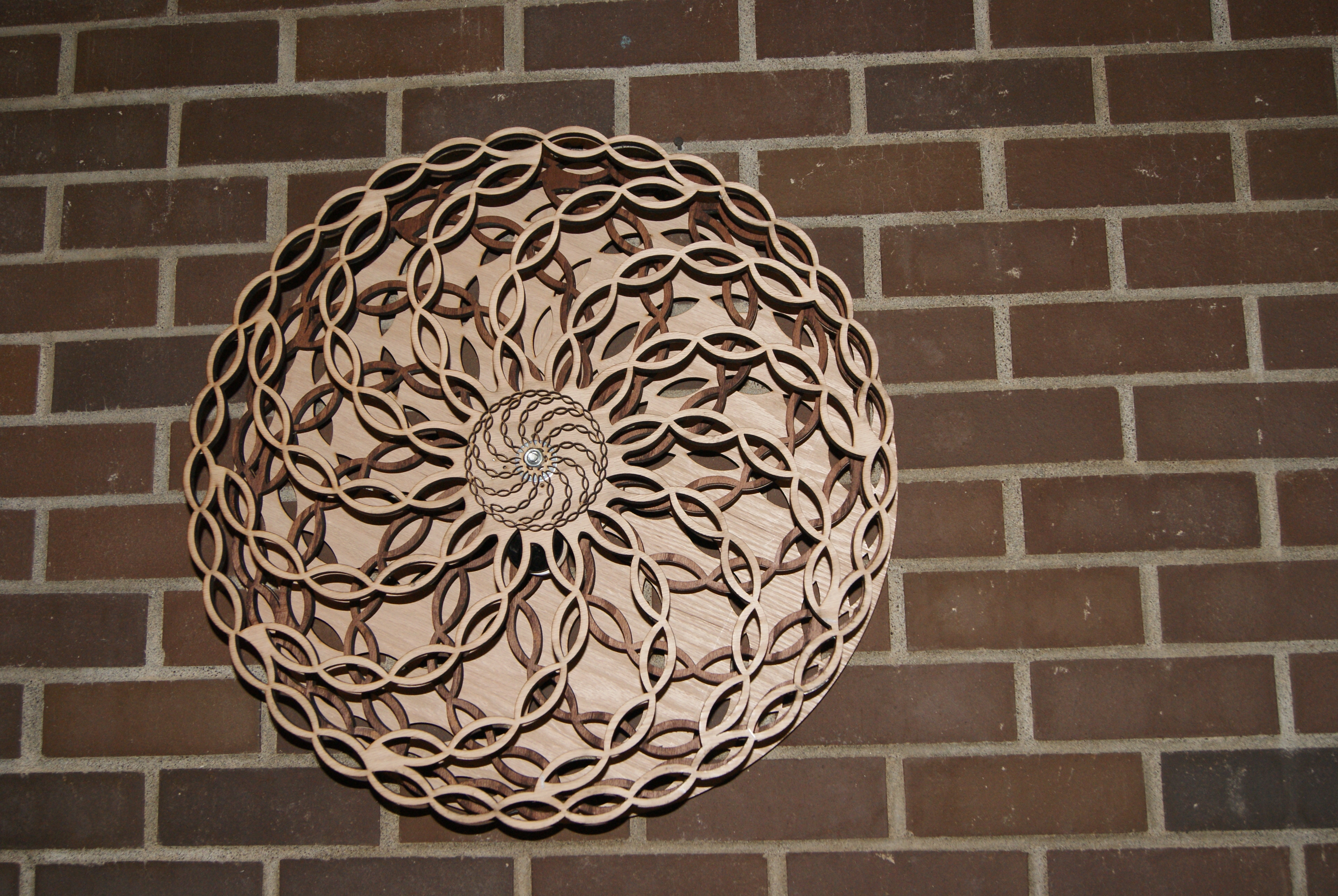

I built my version of Zinna about 5 years ago . I cut my design out with a laser. As I recall I could not get the correct part from SDI becuase they were out and it would take several months before they had them. I did a search and found the supplier that makes them for SDI and here is what I found
spring width 3/8"
spring length 106"
torque 1.13Lb in
spring width 3/8"
spring length 106"
torque 1.13Lb in
