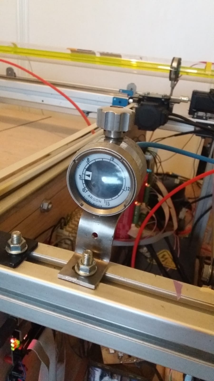

Is not realy a big deal , but even is a fridge motor turned as compressor , he made some noise ,
and in time of "study " to turn off without move from my PC .Also i figure out , the air pressure
change total'y the final result , depend of material . I mount a regulator from " argon tig welder "
I'm not on my native home right now to made some real test's but i assume , if i use " argon " instead of air ,
cutting on wood will be better . I think ,

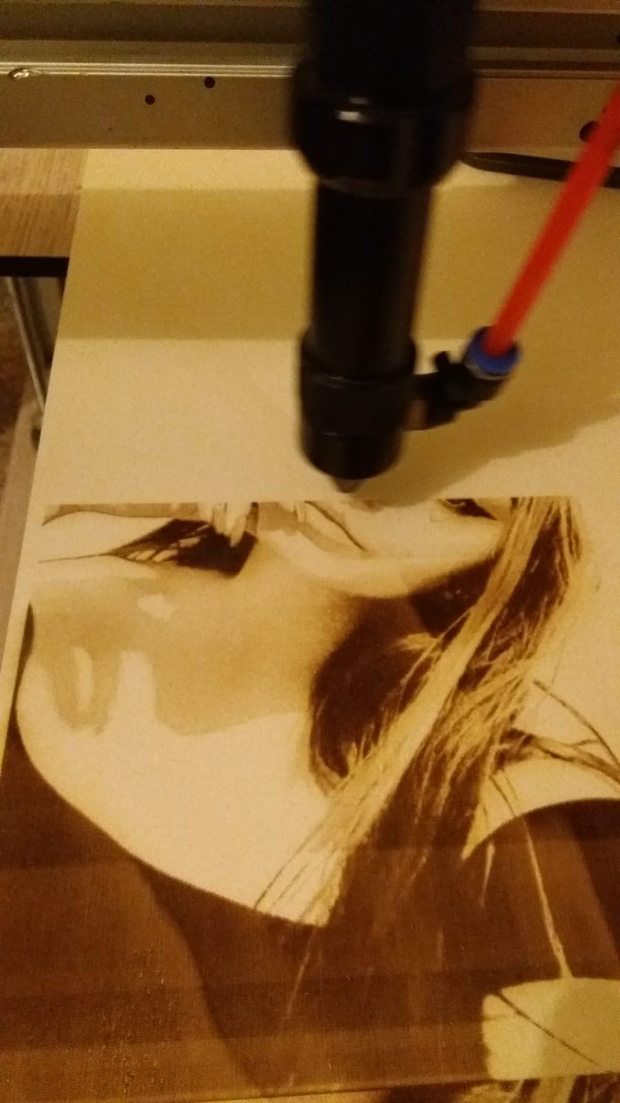

Hello everyone
I have some " stupid " questions. :-\
Of course are releated at AUGS module used for generated the code for engrave .
First of all english is not my native , i have double nationality of my parents , english is fourth language necesary to get it work,
so i apologise for my gramma .
I figure out how to properly set my speed / power / for engrave , i modify totaly my source and all good, but.
I did't get some "basic" knowledge about AUGS module .
1: I calculated by size , on my photo , the pixel resolution , according with optimal shooting time ,speed and beam size
and on some picture after i generate the code auggie say me error and wont display after i load the code .
Exist some size limit , or just extension fault ? Many time i change from png to jpg and work , keeping resolution , but not all time
That confuse me a little
2: I think " StepOver " is represent the beam size , and is how much one axe will step to scale the image
That's correct ?
3: I don't get it what "ramp " does , i try different from 1 to 500 and , but i think is strict about image size , or not ?
I try to zoom after auggie generate , and i don't see to much difference , actualy i don't see at all on any value .
4: It is the picture showed in auggie panel after load the code , the real one loaded from code ? Because i try different resolutions
and after zoom in i didn't seen any effect , is like the imagine remain at very poor resolution .
Thanks , I will put pictures soon i will get better .
And how Art advice me , i learn some standard GCODE command , and , yea , is more easy , after some time , is like you brain do it without think about
you just know what will happen .
Thanks for now
Bobby

Re: My laser engraver from 0 knowledge to 11.362% .... probably
Hi Bobby:
Glad to hear your getting more experience.. Here are some thoughts..
>>>>1: I calculate d by size , on my photo , the pixel resolution , according with optimal shooting time ,speed and beam size
Exist some size limit , or just extension fault ? Many time i change from png to jpg and work , keeping resolutio n , but not all time
You can in theory load any resolution image, though I have had memory problems with huge ones. You shouldnt have
to calculate any optimal timing for a photo, just the output size in mm or inches.. whatever you use. You do need
to make sure you change those two DRO's ( XSize and YSize) to make it do output. Some images may cause trouble,
the image importer may screw up on some image types as they can vary in specification.
That's correct ?
Not really.. though you can set it to the beam width, what it does is divide the Y dimension by that amount of passes
so each pass moves forward by "StepOver" amount. On some materials an overlap is good, on some youd want none.
As you lower the stepover, the cut time will increase.
I try to zoom after auggie generate , and i don't see to much differenc e , actualy i don't see at all on any value .
Ramp sets how far away from the photo the X path starts and ends. It is good for quality to have the axis up to speed
on each pass before it starts to cut. So if Ramp is 1" , then it will start and end 1" before and after the photo. This ensures
a constant speed while photo engraving. In truth , Auggie will burn only when in the photo box so one could do spirals or
random lines and still burn the photo, so ramping is just a way of ensuring constant speed and power capability.
4: It is the picture showed in auggie panel after load the code , the real one loaded from code ? Because i try different resolutio ns
and after zoom in i didn't seen any effect , is like the imagine remain at very poor resolutio n .
The photo that is shown is the interpolated data from the image. It is what the GCode will see. If the end cut has a resolution
of 10 inches in the X direction , for example, but the photo has only 100 pixels in the X, the photo shown will look low resolution.
Hope this helps,

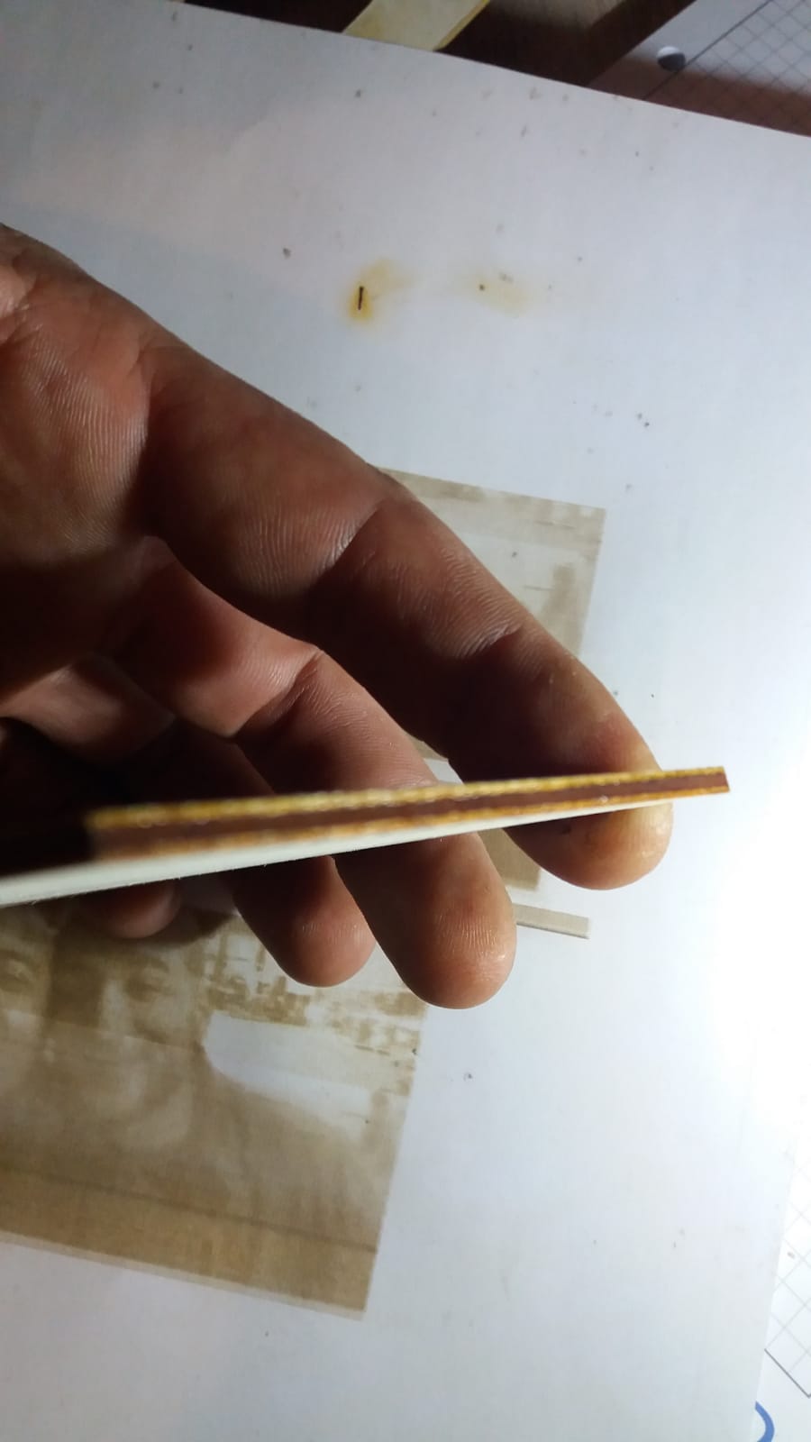

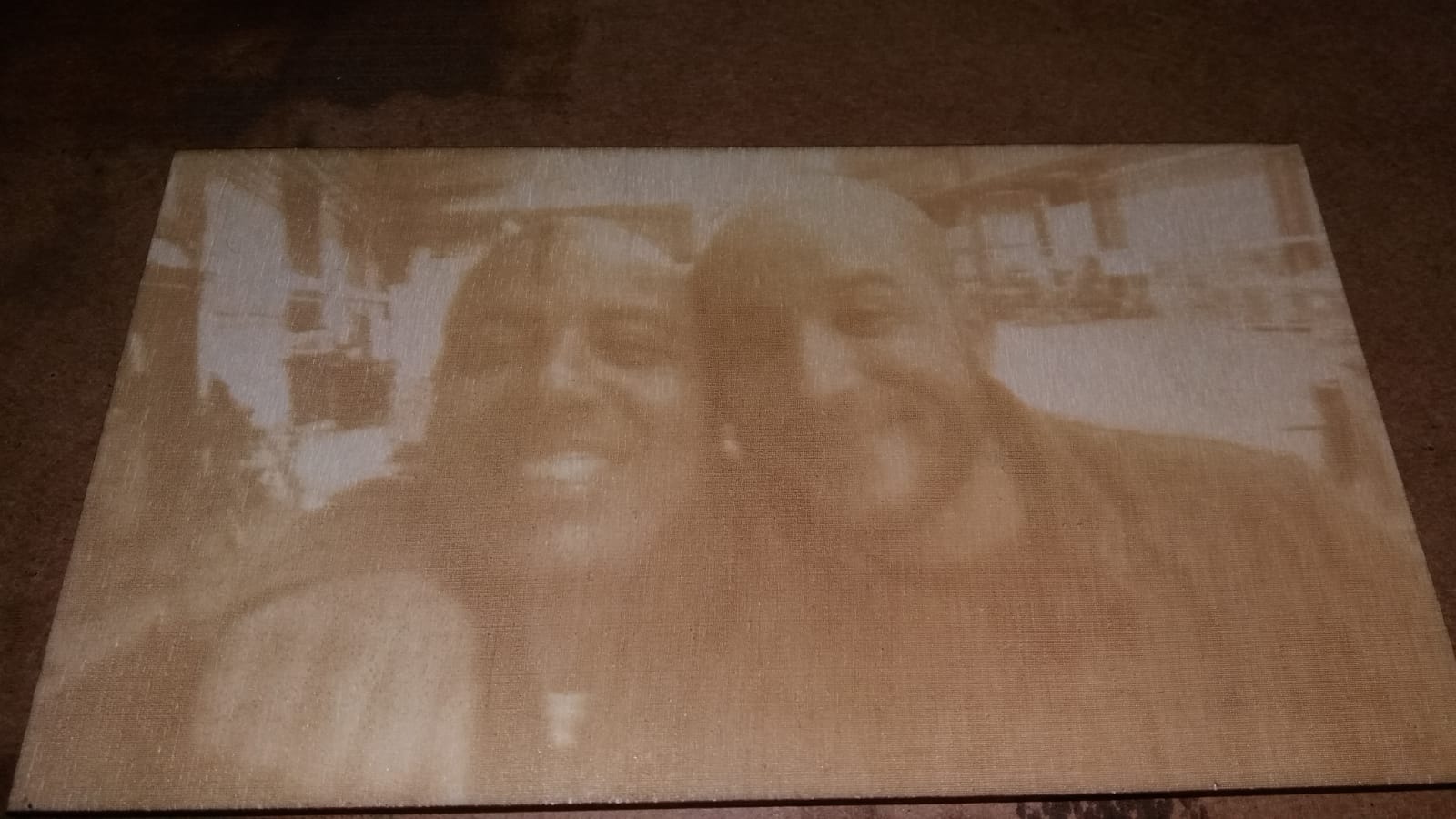

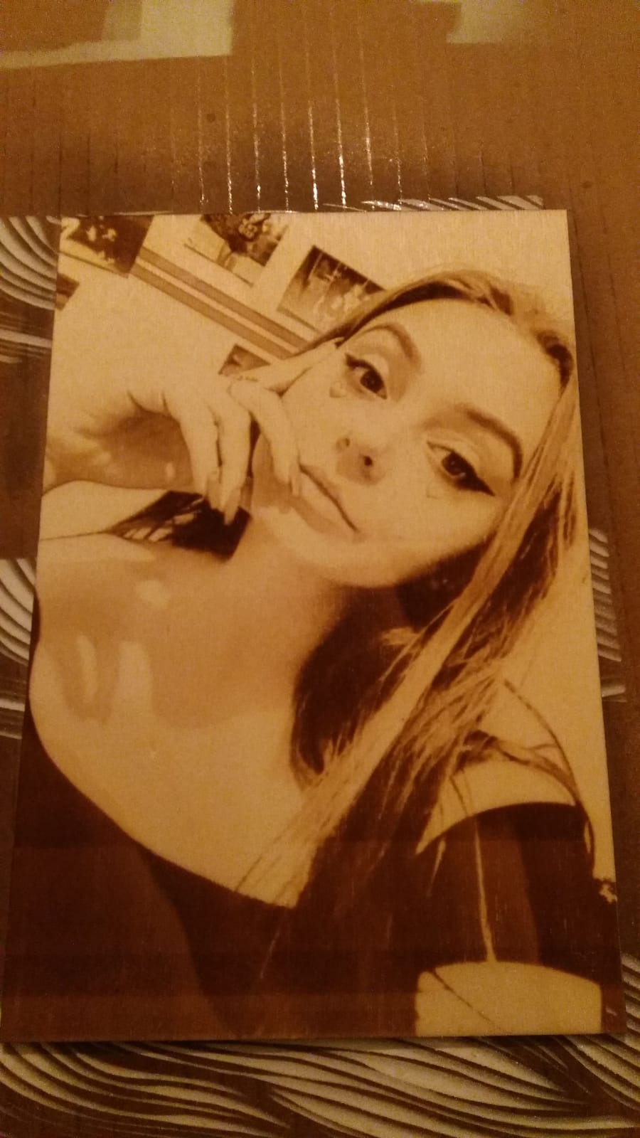

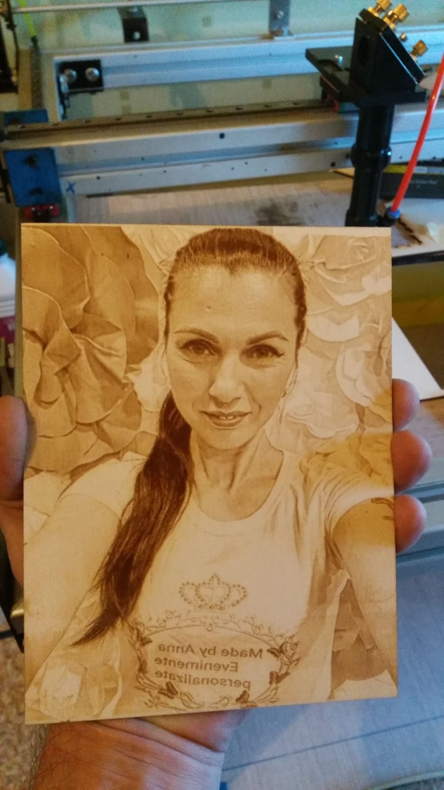

Hi everyone
After a lot of fails , i manage to get what is wrong on my laser power. Take it away the source problems
i notice , my laser is to powerful on minim power . How i figure out ? I explain.
I made a black square at 100x100mm and i start to engrave . During engrave i try to adjust manual the power ,
and i notice , i can get only 10% grey and after fine adjust jump instead to 100% (black) ;
So i start to find a solution , and better was to calsulate the speed travel , frequency of PWM and duration pulse
on that speed. Finaly i was impress myself , the good result start to arrive .
I put some photos below. I can engrave like that almost like multipass engrave at 1mm deep with very good result when
you don't look face to face to the picture.
