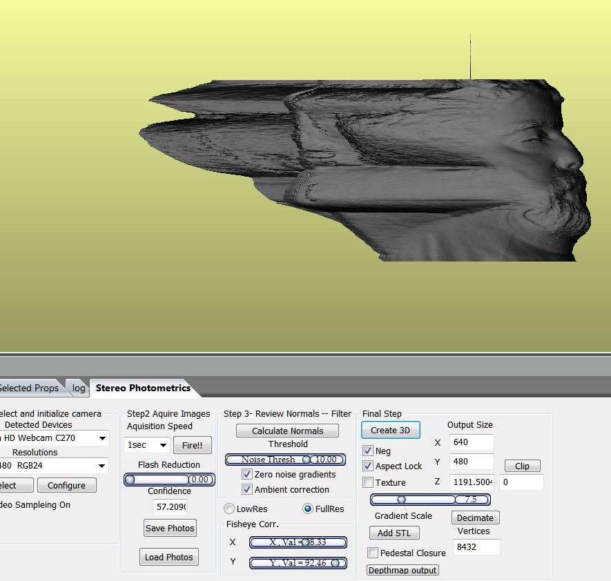

Thanks. At first, I was not sure what you meant by changing the output to something reasonable. Then I hit Add STL several times and realized that it said change it from pixels to inches or mm. I just deleted a zero and it was happy. I'm not sure if it thinks that it is inches or mm.
The captured images don't look very good. I thought that it was exposure so I changed the Aquisition speed.
I switched to a TV screen that is 38" diagonal. I taped the webcam to the center of the screen and turn the lights off.
Aquisition speed questions. It does not seem to make much difference here is 25ms
and here is 250ms
Aquisition speed does seem to increase the confidence but I'm gettings numbers in the 20-50 range.
I also have to change the Y fisheye correction and the gradient scale to get anything like my face. One benefit is that the rest of my head looks like the Greek god Hermes

Hi Alber:
Not unusual to get output similar to what you show. I found I had to play with the camera settings like
white balance and such to tame it down. I also recommend clipping it, this removes the drawn out background.
the output varies a lot though depending on camera used, monitor, darkness..etc.
Play with the settings, its really a matter of finding the sweet spot.

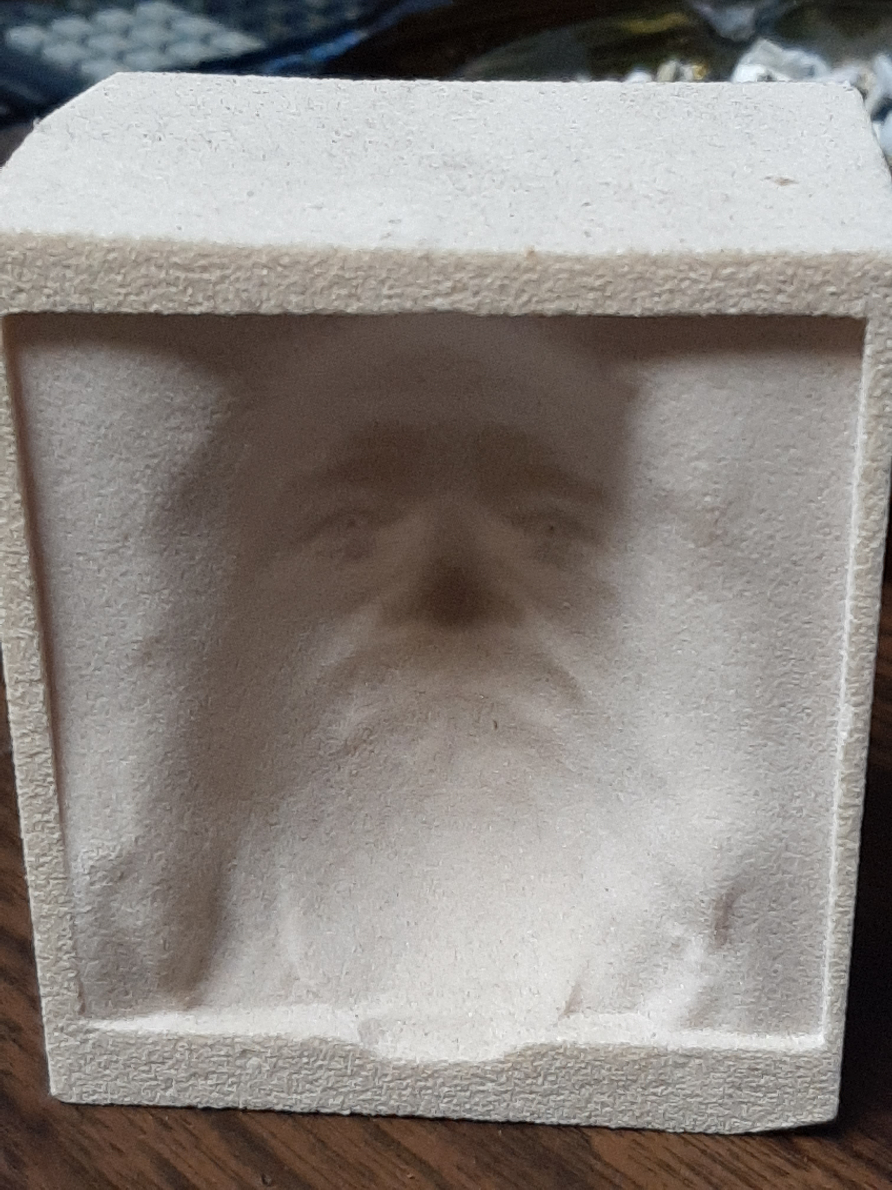

The head in the photo below was machined into HDF as an inward 3d head. Its eyes follow you as you walk past
it and its stl came form the webcam module. Its not a perfect 3d of myself, but its close enough to be eerie..

Clip will remove that back portion, think of it like slicing off the front. The rear most always gets stretched too far back
due to the poor light you really get from monitors. That module is a fascinating look at how so little information from
minor light changes can be used to determine 3d coordinates, unfortunately it takes a lot of playing with conditions
to get a good one.
