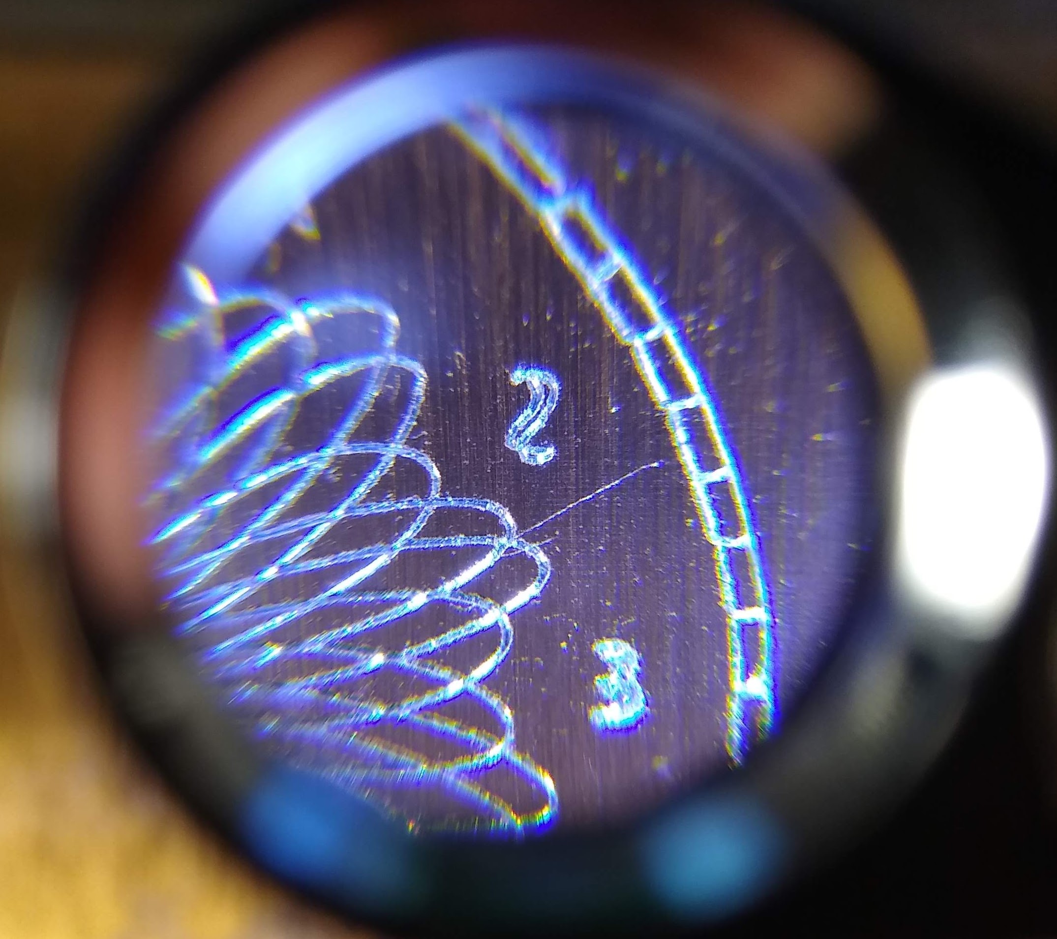

There's a small gotcha in the "2" in the magnified picture, one side is an S that descends below the bottom line.  These were un-snippable in Vexx.  Not significant since it's the old editor.

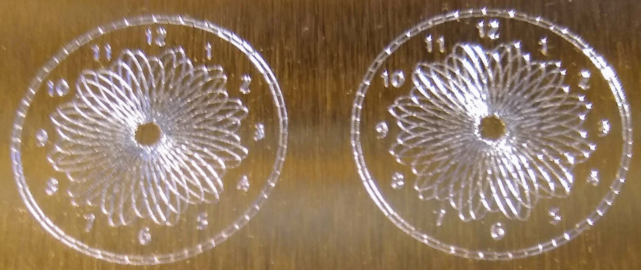

This is clock dial from the Auggie wizard with a simple guilloche pattern overlaid on top, diamond dragged at 800mm/minute and with the spring compressed 5mm (half way), trying 2.5 was too shallow a cut.  That 5mm, plus the 1mm safe height, consumes most of the cut time as it makes 200 trips up and down.

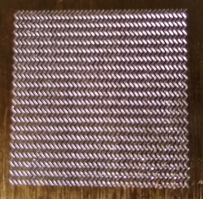

This may not look like much, but the svg file was generated with a 30 line program written in processing that creates a triangle straight line machine pattern bar and then steps it across the workpiece.  The scaling is way off, one might say non-existent, no way to change parameters except recompiling, no phasing, masking, spacing changes, pattern bar changes, etc.    Lots more to go but actually achieved a CNCable file!  First code I've written in quite a while, first attempt at processing too.  Not the easiest way, but it allows for other styles, or even customized, patterns.  Who knows, might evolve into a straight line guilloche machine simulator.
25mm sq, 90 degree diamond drag on anodized aluminum, 800 mm/minute.  Still haven't got the lighting thing, very sparkly in real life.

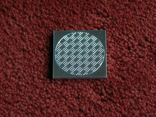

Here today some "straight-line engine turning...", with the mill.. ;).
The "basket weave"".
Small diamond engraver, aluminum (polished previously), diam. 30, depth ~ 0.05 mm, feed 75mm/min.

Re: Guilloche!
Nice!
You're ahead of me! &nbsp;I'm still working on a simulator and spent the afternoon trying to debug a basket weave pattern generator,&nbsp; darn thing is having some display issues. &nbsp;Had other distractions lately or maybe I'd have gotten further. &nbsp;How did you create that pattern?
I've been using both Peter (?) Shapiro and Roger Smith's videos as inspiration and design advice, thanks in part to your links.&nbsp; There doesn't seem to be a lot of online info on straight line machines, and I'm guessing at some of the terminology and looking at eBay and other sales offerings to get an idea of what was available as pattern bar designs
