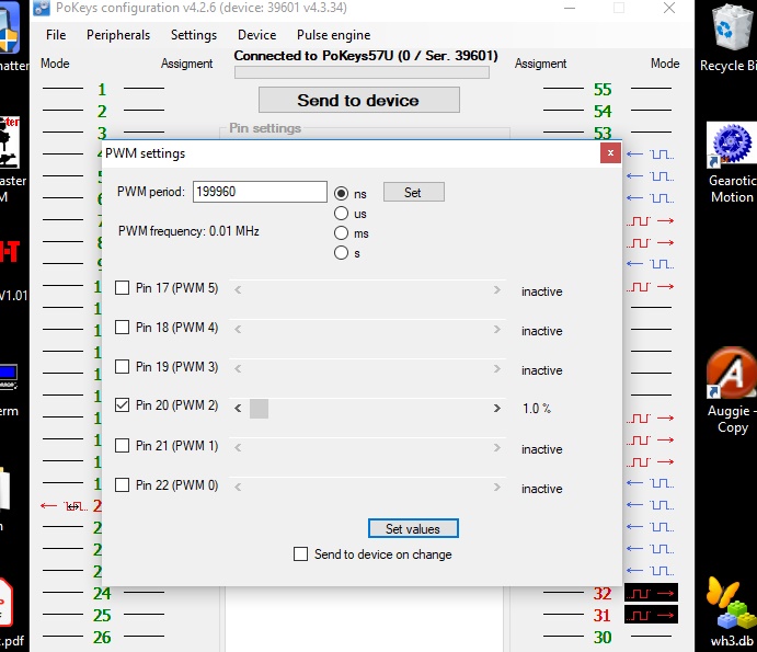

not really sure , i have made several new profiles
scripts set to ch2  , planner set to ch2  , pin20 is set to pwm
spindle engaged ,............... nothing no pwm

yes that works , as soon as auggie starts pwm stops
