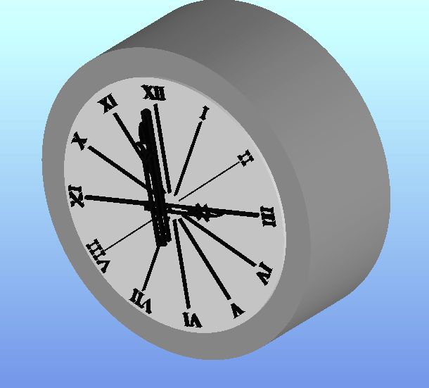

Re: Possible issue with Ngrave My workaround
I first thought that NGRAVE objects could create useful details in simulated clock mechanisms. Since my original post I've been experimenting with alternate uses of the indicator feature of Gearotic.
I've encased my chronometer simulation model with a case and added a numbered dial. The dial and case were simulated with indicators that I created using LibreCAD.
The video was captured with Camstudio, and the jpg using XNview. The video strips off the front, body, back of the case and then removes the disk behind the dial numbers.
I've been trying to standardize the way I create indicator objects to be able to have consistent scaling when added to a model. I'm not sure how useful some of my specialized additions to the indicator folder within Gearotic would be to other users, although I'd be willing to post some of them if there is interest.
Bill
Bill
