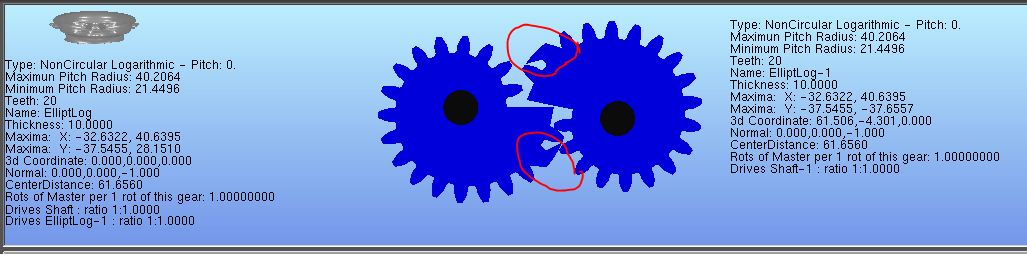

Re: New version 1.15 of GT.
First I've had a chance to look at this.
Pressed Default and then generated the two.
what am I looking at?
Is this my computer creating an issue?
don't seem to get any complete profile with any settings for logarithmic.
Nope, bug on my part. Set Mod Coeff to zero if it isn't, and press regen before pressing tooth wheel
when you change anything , press regen before toothing.
Ill fix it up, Its still a bit sensitive..
New that puppy would not run as shown, but could of sworn I'd seen a video of you generating teeth fine.
Did not want to make work for you before you left all this fine winter weather.
Stay safe, the big dog is not done yet.
Mac
Mac
- Posts: 1
- Joined: Sun May 12, 2013 8:29 am
Hello Mac, and all
I had the same problem. My solution. Set the teeth on 21 or more then it works.
Greeting Ludger (Germany)
Updated and fixed. You should eb able to use as little as 12 teeth or so. It IS possible to screw it up for sure,
but Ill slowly tighten it up as we go. In truth I CAN make it so it pretty much never screws up, but it then takes
minutes to do a toothing, the speed at which it currently works is a kind of tradeoff of reliability vs time.
Anyway, I think youll find it now works much better and the mod coeff no longer affects a log gear no matter what its set to.

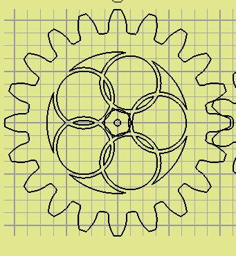

I had been having the same issue with Nautalius gears but they now work fine. I do find an issue with spokes.
The boss on several (not all) produces some impossible cuts. This is quickly visible in foam type spokes but also in simple round gears.
Like many others - I wish you a great vacation.
Thx, Ill investigate that, I knew there was an error on a couple of the fancy ones, I didnt realize it was more than 1 or 2 spoke types..
Ill fix that up...
Ill fix that up...
