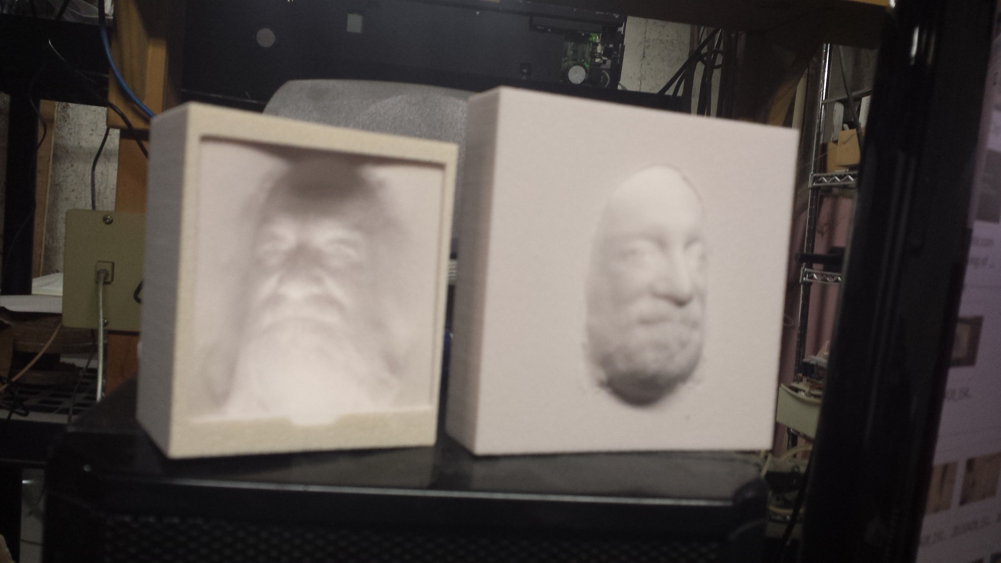

Re: Version 2.298 online.
Beautiful part Art.
What material did you machine it into? And what was the resolution of the camera and the size and shape of the cutter?
I keep thinking I need a better webcam.
Karl
Karl

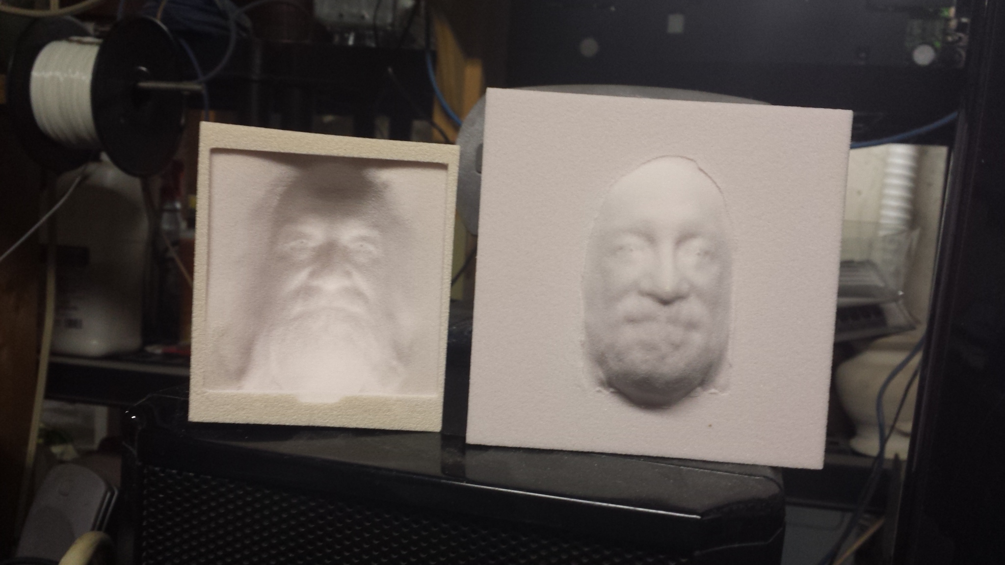

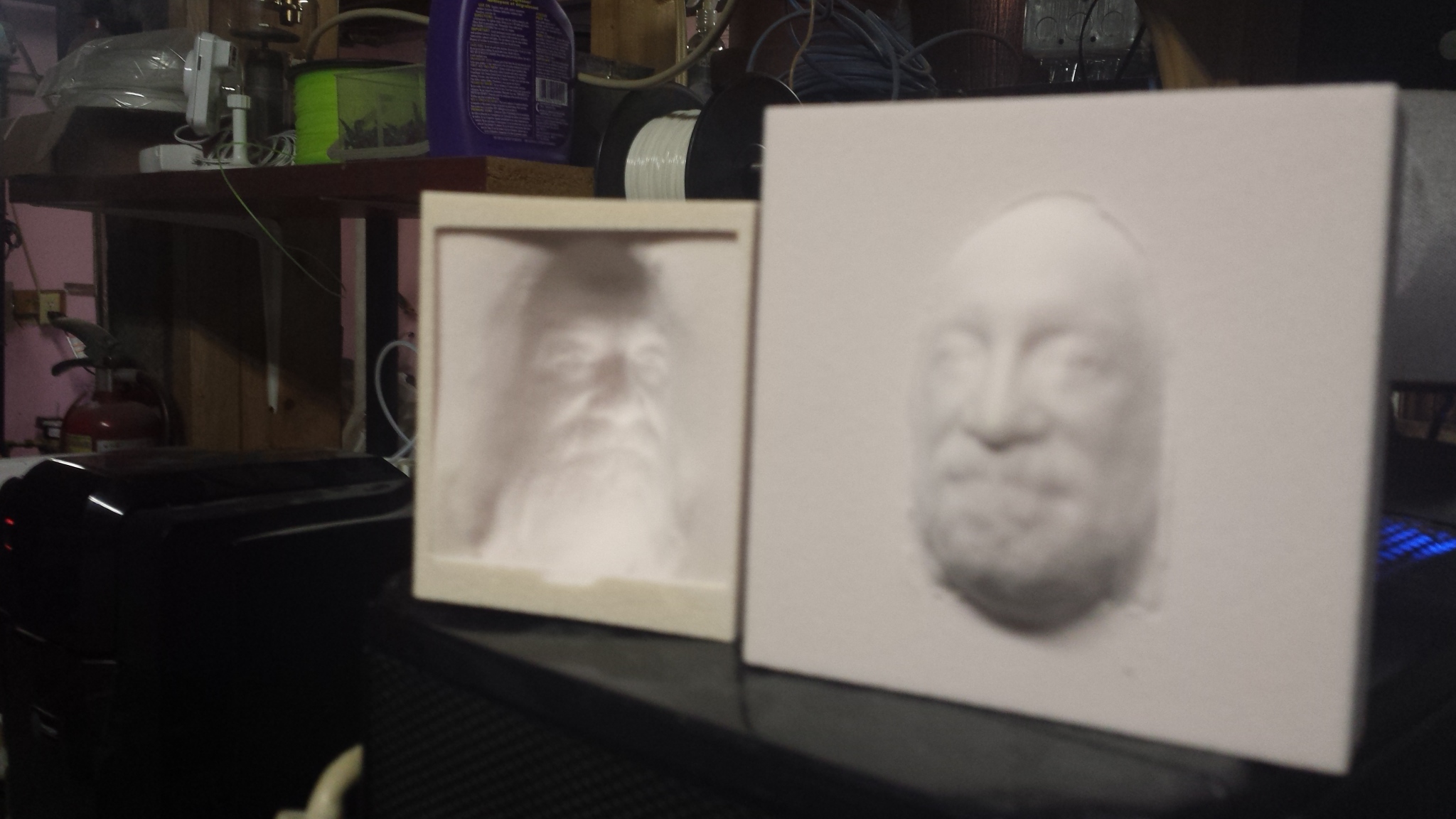

Karl:
Both items are machined in sign foam, which is very fast to machine in. The camera was my microsoft lifecam.
I did do a couple tricks though...
First, I placed black tape on each side of the camera until it framed my face. I allowed only a small
amount on either side to show, the rest was black. This made the noise field very low so it wouldnt impact the
end result , so the pull was better.
Secondly, I allowed it to pull overnight. While 90% is done in the first few minutes, that final 10% can take awhile,
so while I slept I allowed it to continue building. In the morning I stopped it and generated the GCode. Make sure
your room is as dark as you can get it.. and uncheck the "ambient correction", while I find that can help if a small
light sourece in the room is adding noise, I find overall it detracts otherwise. Ill make it default off in future.
Keep the gradient slider to about 1.95 for the large pull.
The results were the best sculptures Ive managed to make in all the years Ive worked in cnc. Detail is very high
as I used a .5mm cutter for the finsih pass.
