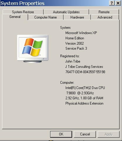

I don't know if this is any help to you,  but I have a partition on my Mac that is accessed by Parallels and runs Windows XP.  I have installed the latest dev version without any problem.  There are some peculiarities but the design portion works fine.
If I get system info this is what it says.

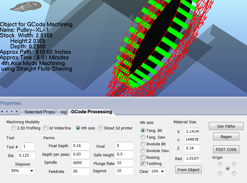

I would need a little help ???
I notice that when I go into the cnc mode to gen code for a pulley or gear I'm confused with what should I turn my OD measurements to. As per example one place says OD to be 2.0165 and in the settings shows it to be 2.1414 about .125 difference. Would the larger OD the rough size that I should turn the OD to?
Also the radius does not add up with any of the OD
![Image]()

						Re: Version Update
Hi :
Sorry about that, there isnt much documentation on that subject as yet. You should make the blank to the size shown in the information for outside diameter
of that gear on the project screen. The stock display is rather loose in that its just trying to make a blank for display, Ill check why its saying differently, but your stock should be the same size as whatever is reported as the external diameter. All cuts are based on that.
