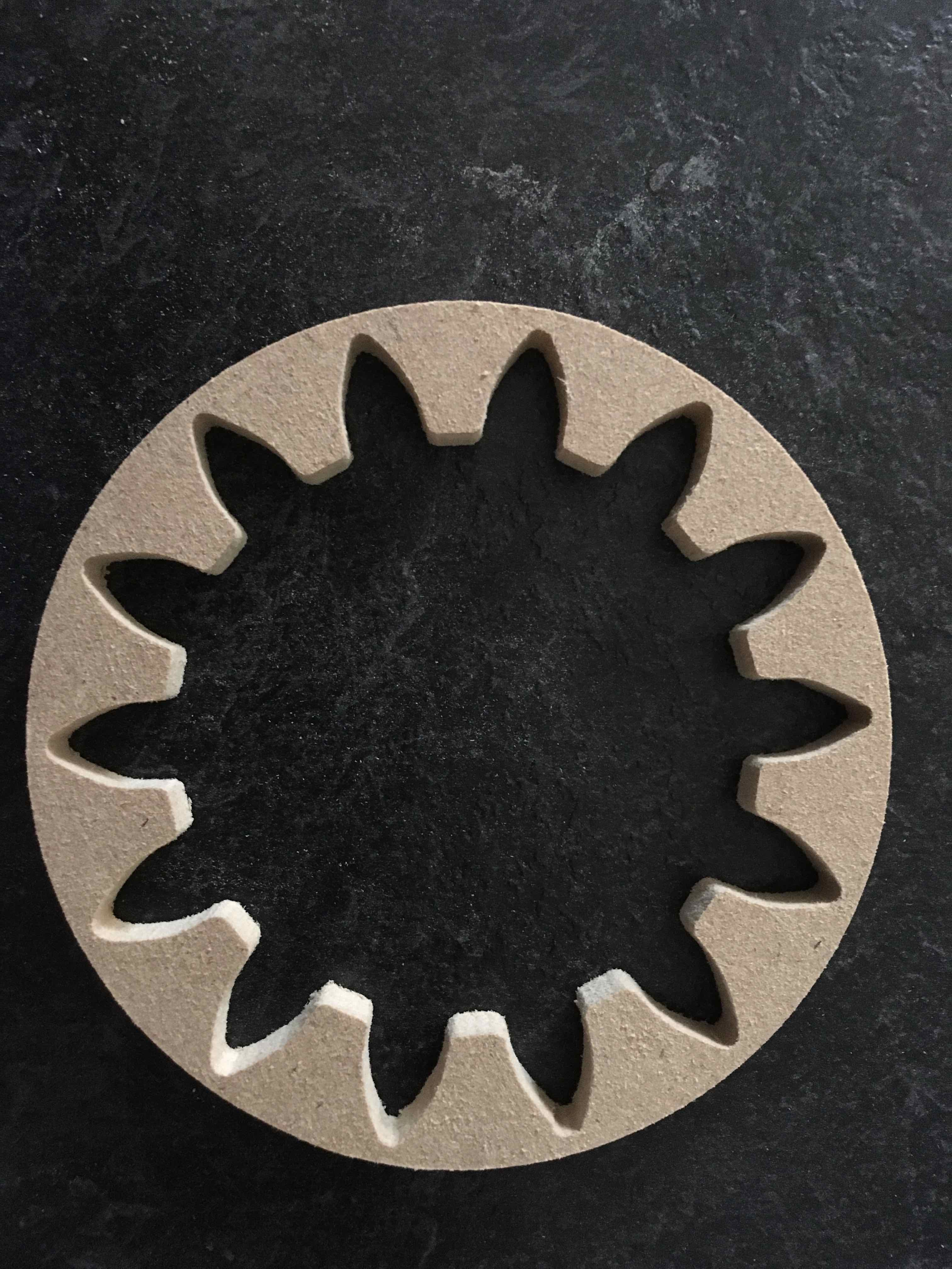

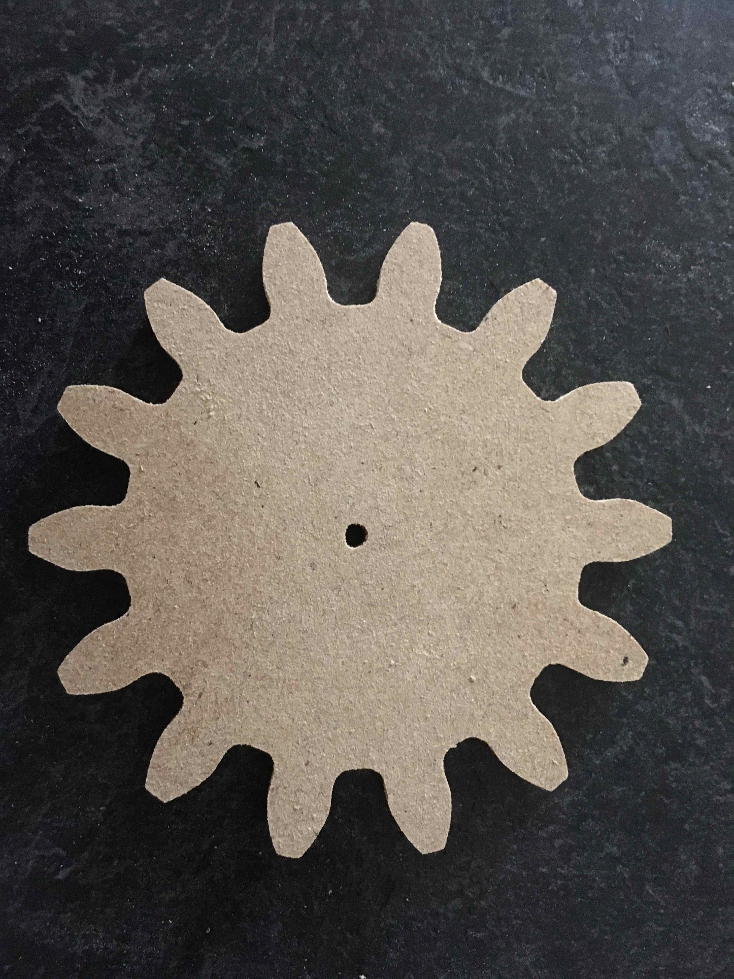

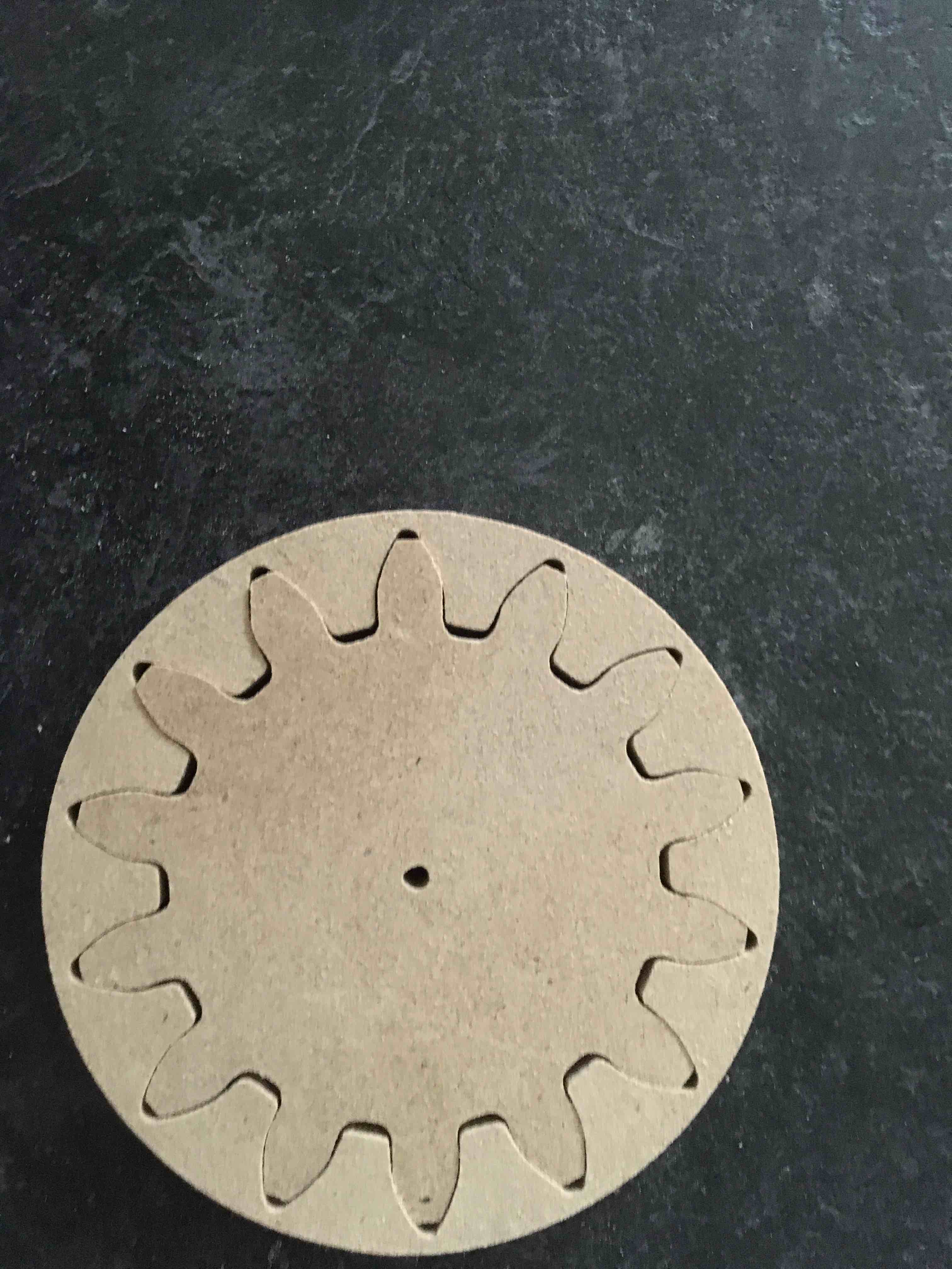

Hmm, to ensure its perfect you could always generate the planetary, and a gear of the same mos/tooth cnt thats 1/2 the thickness. The gear will fit inside the planetary, push it in and bond it.
That gives you a planetary with a shaft in the center and enough room for a planet gear..

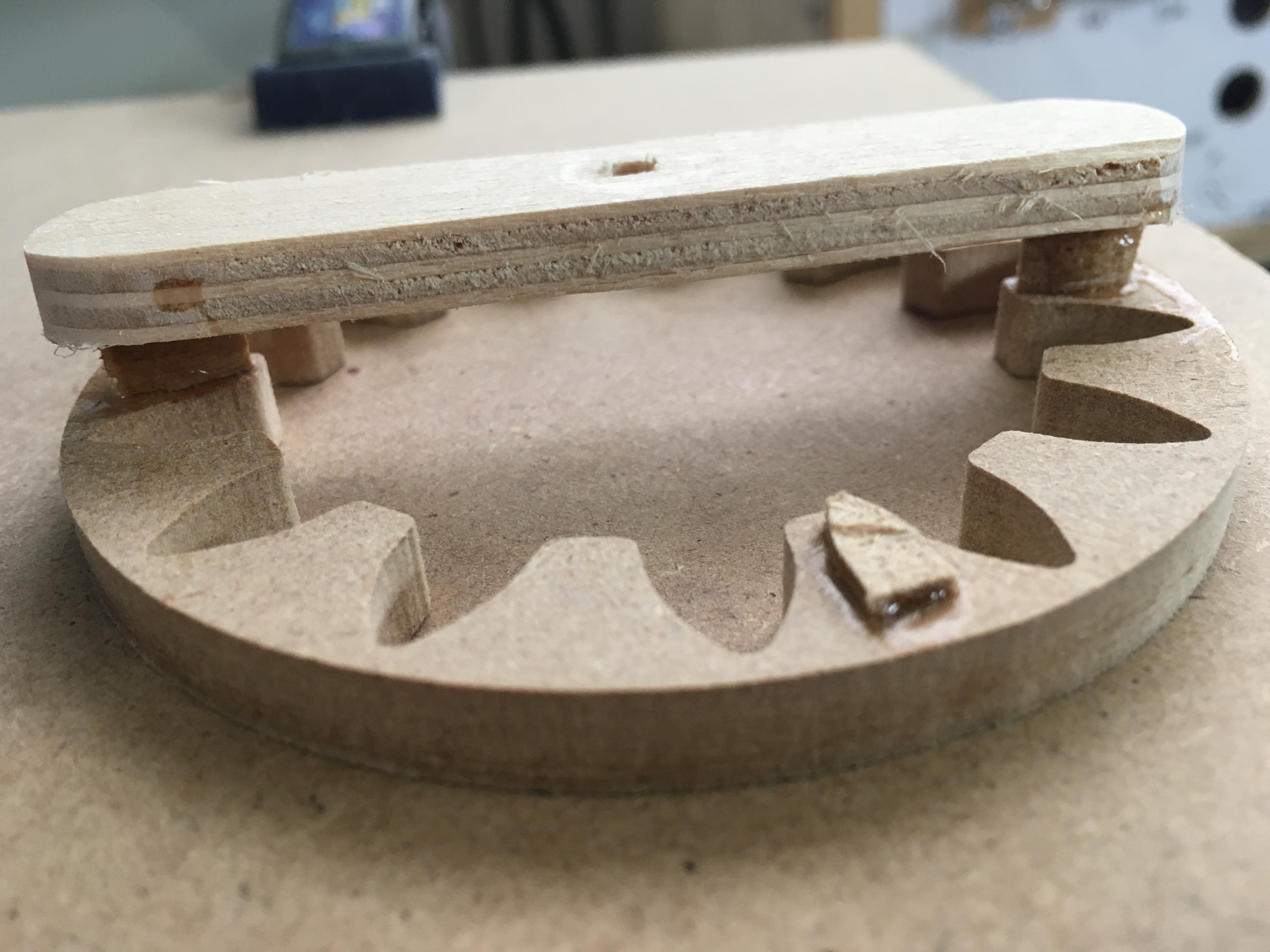

I tried your suggestion and it works beautifully - there is still a couple of steps to get what I want. But I thought I'd post this for now.
I'll post the final when I get it done
Re: Working with planetary
Your suggestion worked perfectly - I have made a stand-off from the planetary and then a bridge on the stand-offs and finally using the centering gear was able to drill the bridge and use an arbor and get a non-wobbling rotation of the planetary.
