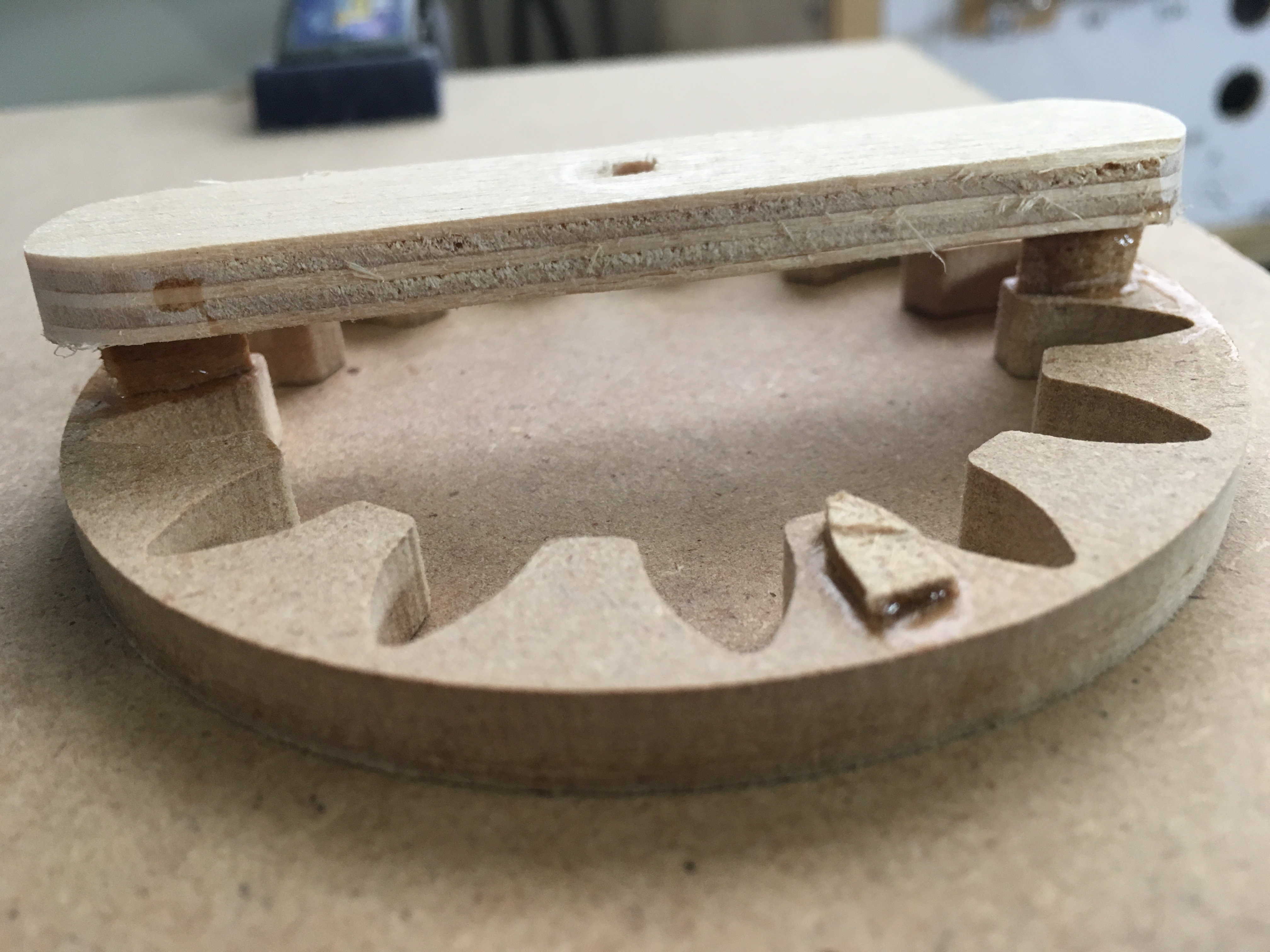

I?m puzzling on how to get a planetary working off a shaft. I would like to have a planetary gear with an arbor and pivot on one plate of a clock and a pinion above it from the other plate.
Essentially I want a ?spider? and ?spacer? to mount the planetary that would make the teeth clear on the inside of the planetary so that a pinion can be clear of the spider.  (This is really hard to describe). Any way can you think of a way to mount the planetary on a spider so that the gear will run true on its shaft.?

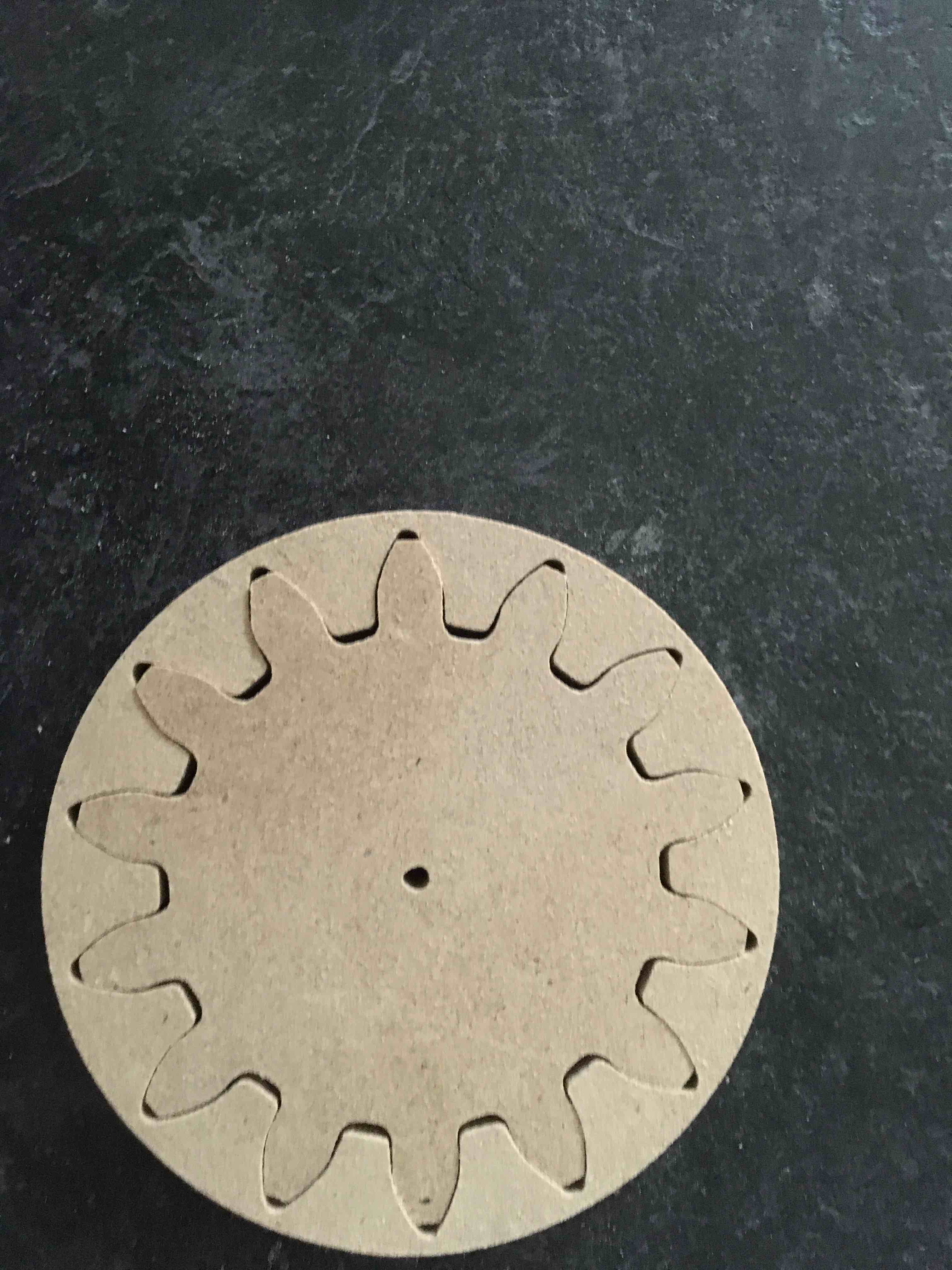

Hmm, to ensure its perfect you could always generate the planetary, and a gear of the same mos/tooth cnt thats 1/2 the thickness. The gear will fit inside the planetary, push it in and bond it.
That gives you a planetary with a shaft in the center and enough room for a planet gear..

That sounds good I?ll try that

I tried your suggestion and it works beautifully - there is still a couple of steps to get what I want. But I thought I'd post this for now.
I'll post the final when I get it done
Re: Working with planetary
Your suggestion worked perfectly - I have made a stand-off from the planetary and then a bridge on the stand-offs and finally using the centering gear was able to drill the bridge and use an arbor and get a non-wobbling rotation of the planetary.
