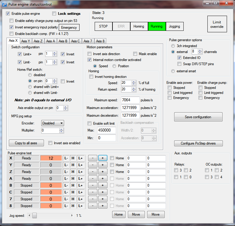

It should work the same even though I don't have a G540 connected.
Can you do anything from the Pokeys Pulse engine page?
Here are my settings might get you started.
XYZ are pretty much all the same.
The values for the motion parameters aren't really set yet since the motors are just on the table behind me.

well I found what was wrong RTFM I was look at versions 1.1 manual, I have 1.2 there is a jumper you use for testing or running a machine or whatever you can have so it's only connected to a usb port what powers it for testing only, if you use it on a machine you move the jumper and power it from a external sources.
your pick helped a lot, thank you now I just need to work out how to set the limits and home switches through the test IO port.

Hi art still can't get the motors to run smooth, question is homing working in auggie, I have the home switches connected to the G540, by looking at the board pinout it looks like it won't work through Test IO.
they are connected and working through the G540 but doing nothing in auggie, I have not tried in the pokeys set up yet.
by looking at the pinout should I just connected them to the Axis switch connector.
This is yet an open question, BobL is alow trying to get a 540 to work and is finding the motors dont sound good, but
he says they dont sound good jogging in pokeys either.. I havent yet seen this and Im not sure if its a G540 thing or not,
but the one time I had very odd motion, it seemed as if I has two threads running in my CPU as a reboot solved all
that issue, it hasnt repeated. So we'll report in the next few days... Is your jogging good in the Pokeys, just noisy in
Auggie, or is it good in jog, bad in motion..or ?
You have to make sure they home in PoKeys, Auggie simply tells Pokesy to home that axis, its the only time , other then MPG
use where motion comes from the Pokeys planner.
>>by looking at the pinout should I just connected them to the Axis switch connector .
Yes, or anywhere, but if you set them as pin0, you just use the input on the axis plug
on the pokeys..
