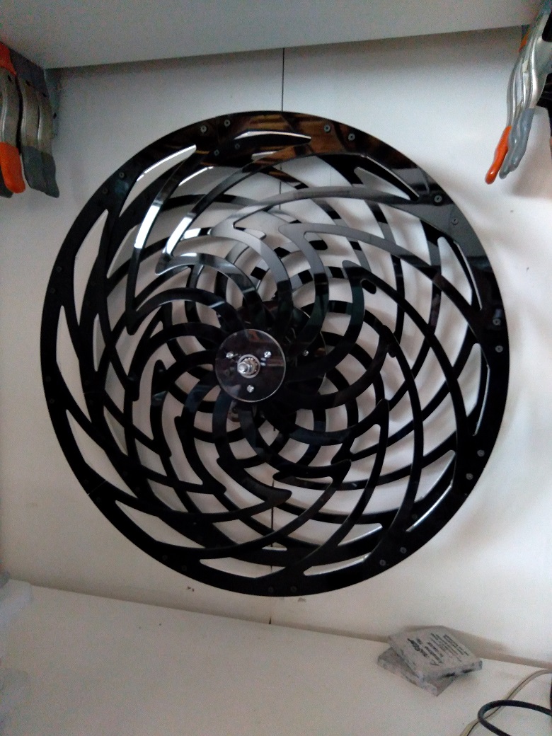

Finally completed my laser-cut acrylic take on 'Zinnia' after letting the plans and parts sit for almost five years...
Did some re-engineering, mostly to get all the parts to fit the 12"x16" limits of my laser. Wheels are 20", which is about as big as I can segment one up without a ton of waste.
Short video of it in operation here: https://www.dropbox.com/s/fgyz2qq84whfc ... 9.mp4?dl=0
