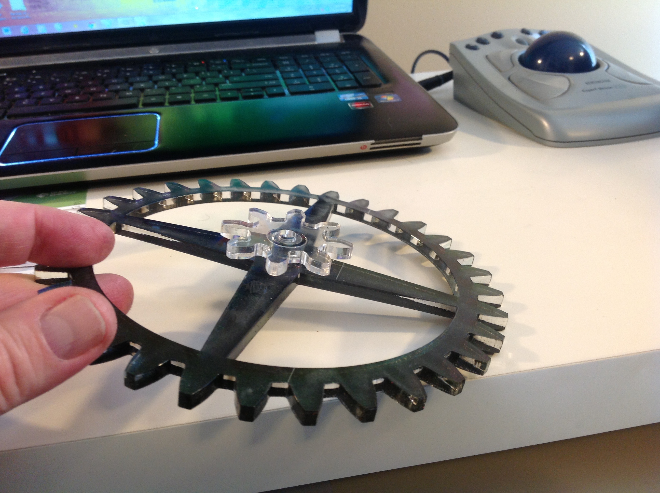

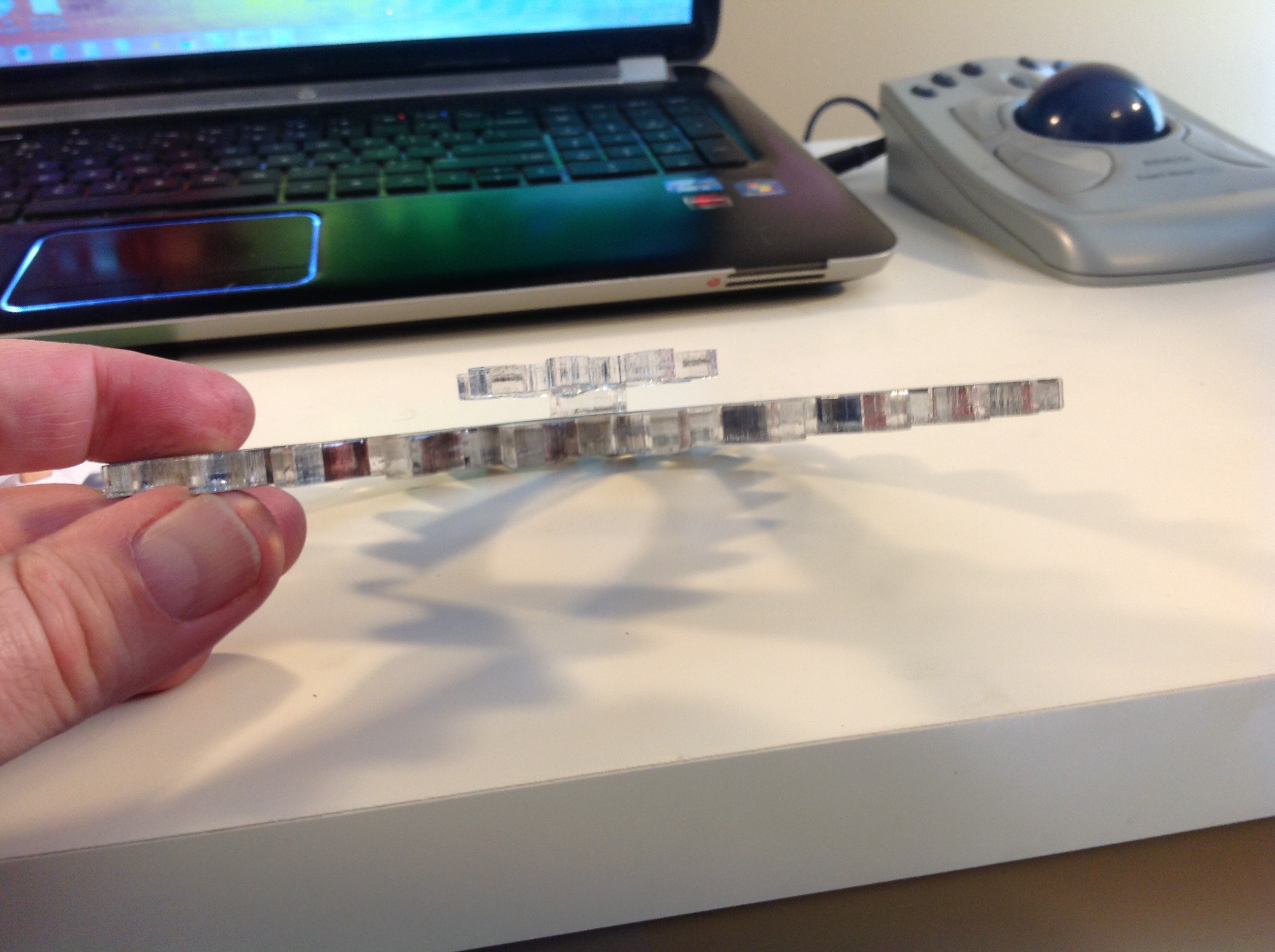

I tried to glue two gears to each other with a spacer between them. See pics. Even though I had a dowel through them when I glued, they did not end up perfectly straight. As a consequence when the gears turn on the shaft they wobble. Has anyone come up with a better method of gluing?
David.
Attaching two gears to each other STRAIGHT!
