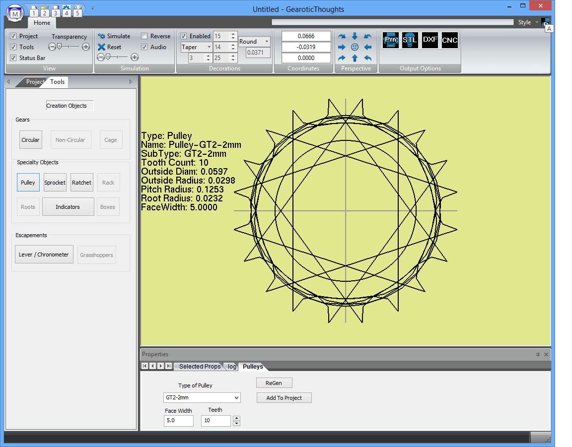

I downloaded the latest version today - I think it's the latest version - there's no version number in the about box.
Just a couple of minor issues...
* When typing in the edit boxes when a gear is selected, hitting the "DEL" key to delete a character prompts with a dialog to delete the gear.
* The first thing I did when I installed GT for the first time was to checkout the new GT2-2mm pulleys.  I didn't quite get what I was expecting - see attachment.  This went away when I switch the Units from inches to mm in the Global settings.
Re: New Version Release 1.11 of GT.
Ill fix up both..
