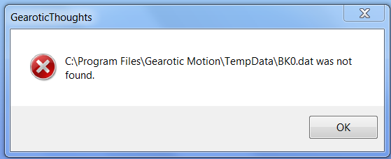

Just loaded the version 4.93.04, I just let install over the previous install. In Gearotic Motion it seems to be working fine but in Gearotic Thoughts I get the following error.

Teepaco:
Thx for the bug report. Im not sure why that one is happening as yet.. when you start GT, the first thing it does is kill all files in the TempData folder. It shouldnt fail
in that way. Does the program fail after that or run normally?

Gearotic Thoughts opens normal, I then click on the tools tab, create circular, from circular gear module when i click add wheel to project or pinion, is when the error appears. I can not place any gear into the project.

Teepaco:
Interesting..sounds as if the installer didnt create the TempData folder. Can you verify you have a folder called TempData in your GM main folder?
If you dont, can you create one and see if the error remains?

I do have the TempData, and there is one file in it call "Dummy.txt" I opened it and the only thing it says is "Holder"

hmm.. That file should be deleted the first time GT is run. This sounds liek a system security issue.. Have you tried running as admin?

Yep same issue here
Had to go back to 4.93.02 to clear the problem "tempdata folder"

For those that are getting the error about the .dat file, can you reinstall to the new default location of
C:\Gearotic Motion.... Im thinking you guys have been running GM so long you have a very old default location.

Re: New Version 4.93.04
Everything is default.
I am thinking it is a 32bit issue because it works fine on my 64 bit win8 OS
the dat file is created and the dummy file is gone after the add gear button selection.
but not on the 32bit win7 system for me
