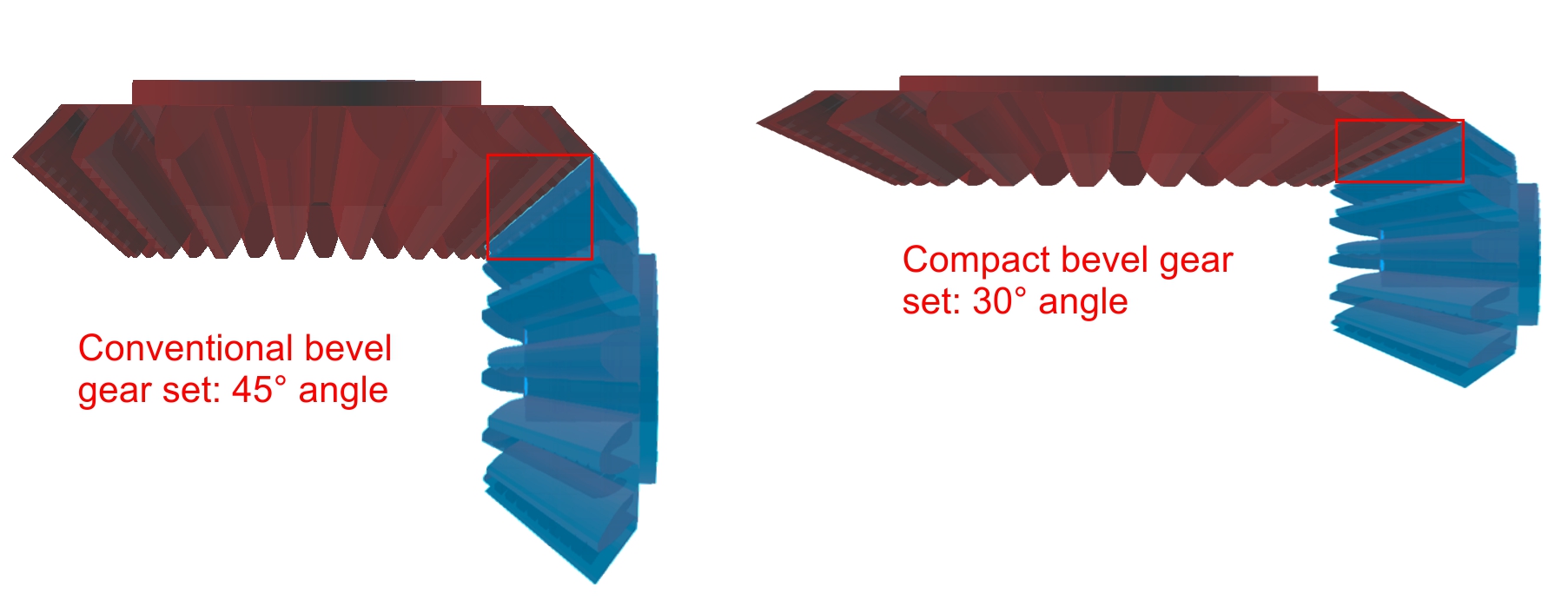

I used the snipping tool to capture some images to show you what I meant. Please see attached.

Re: Straight bevel gears with 90? shaft angle but shallower profile angle
Ahh, I see nbow. BAsically, GM splits the shaft angle in two and assigns each gear that half.. ( ie.. 2 45Deg bevels make a 90 degree shaft angle. ). You want to split in differently, like 30/60 to make 90.
I guess youd hav to set it up for a 60 degree, ( it will give you two 30's) place the wheel, then set it up for a 120 to get 2 60's.. and use one of them..
I dont think GM at the moment will do more than 45 degree on the bevel.. I will look into it though to see if I can make this possible,,
