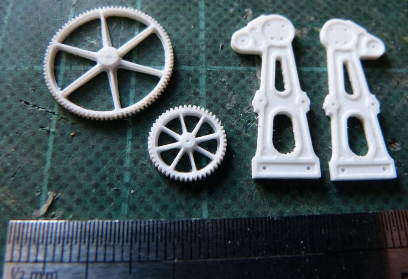

I will be interested to see what you bring out. I've been looking at doing waterline cutting to get round the small "nodding" problems with my KX1 head which become apparent when working with very small detail. I've done a small amount of hand coding for simple shapes but haven't yet (if ever? :) ) got my brain around doing waterline coding for more complex shapes. :) And it's not got gear cutting either. :)
But just to show that I do cut gears, putting Gearotic to its proper use - 0.2MOD cut in styrene with an 0.2mm cutter - for a 4mm:ft scale yard crane :)
Jim.
