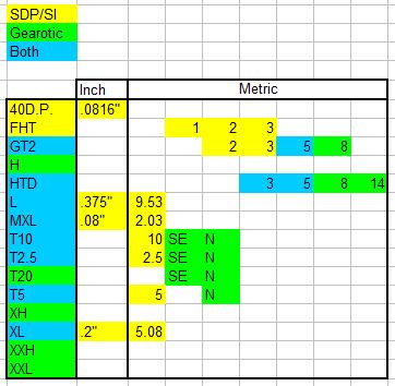

Did a little cross reference spreadsheet to get my head around all the combinations.
Could be some errors but it was a quick look and see.
Re: GT2 Timing Pulleys and Belts
Im not sure what this is showing, is it differences betwen specs?

No just various combinations. Some you support, some you don't. :)

  Thx for the table, Ill keep my eyes open for the proper pulley specs for the other types, Im always
interested in adding such things as I come across the specs..
