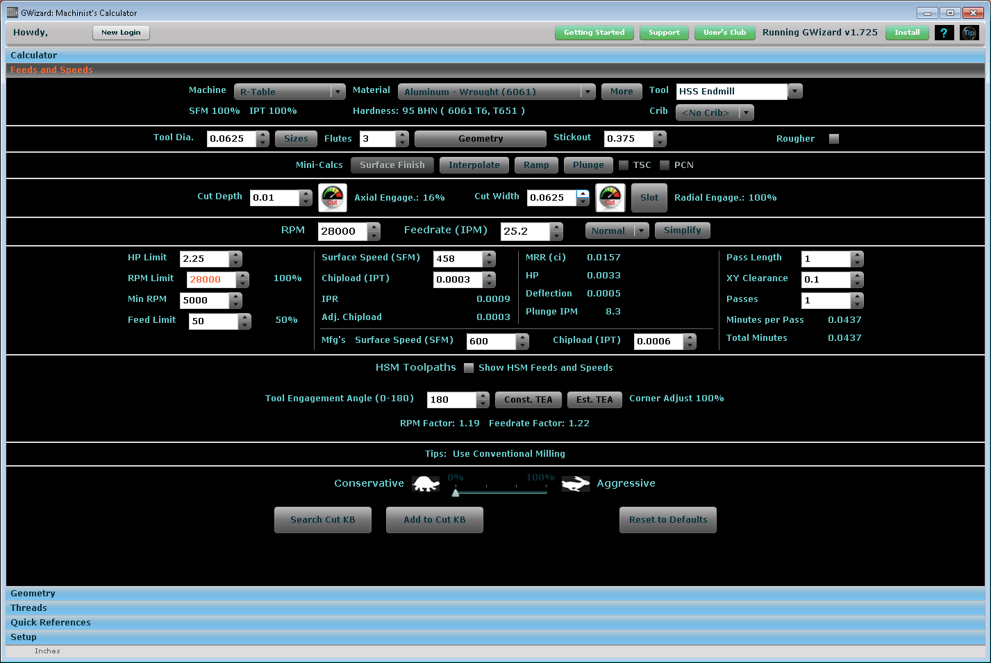

Now I have other issues to work through. Namely the small diameter endmills.
Using GWizard to try to find some feeds / speeds, even just getting down to a 1/16" mill,
with full radial engagement, I either have problems with tool deflection or chip load or speed.
So, I'm hoping those that have gone before can impart some experiential wisdom on what has
worked for you.
Thanks - Matt

Re: 1st use questions about settings and outputs - XL timing pulley
I'm still working on this. Having some conversations with Bob over @ cnccookbook.
I'm planning on running tests on some 5052-H32 AL scrap that I have around.
But ultimately I'm planning on making these out of 6061-T6.
What GWizard is telling me -> see attached screenshot.
I'm hopeful these settings can work.
I'll post some more screenshots as I work things through both of the settings / cad / results.
Thanks for the help and encouragement - Matt
Matt:
Calculated entries are a good place to start, but always consider them suggestions to start with.. Ive found over time that almost everyone
uses in the end "What works". Bobs suggestion to try scrap is a good one. Various bits vary widely in terms of recommended chip loads and
real life usage causes variation even higher. For example a set spindle spped changes htings quite a bit as the calcs are not necessarily linear
so experimenting is the best route..
