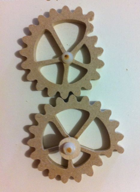

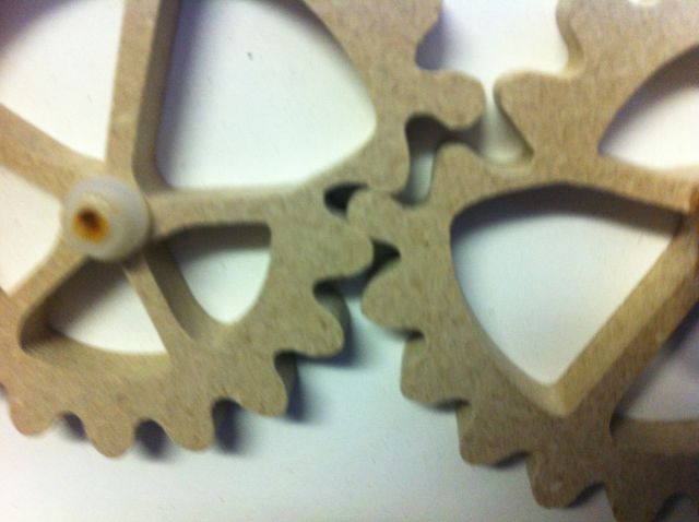

Hi Guys,
Thanks for the tip - by going "gentle" on the parameters and changing spokes a couple of times I got the project to generate and have cut a meshing pair.
Re: Are gears of this shape possible
John;
Did you use GM plating to generate shaft centers? Appears to be more backlash than I expected from image, however they do look kool...Nicely done.
Hi Bob,
I have to admit I didn't use the plating for the backlash. Most everything I do is on 4" by 5" mounting board. I will space the "set" so that its relatively centred on the mounting board and then drill a 1/8" hole for the first shaft. I mount that gear and then with a sharply pointed steel 1/8" punch I find where the second gear will rotate sweetly and then punch the center point and drill it.
I probably should use the plating page and get the backlash correct.
The shaft spacing although empirical was controlled by one tooth on the "straight" portion of the gear.
