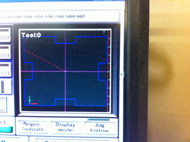

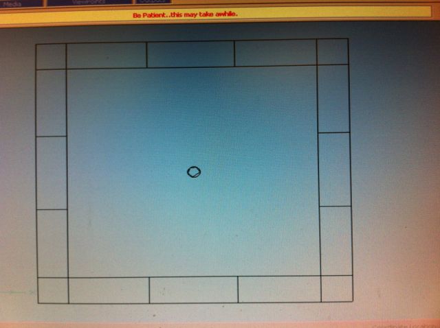

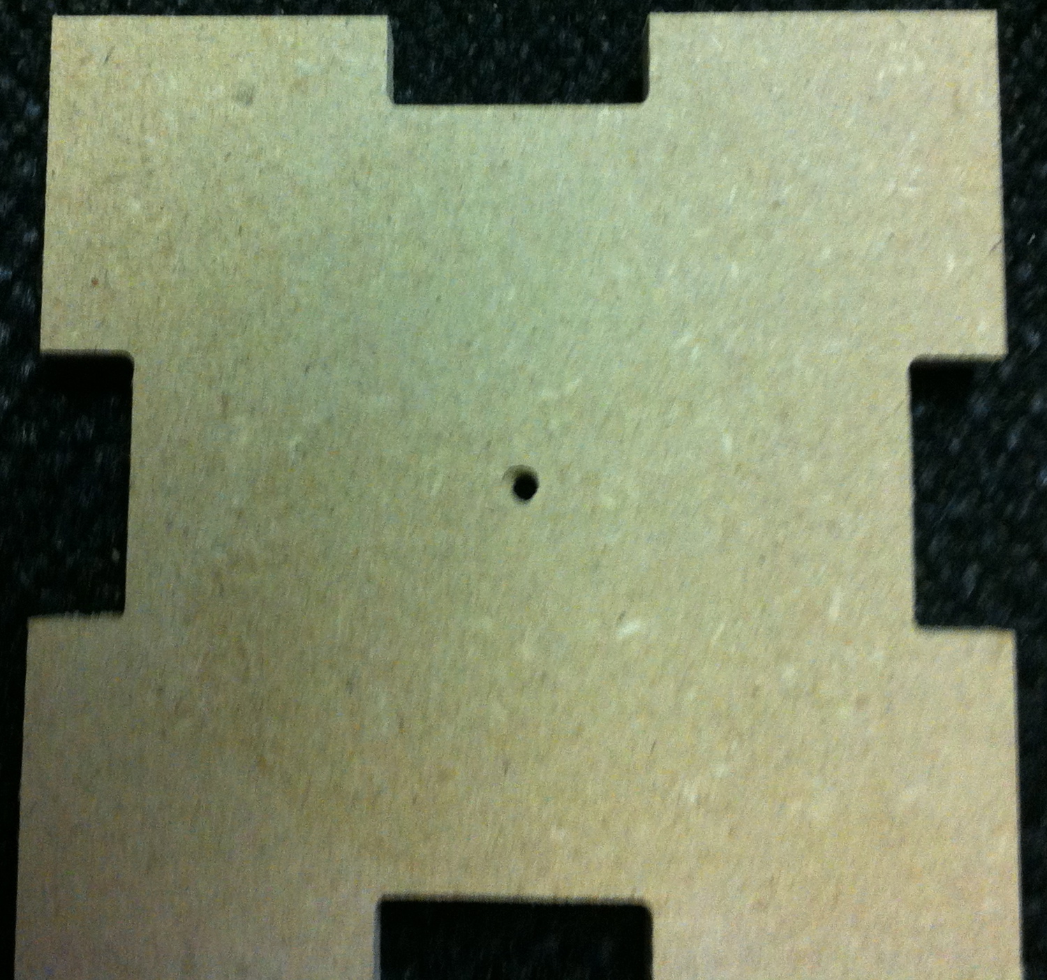

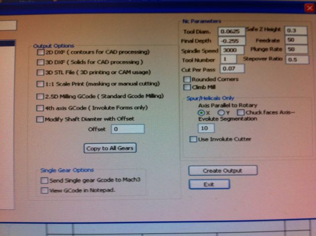

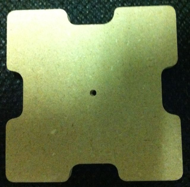

Unfortunately even the outside corners are rounded off.  Here are a set of photos that hopefully will show what's happening better than I can describe.  The bit being used is a 1/16" and the hole in the center of the cut was cut with the same bit as the rest.
As you will see from the screen shots everything looks good until the cut is made.
PS  The tab size won't go under 0.5"  - is that normal?

  I checked here and I get square corners. Your rounded ones can be caused by a couple things..
The most important things to check is firstly, when the gcode loads in mach3, do the corners look square on the
toolpath screen? An outside corner which looks square in the toolpath should be square when cut. Think about the tool
bit as it moves, if it does a 90 degree direction change, the result is a square 90 degre outside corner..
  So if your path looks 90 degrees on the outside corner, then the path is good. SO the thing most likely if thats
the case is your setting of CV in Mach3. CV ( constant Velocity) concatenates linear motions to make things run fast.
It does this by blending two motions together using the acceleration setting for those axis. So if you use very low acceleration,
you get a much rounded corner. Raise your accel and the rounding goes away. ( OR use exact stop mode for a plate cut)..
Let me know if this seems the case, or send me a photo of the toolpath, if it doesnt have square corners then perhaps I
have a bugt Im not seeing..)

Problem solved.  The corners are really sharp ie to the limit of the bit.  I never even thought that the acceleration in Mach3 might be causing this.
