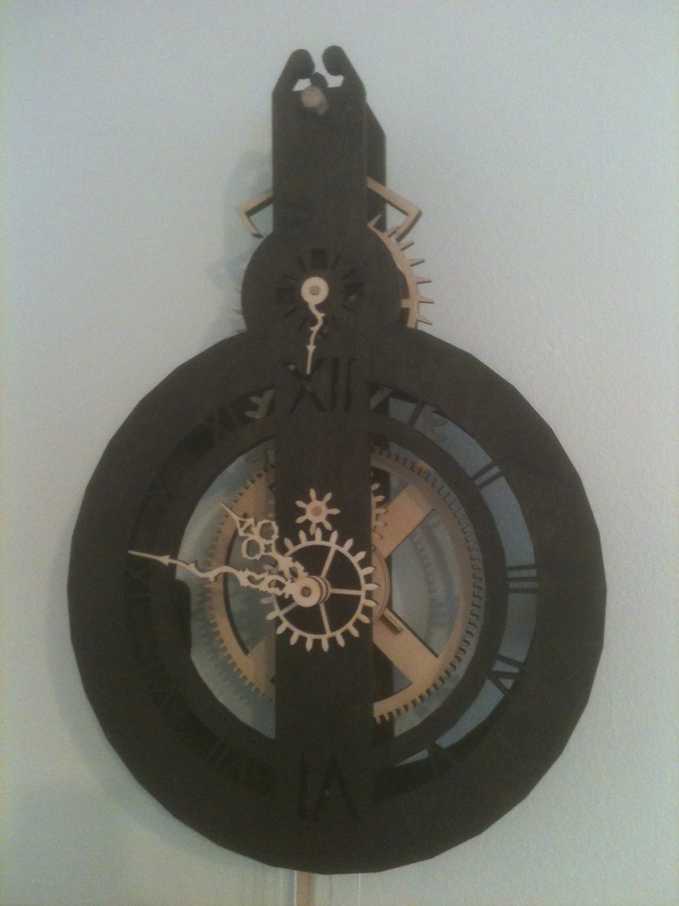

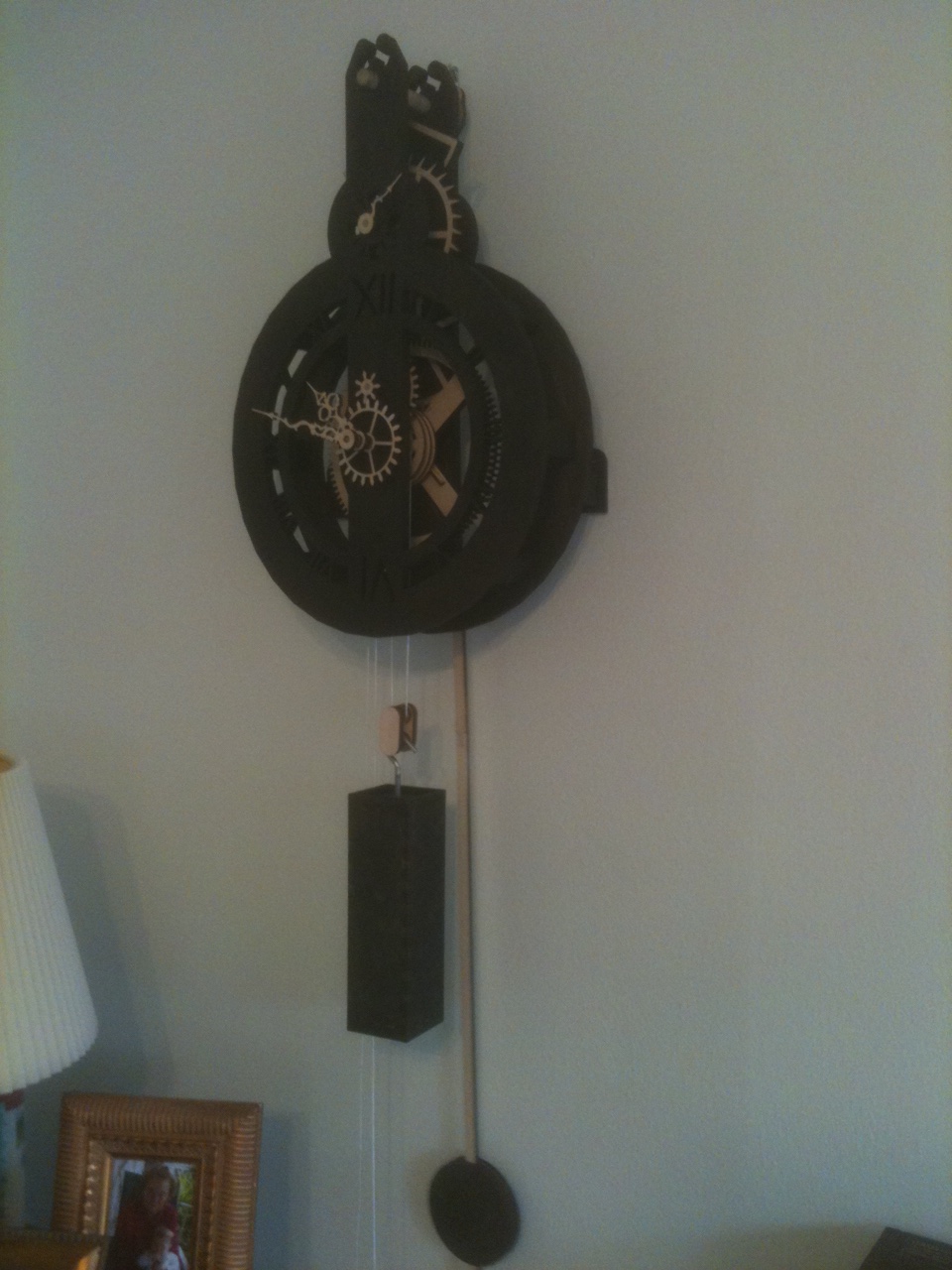

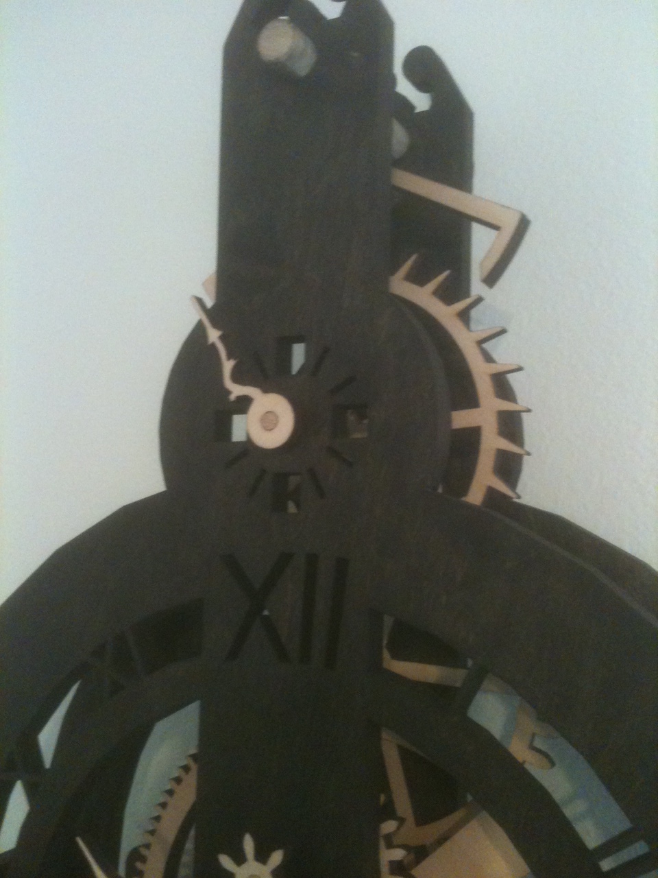

Here's my latest. It has a two second pendulum that ticks once per second. A hand is attached to the escape wheel to indicate the seconds. It has a running time of about 18 hours.
For my next clock, I will try to get the running time to be about 30 hours and to include a moon dial.
The lunar cycle occurs over a period of 29.5 days. The "Moon Wheel" will have two moons at opposite ends of the wheel, and will revolve once every 59 days! The easiest way to accomplish this (I believe) would be to have a "Moon Wheel" with 59*2 = 118 teeth and a pinion attached to the hour hand with only one leaf. This one leaf pinion would advance the moon wheel two teeth per day. Since there is no torque on the moon wheel, I don't need to worry about any slipping. Although it can be done with one pinion and one wheel, I will probably implement it as a train of wheels and pinions.
Any thoughts?

Thanks for the complement. It is indeed laser cut.
To clarify, I want to create the typical Moon Dial as seen on many grandfather clocks.
I need a wheel which will rotate once every 59 days. 59 days is the length of two lunar cycles. On this wheel, I will place two pictures of the moon at opposite ends of the wheel. Only one picture of the moon will be visible at a time. As it rotates, the moon will slowly be covered up by a circle making it a crescent shape. Once the Moon is fully covered up, the second Moon will start the cycle.
Since there is such a huge gear ratio involved, I will attach a gear with only one tooth to the hour hand. This gear will rotate twice a day moving the "Moon Wheel" which has 59 X 2 teeth. Since it advances two teeth per day, it will take 59 days to rotate.
