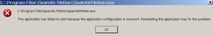

I now have a new problem, I get an error message.

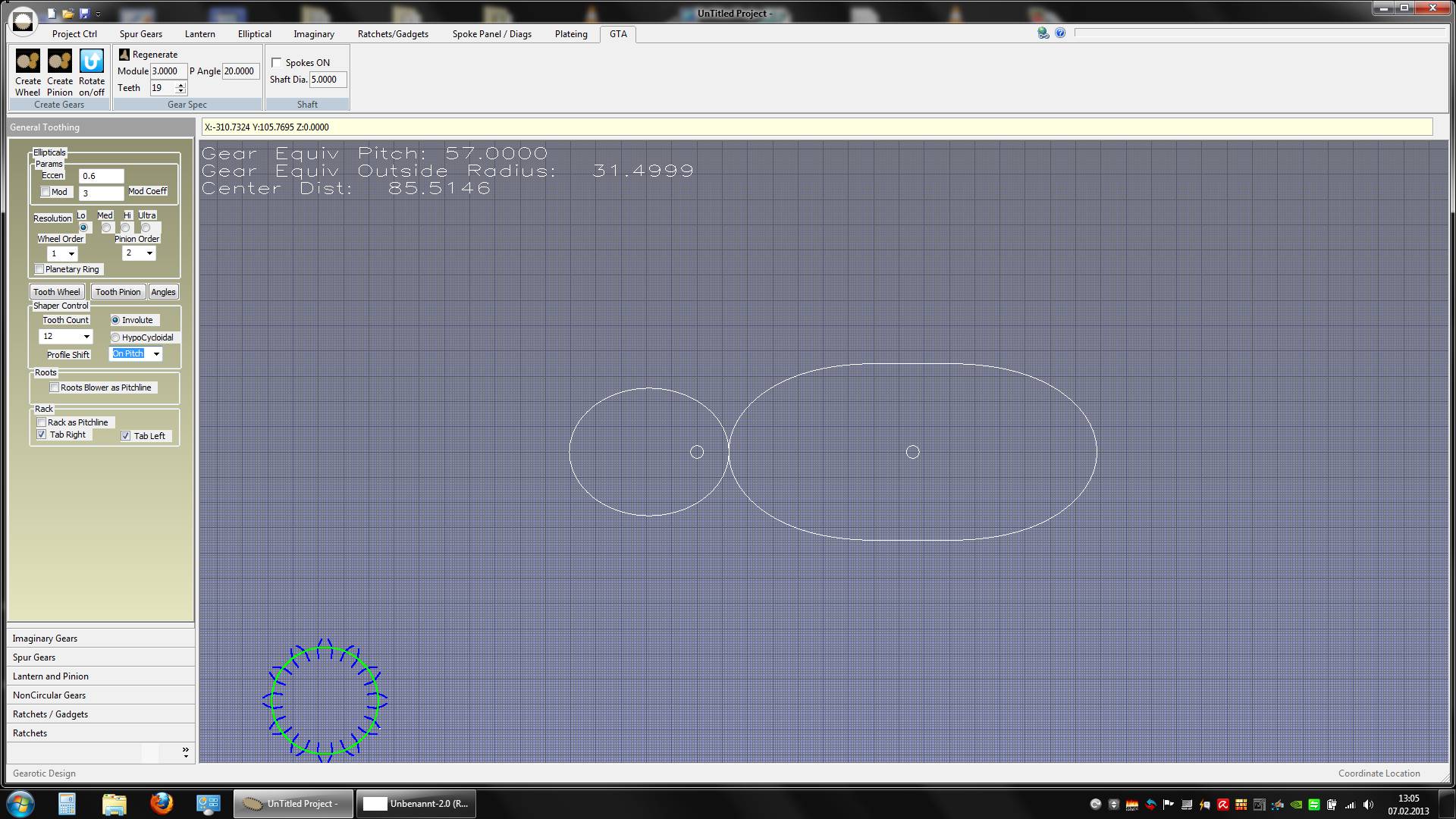

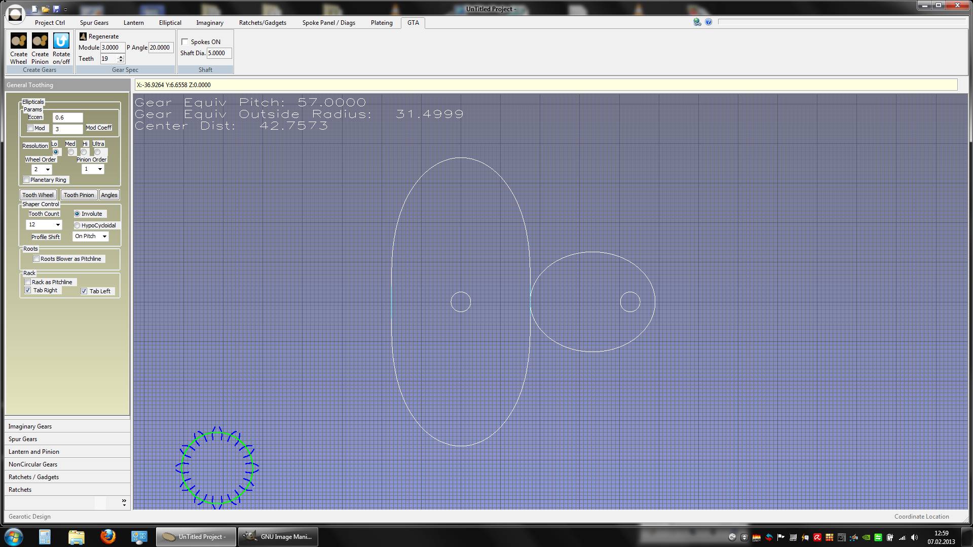

Hi,
i dont know,is this a bug? Look at the Wheel and Pinion corners in the drop down menu and at the millimeter paper. Is the Pitch Diameter correct?

Re: Version 4.82 online
Hi Felix:
Does look like a bug. Ill check it out.
