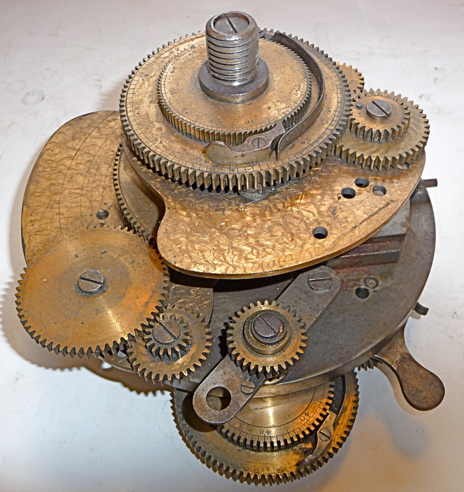

Re: Fillet radius on spur gears
While you're at it...
The gears of old "Geometric Chucks" from 200 years ago have semicircular tooth bottoms. It gives them a unique and characteristic look. Maybe you could add a toggle for that....

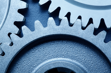

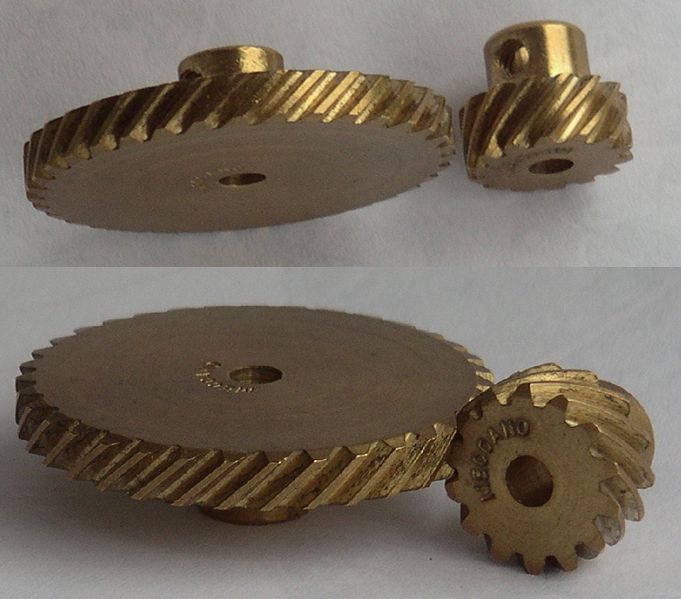

I give up. GTA page? I found this page which happens to have round bottom gear teeth...
http://www.gtapartners.net/?page_id=14
But no sign of a rack.....
They cropped the image, but it looks like these three gears on in mesh....oops.
Another amusing image is on the wikipedia "gear" page. The helical gears, show in parallel and crossed configuration....oops.
Thanks Art!
Thanks Art!
Geometric chucks, which I'd never heard of before, are really cool. Thanks, Justin.
I found a simulator here but it's too late to download and try it.
Mooselake, put this word into the Google image search: guilloche
Thanks, Justin. I've only heard of Rose Engines, never a lathe add-on, and been unable to find a software rose engine simulator since the real thing is way beyond my hobby budget. Hope to try the Geometric Engine simulator tonight.JustinO wrote:Mooselake, put this word into the Google image search: guilloche
