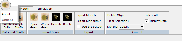

Hessel:
Sorry, my bad, its the icon in the top left corner, it opens the system menu.

I still don't see it.

Hessel
Just to be certain, the current version of Ticker is 1.13B.
BillM
BillM
Re: A gravity escapement
Hessel:
Sorry, yes, that version is very old. If you have upgraded, the problem is that you are running an old "ticker.exe" in your main folder.
Update your shortcut to point to the one in the /TickerKinetics/ folder of Gearotic.

Found the solution:
For some unclear reason, I had 2 installations on my PC, on C:\ in the root and on E:\ in Program Files X86.
The shortcut was directing me to the wrong install.
Sorry for the unnecessary workload..., keeping us away from milling, turning and printing ...
Hessel
