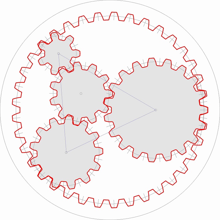

Given the ring gear and four spur gears I described above, I really "only" need the angles that describe the triangle connecting the planets. Only two unknowns...simple, right? Oh if only...
Consider the problem of determining the center/radius of a circle (ring) that encloses, and is tangent to, three arbitrary circles (planets). As far as I've been able to determine, such a circle is unique (if one exists) but I'm not finding a closed-form algebraic equation describing it. It looks like a question of finding the intersection of the three hyperbolas that run equidistant from each pair of planets. I could probably cobble up a search optimization program (call it 'FindRing'), but it would be ugly and have unknown run-time.
I would then have to run FindRing over the set of planet positions constrained by the size of the sun gear until I got a solution that has the correct radius for the ring gear. (I'm taking a leap of faith that I'd then have a configuration that would mesh and rotate, but at least I've seen it work for this set of gear sizes.) This is the kind of thing that gives "brute force" a bad name.
I'm not sure Gearotic will help, since the sun gear doesn't have a fixed shaft position, but if someone can prove otherwise, all the better. It sounds like maybe a job for Mathematica, but I really don't have the level of spare time required to learn that from scratch.

Just in case anyone believes I'm crazy, this is the closest I've been able to render it in CorelDraw:

The secret to your question is the equivalent circles created by offset gears.
TO get proper measurements, you need a proper reference point at center of the
sun. Considering any two gears, one can create a rolling replacement gear on
the central axis. The pitch radius of that gears will be the measurements
required to calculate either of the two gears numbers.

The thing that's kicking my butt at the moment is that I can (1) generate the gears (Gearotic/Gearify/GearGenerator/whatever), (2) import them into CorelDraw and arrange them so they mesh nicely, (3) cut them on the laser, and (4) arrange the physical gears so they mesh. And the drawing doesn't quite match the thing lying on my desk. The planet spacings along the ring on the physical set are like a third of a tooth off, so of course the planet-to-planet distances are different. I could measure them and try to cut a carrier, but I have no confidence that will work without adding a lot of slop to the gear cuts...the "brute force and massive ignorance" approach. I've tried working backwards from physical to drawing, and I can see tooth interference on the drawing when it's arranged the way it actually "works".
My gut says this arrangement is unique (given that the tooth counts are all prime), but I'm starting to wonder.

I suspect that certain integer multiplication rules for tooth counts will apply.
By equivalent circles I just mean that if you consider only the motion of the shaft of a particular gear, and referance that to center,
thats an equivalent gear for that motion in a different reference, the pitch radius of that gear is likely important to the calculation.

After staring at (and tweaking) the drawing for a couple of hours, I noticed a couple of things. I'm calling the gears R37, P19, P13, P7, and S11, if that makes sense. It also helped that I made each gear's effective radius equal to 1/10 of its tooth count. (E.g. S11 is 2.2" in diameter.)
Within the limits of how precisely I can manipulate the drawing without knowing actual coordinates, it looks like the distance between P19 and P13 is the same as the distance between P13 and and P7, and that distance is 3.9", equal to the sum of the three radii: 7 + 13 + 19. The third leg of that triangle, between P7 and P19, is 4.4"...44 = 7 + 11 + 19. I may try cutting a planet carrier tomorrow with those dimensions and see if it's really as close as it looks on the screen.
Then again, 44 is also the sum of 7 and 37, and the caliber of Dirty Harry's gun...I'm really not sure how much numerology can, or should, apply to gear design. All of these might just be coincidences, me trying to read patterns into imprecise data, who knows. All things considered, learning Mathematica might be less harmful to my sanity. :P

It sounds to me like you have a good grasp on it. I didn't crunch numbers or anything, but
your logic seems sound. I find when I begin to explore such things for a module I rediscover

Just for the record, I didn't use Gearotic to draw the gears, I used Mathias Wandel's GearGenerator3. I redid the gears this morning and re-imported them into CorelDraw, made up a planetary carrier, and cut everything again in 1/4" MDF. Everything lines up, and it meshes and turns...stupidly tight, since I only have the laser's 0.005" kerf for slop. So the numbers I was seeing are correct: in "half-tooth units", D(P19,P13) = D(P13,P7) = 39, D(P19,P7) = 44. Turns out D(R37,S11) = 13, which, except for being prime, has no relation to the others that I can see. FWIW, I've attached a 1:1 scale vector PDF of the drawing (Corel imports DXF fine, but doesn't export it worth a damn), but with the spacings known, you can probably just recreate it faster using Gearotic/Vexx.
I'd love to know the math behind arbitrary-sized planetaries, but I guess that will have to wait.
