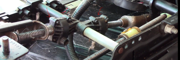

The 8-way power seats in my truck have 2 worm gear sets that provide height adjustment (at the front and back, thus 2 sets). The worms are I think a brass, with a square bore. The wheels are made of some kind of plastic, housed in a small gear case that provides the thrust force control. These plastic gears are prone to failure.
There is somebody out there that makes the gears for this vehicle, and I will purchase a set, but I wanted to see if I could get thru the exercise of figuring out how to do it, to help prepare me for other projects.
The picture of the upside down 8-way seat mechanism, arrows pointing to the up/down height adjustment worm gear cases:

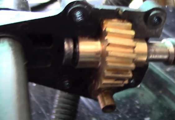

A case split open, with a 3rd party worm/wheel replacement solution made from brass:

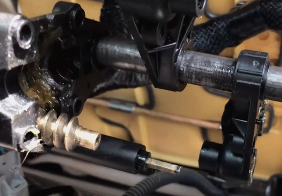

A view of a gear case with it?s worm, showing it?s square bore. The square drive shaft is for the other split gear case:

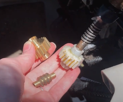

A view of the plastic wheel, and a 3rd party replacement worm/wheel set:

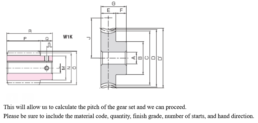

I also heard from KHK, and they sent me the following (see pic below), so we can see if they have something I can use
