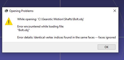

Hi the download worked and am checking out ticker. My results for the bolt output in obj never seem to produce a visible object inside Cura. When I checked the stl/obj box I was able to produce a usable stl that cura recognized. When I returned today I can not generate a usable obj or stl.
By usable I mean that meshalb sees the file as only 1 vertice and zero faces.

Thx. Does this happen even if you produce a simple shaft segment in advanced shafting and then create it?
Better question, does the screen show proper models but when exported simply refuse to open up in Cura?
Can you send me an obj file of one? They are text files in reality and may show me whats up.

Meshlab error
Bolt file
Bolt file

I'm having a similar problem. The STL files, just simple bolts, 4" long, 1x8NC thread, cannot be read by any program I've tried (Ideamaker slicer, Aspire, Win10 3d viewer).

Thx ..
Something seems to have busted the release version.. I will update as soon as I figure out what happened.
Sorry for the bad downloads.

I'm still searchi9gn for this problem. Unfortunately if I redownload , install and run, all models
seem fine. The file above I tested and can see all the face indices are 1, which is just not right
but Im still unsure as to how that can happen. It may have been an early upload wasnt replaced,
I have reupped the program just to be sure.
If you get a chance, let me know if a fresh install fixes the trouble.

Different results this time there are verticies on the OBJs but no faces. The STL still have 1 or 2 vertices with no faces.
I have attached the results; it if helps.

The MSI installed on my W10 notebook, ticker starts and seems to run fine. However I couldn't figure out how to change numbers except with the slider which isn't especially accurate (nothing typed in the box does anything with and without a ctl-A). While it appeared to create and save an (I'm assuming) obj file I couldn't figure out where it went or what the filename would be for a search. I'm trying to tune my newly 32 bit controllered Ender 3 Pro and thought a hollowed out 1-8 shaft and nut would be a good test, particularly since I could try to screw it into my wood lathe chuck.
I'm a little confused on setting overall and threaded length, but expect that will become clear in the video.
Edit: I was using shafts, not bolts which I see in the video have a much different looking screen, and since real programmers don't use manuals /ducks/ I opened ticker and started futzing around. Watching the video now...
Found the obj file in Shafts, operator error trying to open instead of import in Prusa Slicer. Print is now in progress.
