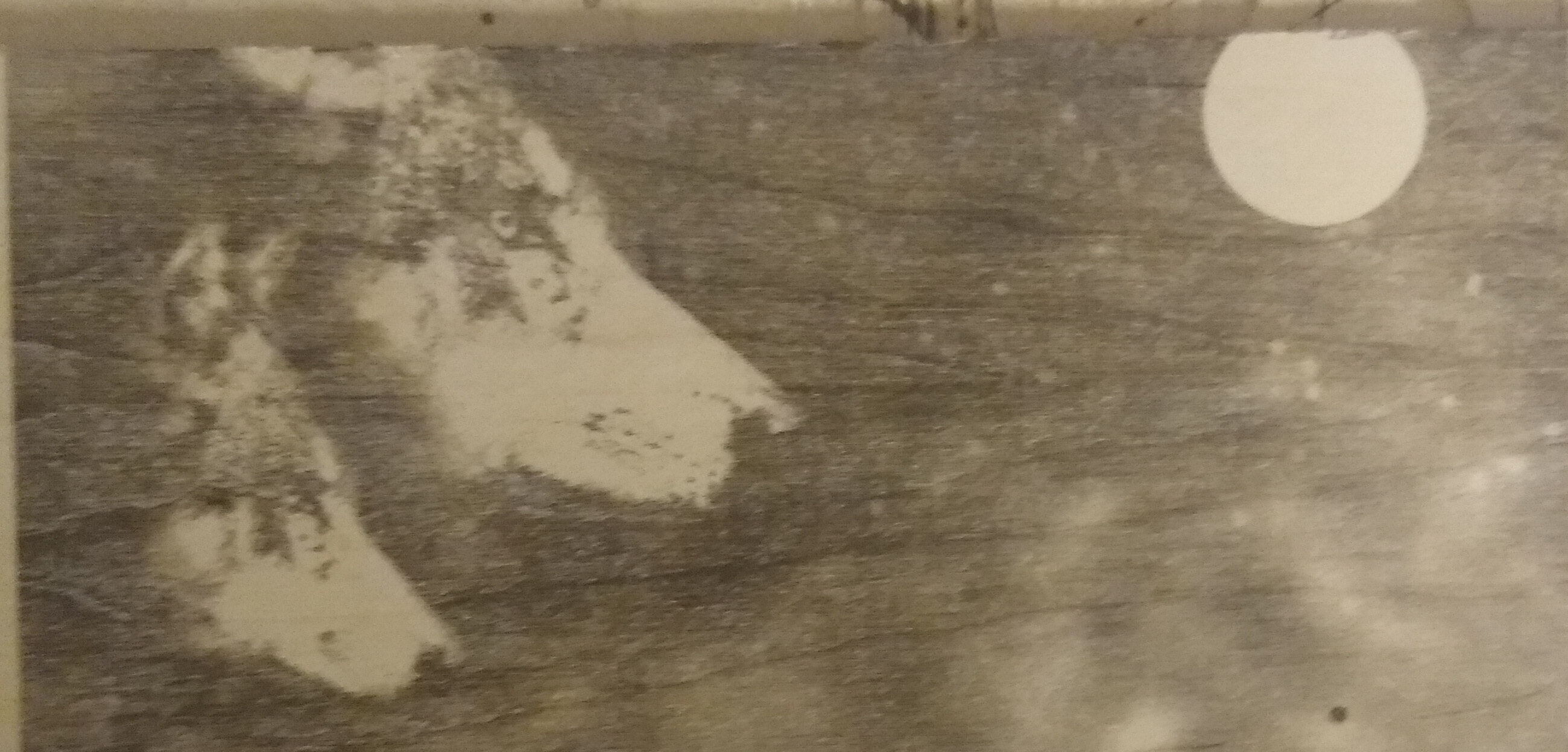

Thought I'd show some progress. I need to do some tuning work for the burn on the low side but not bad for a 3rd try after some testing / tweaking. I used some maple veneer plywood I had laying around.
Re: POKEYS FAILS TO COMMUNICATE WITH -10, DISCONNECTING..TRY AGAIN
Hi Scott:
