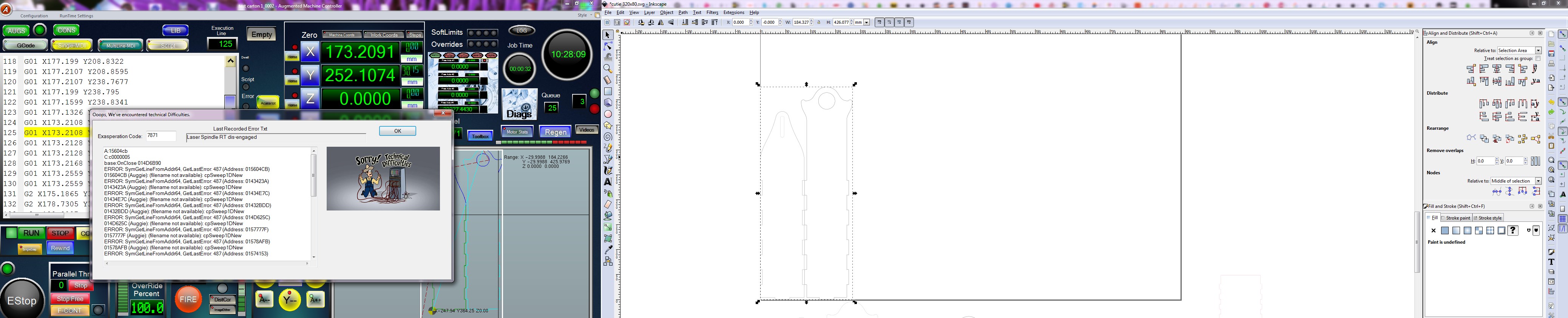

BobbyW
Re: Auggie error 7871
Post by BobbyW »
I forgot to post the screnshot
Bobby

BobbyW
Post by BobbyW »
ArtF wrote: Hi Bobby:
Have you been playing with the physics simulator simulations lately?
No i didn't but... i found the issue .
Not realy because i was need that code , was easy to move the vector just 1mm away from origin and problem was solved .
But... the problem was in different place . Soon i move the vector before to create the code i saw a line , little bit more black than other
lines and looking close i figure out was two lines in same location just a litle difference between that points if you look in code
after +line 125.
Seems Auggie don't want to run that for some reason.
I posted that error thinking is useful for you to know what happen in Auggie .
Normaly is impossible to test all possibility to get a error code .
Bobby
