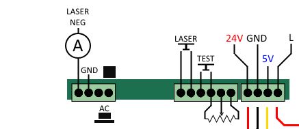

need help how to connect pokeys 57cnc with k40 power supply? I mean wires. i am using auggie version 3.7 which communicates with pokeys 57cnc.

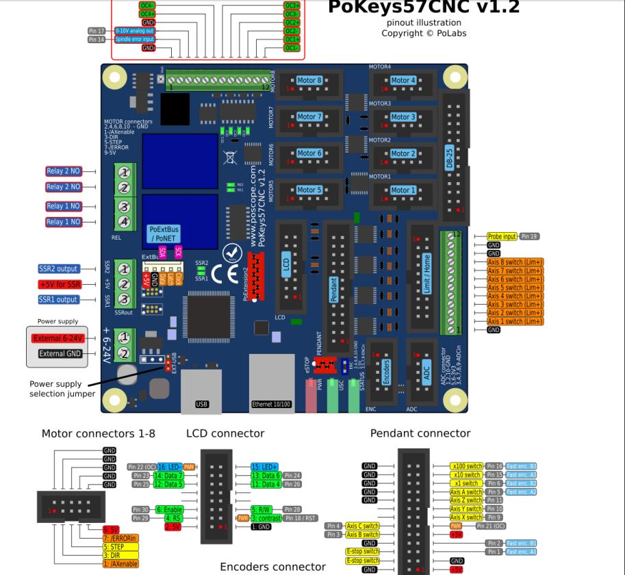

sorry i was busy. if i understood correctly i need to pokeys57cnc connect laser trigger to step pulse motor 8. and PWM4 to pin18 pokeys57. i have another question whether step laser ignition should be inverted or not. if need be if the software or do I need hardware-inverted signal.

  You dont need to use step motor 8 for connection to anything, the stepmotor 8 display shows motion
during shooting only because that channel is used as the pwm control word internally for the pwm channel
real time control you use to trigger the laser. You can use any of the 4 pwm channels to do the actual control.

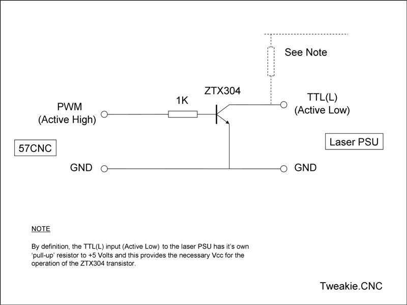

It is important to keep the Pulse Repetition Frequency below 20kHz (to protect the laser switching electronics) but I have had no problems connecting the 57CNC?s 5 Volt PWM signal directly to the TTL(L) input of my CO2 laser, although I did hardware invert the signal as described here; http://gearotic.com/ESW/FavIcons/http:/ ... 131#p13131

Tweakie. I can't tell from the picture which transistor you used
tweakie
Posts: 184
Re: pokeys 57cnc wiring
Post by tweakie »
Almost any NPN switching transistor would do. I used a ZTX304 because that is what I had to hand.

base? emitter? collector = gnd, resistor 1k ohm, base 1k om resistor -PWM from 57cnc, emiter to L fire laser? did i get it right?

I appreciate that the operation of my signal inverter circuit is perhaps not easily understood so I have attached a diagram.
(It was done this way so that it could be used in circuit with the ribbon cable and not require an additional power source).
