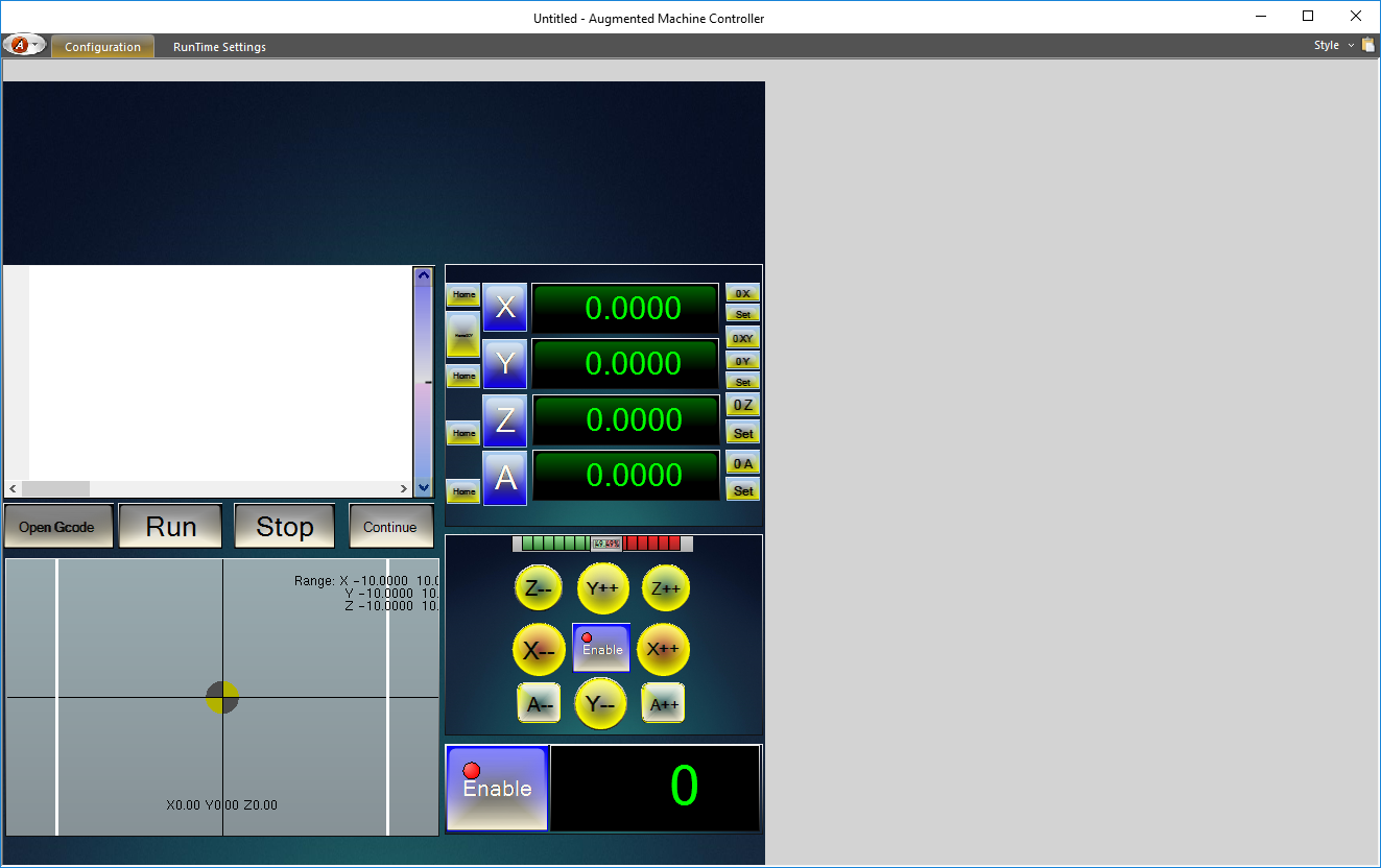

Hello,
Thanks for the info/help.
I started creating the screen that I wanted (Basically a super simple 4 axis coordinate display/control + Jog + spindle speed control + GCode executer).
See attached screen shot.
Now, I need to make the button do things: ie: script the thing! Here is a list of what I need to achieve:
1: have X/Y/Z/A number pannels display the actual coordinates for the 4 axis coordinates
2: when I click on Home X/Y/Z/A, have the CNC go to home for the given axis
2.1: when I click on the HomeXY, have the CNC go to home for these 2 axis simultaneously
3: when I click on 0X/Y/Z/A change the current coordinate so that this is the 0
4: when I click on SetX/Y/Z/A change the current coordinate so that this is the coordinate written by the user in the DRO panel
5: when I click on goto, go to the coordinate specified in the DRO panels
6: make X/Y/Z/A jog button move the machine
7: when I click on the jog enable/disable button, enable/disable the jog buttons
8: make the spindle speed DRO display the programmed spindle speed
9: when I click on Enable on the Spindle, start the spindle at the speed entered in the spindle DRO panel
10: make the load g code button open a GCode file and load it in the GCode panel
11: make the G code run, stop and continue button work

Re: Trying to setup Auggie on cnc machine
Cyrille:
Looks like a good start.
1: have X/Y/Z/A number panels display the actual coordinates for the 4 axis coordinates
>> If you load the 4axis panel as a panel in editing, and then right click one of the DRO's for
its properties, you'll see the first one has a variable name of Axis0CurPos, the next (y) has
a variable name of Axis1CurPos. These are internal variable matches so the system knows what to
put. You can use AxisnIndex or AxisnMaxVel or AxisnHomed and many others. The best way to find them
is to load a panel that has a control you wish to emulate and copy its variable name.
Each control in a panel or on the screen may also have a script attached. I do not recommend that usage,
it was an early invention and I later decided variable names are the easiest way to make a screen.
If the system doesnt have an internal match for the variable name you enter, it will look in the
general libraries to see if one exists. So generally give all DRO's Buttons etc.. a variable name,
you can then script them in many ways. A single variable name may be used on many items.
For example, you can have a button , DRO and LED all named Axis0CurPos. The DRO will show
in units the position, the LED will light up if not zero position, and the button will set current position
to a zero or 1 when pressed, depending on its toggle setting. (Thats silly of course, but its
important to understand any control may share a variable.
A variable name also can be scripted by simply adding a script of its name
in the general libraries. If a button named CurPos as a variable name is pressed, it will change
its value as a variable, and then call any script of its name. You can use GlobalSet( "MyVar" , 1) to set
a button from a script for example. Be carefull of looping where a button calls a script that sets that
button which then calls that script..ect... :)
So if the system knows the variable, it will handle it, if not, its expected you will from
a script.
All the rest of the questions have the same answer, simply copy the original screens variable names.
a script.

On other thing worth mentioning. It may be easier for you to simply modify my screens.
You can simply delete the items you dont need, and change the purpose of others. For
LaserOn for example, you can change to SpindleOn as text and change the variable
name as well. At least at the end of that exercise the screen will mainly work, and youll
only need to write scripts for the ones that dont...
Cyrille:
Yes, for most things. DRO's when attached to a variable will change that variable if a number is entered, or
show the number normally. A button will change a variable to a 1 when pressed and to 0 when released. (Except
when set to toggle). An led will light up if its var is above zero. It cant set anything.
If a DRO is set to the motor index, changing it will probably do nothing. But if set to a curpos variable, typing into
that dro would set the work offset appropriately to create that dro reading. If set to machine coordinates I
dont think anything other than homing will change them. So it is conditional, but for the most part
a button,dro or led will reflect the value of the variable attached to it even it is a variable
name made up by you. Pressing a button with a variable name of KillTheWorld will set a variable named KillTheWorld
to 1 while pressed, and will call a script named KillTheWorld( state ) with state set to 1 or 0. (depending on
button settings.). The button may be pressed by script by calling GlobalSet( "KillTheWorld",1) and that call
will then also make the script KillTheWorld(state) get called.
For most screen items you need only set the variable name as Ive already made the internals work,
and if I haven't you need only add a pokeys command to a script to set pins and such.
Feel free to yell when confused..
You can use a FeedTo(...) script call.
So if you drop a DRO and give it a variable name of MyGotoXCoord for example,
you would then have a button variable named MyGotoButton.
You then add a script to the Gcode library called
global function MyGotoButton( state )
x = GlobalGet("MyGotoXCoord");
y= ...
Engine.Feedto( x,y,.... )
Id have to check the syntax, but thats generally how a Goto Button would be added with DRO's to set where
its going..
