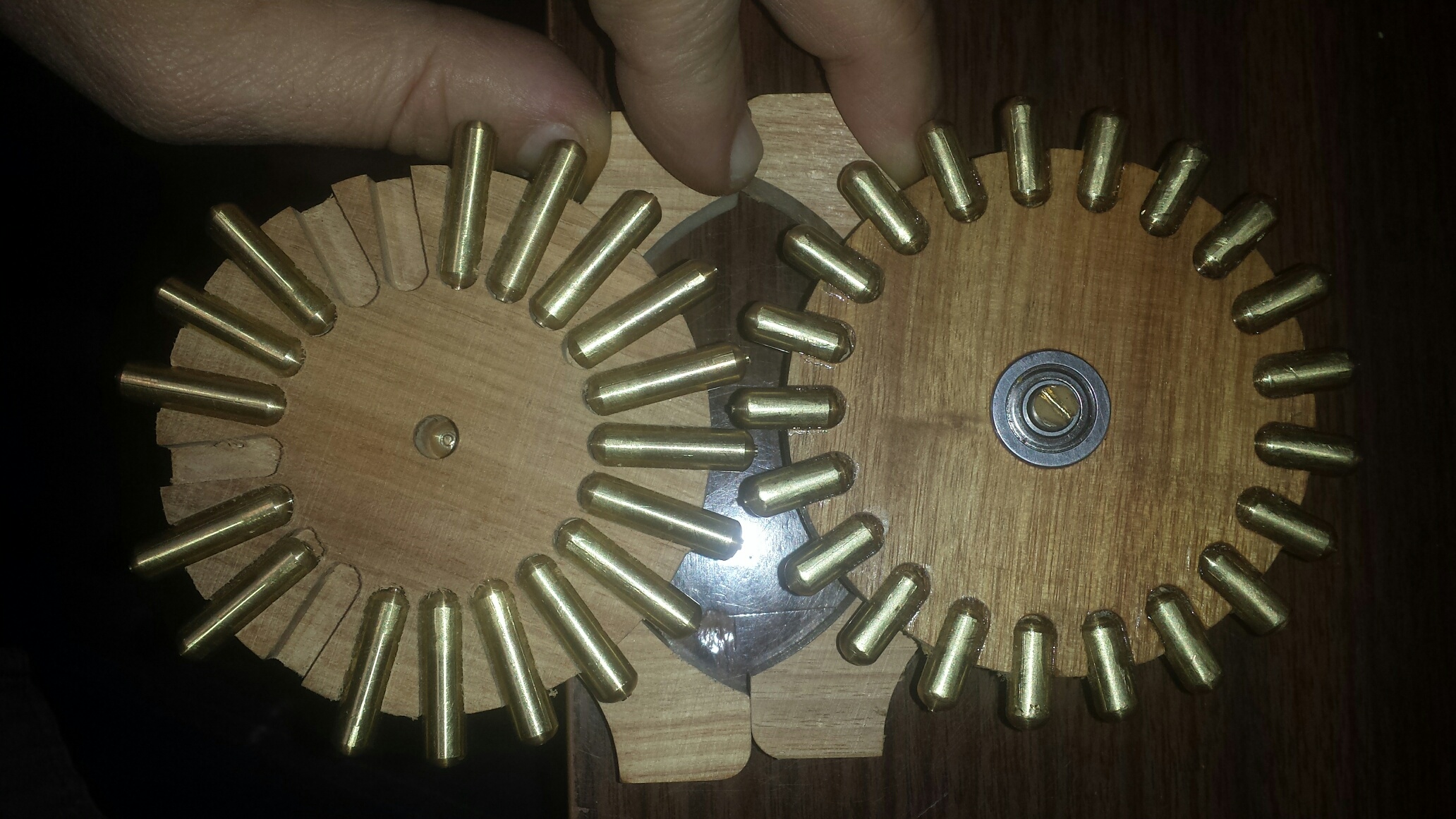

Note for those interested in crown gearing (quite a few have asked)..
To make spherical teeth gears easily as I can, I am machining slots into a blank and installing
brass pins with a rounded end. This makes spherical teeth. The pitch diameter (the point at which
such teeth mesh) can be found using Gearotic using a gear Module setting equal to the formula
Module = (Diameter of Rod * 2) / PI. So a 1/4" brass rod for example is a
module of (6.35mm*2) / PI = 4.0425, though I use 2.2 for backlash and a loose tooth fit
as Im making a clock type mechanism. Ill post a photo of such a gear set below with
20% designed in backlash.These two gears will have a hinge so they run at any angle
their tilted to up to 90 degrees. For hinged gears the hinge point must be inline with the
tooth contact point at pitch radius. Ill post a video when and if it runs. :)
