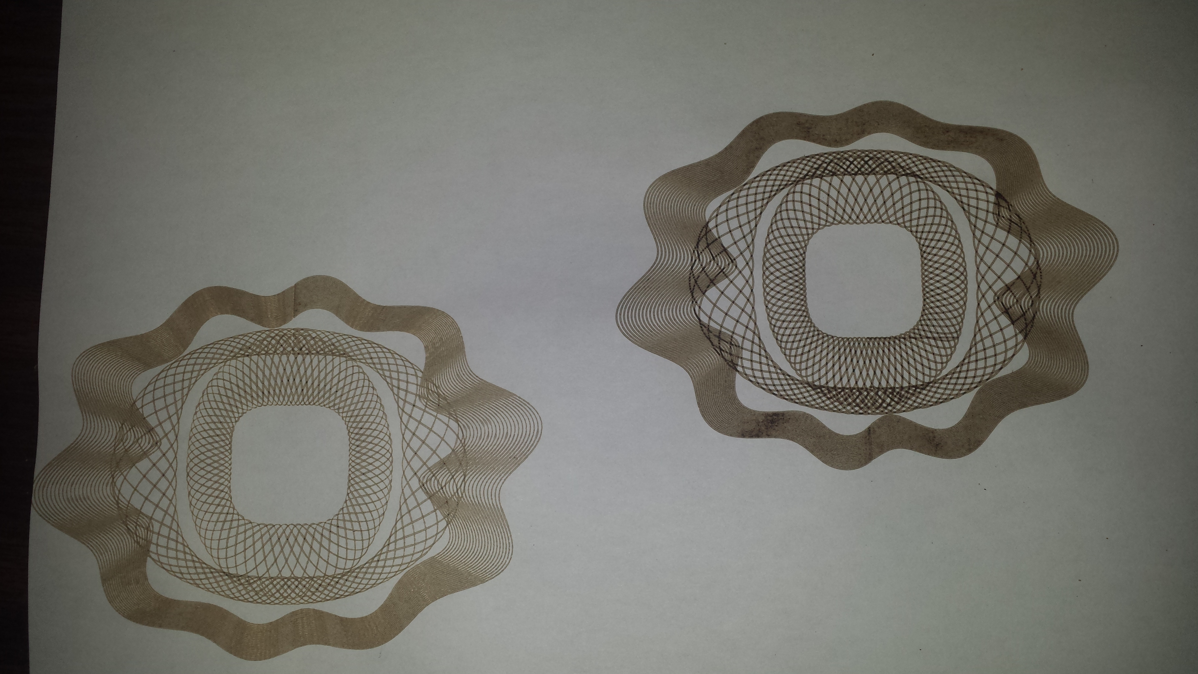

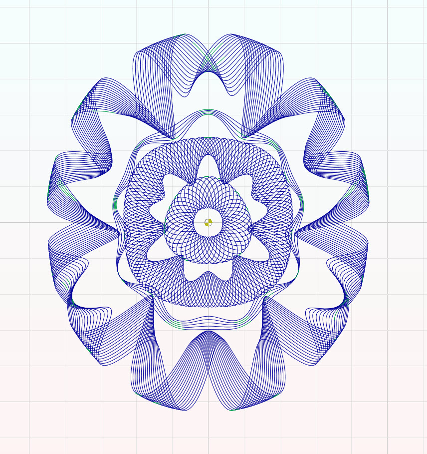

Only a few days to Christmas, where does the time go? Im almost finished a rewrite of Vexx's database
because it was driving me crazy on large files, and the new Guiloche wizard is about ready for release.
Heres a couple of laser burns I did a few days ago in testing..

You never cease to amaze me! I can see I need to upgrade my software and have a more serious play with Vexx.
Building a CNC router that actually works as well as I want it to and various other projects (plus having to earn a living) have kept me busy over much of 2018 but 2019 might actually see me complete a clock! I've spent plenty of time with Gearotic and CamBam, just need to get the machine finished to cut out the parts.

  In truth I didnt know what a guilloche was until a Gearotic user requested I take a look
at it. I knew the word but hadnt really consider their history. Im in his debt, they are
very interesting as a subject.
