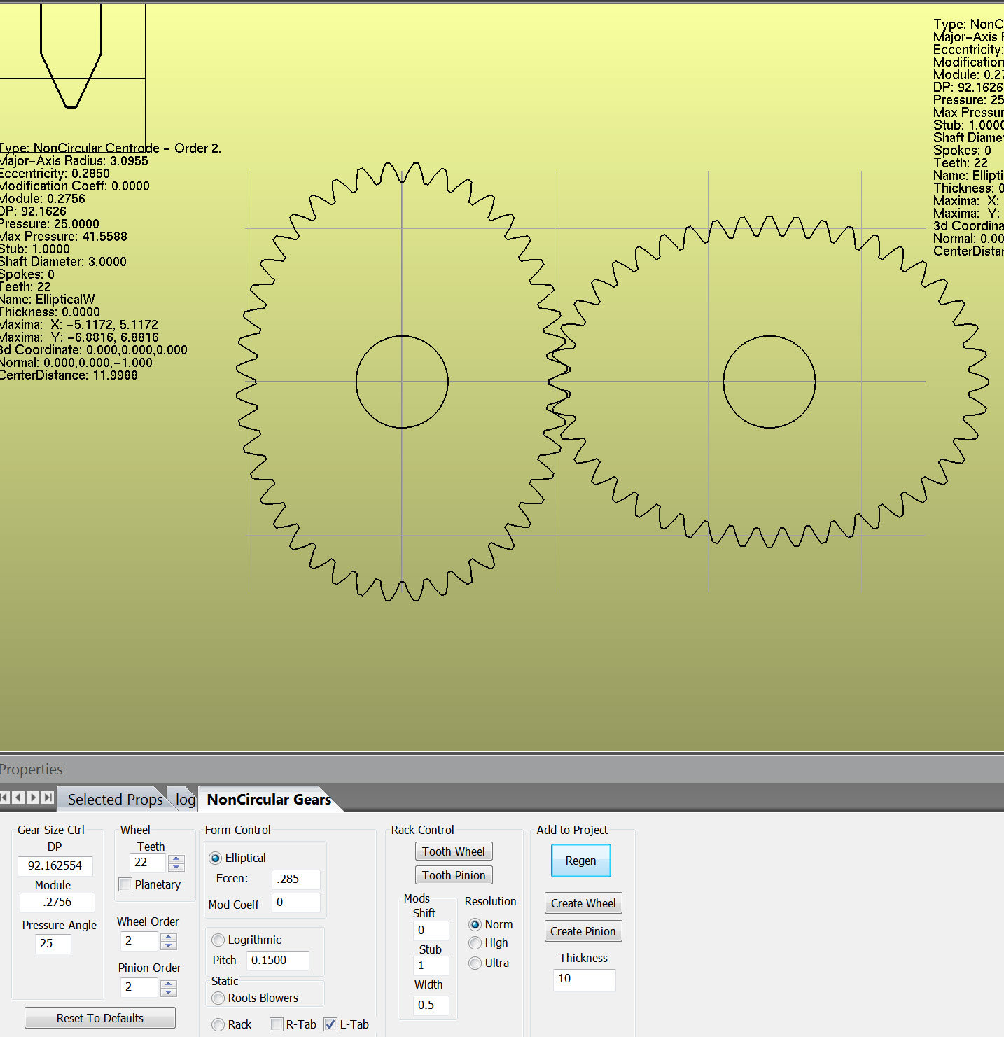

I have decided to use an oval gear for the flow meter as I have read that they work better with the lower viscosity fluids that I will me measuring.
I am trying to draw a tiny oval gear similar to the one in this picture:
At its widest point it is 7mm and at its narrowest is is 5mm and the shaft is 3mm  22 teeth.
Is there a setting in Gearotic for me to enter these measurements? Or do I just have to adjust the DP untill I reach these measurements?

Hi Mat:
    I checked on this to see if I could just give you the numbers and I can see
the screen numbers are misleading, Ive added a development note to revise them.
The major axis radisu is incorrect on the screen, its actually the radius of the originating
DP pitch radius creating the gears.
  Untill I fix this and rerelease, here is how to get your gears made.
First, you want 7mm major and 5mm minor axis sizes. Im assuming these are
the pitch radius, if they are outside radius, you really want to know the shaft distance
instead.
  Lets assume a 12mm shaft distance for the sake of this example with 7mm/5mm
pitch radius gears.
  So set Mod to 1 and eccentricity to 1 - ( 5/7). So subtract minor over major desired
from 1. This gives an eccentricity of .285 . Regen the gear and youll see the distance
between shafts is 43.5mm's. The desired in this case is 12mm.
  So the Mod is linear to shaft distance. If we take a new mod number from the
setmod multiplied by the ratio of desired/actual, we get mod = 1 * 12 / 43.5370 = .275
Entering .275 into the desired MOD and pressing regen you'll now have a center distance
of 11.999mm. with the two meshed radii of 7mm and 5mm.
  Useing the shaft distance as your primary measurment, not the outside radius of the gear
will make this a very accurate. The eccentricity is the reciprocal of the ratio of major/minor end radii. The gears I get doing this are 5mm/7mm with center distance of 12. Heres a photo
of the end design, but Id encourage you to play with the numbers to see the effects
of the ratio and mod. I have made a note to replace the reading of major radius with the proper
one instead of the pitch radius of the DP circle at an order of 1.
Re: Gears for measuring flow
Matt:
Just a note, the elliptical displays have been repaired for next release to show both actual minor and major radii
of the elliptical pitch radius of each gear. Shouldnt be too long before a release, but if your finding it a problem, yell
and Ill send you a fixes version.

Sorry for not getting back to you, I have used your advice and created some gears that I think will work.
1 issue that I see with these small gears that I am making is when I export them to dxf I see some jogs in the lines like the attached pic. Is there a way to smooth this out? The full dxf file is here: https://drive.google.com/file/d/1IS3cE6 ... sp=sharing
Hi Matt:
  I suppose many cad programs will filter the lines, they result from the way
these gears are created, though the envelope of iterative positions all subtracted
from the gear blank, a type of digital hobbing. This type of generation ensures
higher accuracy than most analytical creation of elliptical gears, but it has the
side effect of the small variations you see. They typically though are so small
a variation as to not affect the output.
  I dont have anything in gearotic to smooth them, I always figured the smoothing
can actually make a worse mesh. If you measure the variation you'll usually find
its a small enough number to discount as a percentage of the overall gear tooth
and doesnt typically affect the mesh.
