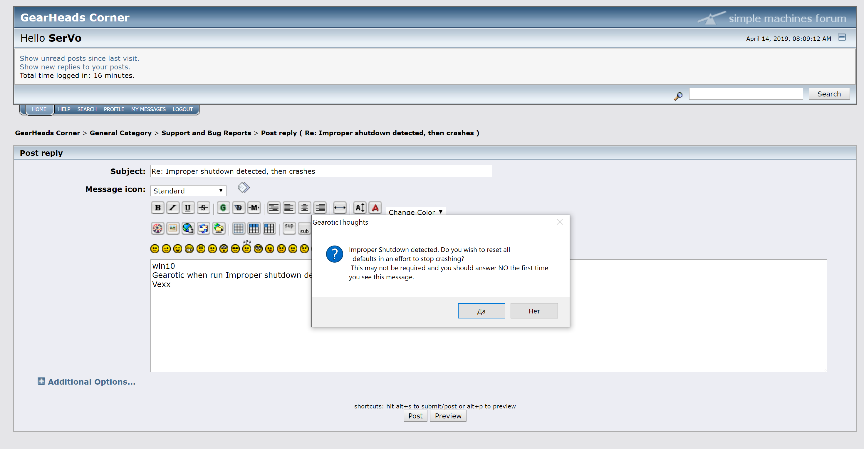

Re: Improper shutdown detected, then crashes
win10
Gearotic when run Improper shutdown detected
Vexx not run(((![Image]()
Vexx not run(((
Hi Servo:
That message means the last run of gearotic had trouble so it wants to know if it should reset all variables back to defaults. I do have reports from about 3 people who have
this issue with Win10. Im sorry that I have no solution at this time. One person reported
a reinstall of Win10 fixed his issue. You should try "Run as Admin" just in case its a
permissions issue. Also, make sure its installed to C:\Gearotic as per the default. Moving
it to ../Programs files/ will cause it to fail on some systems.
