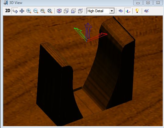

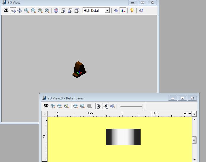

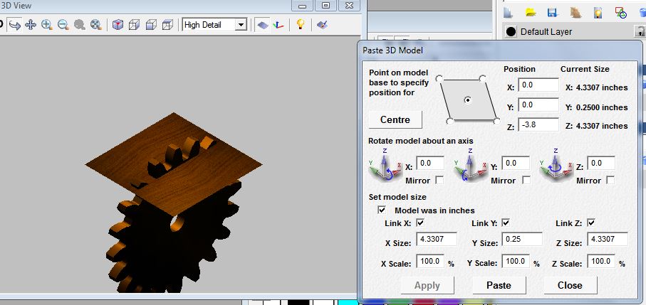

Re: Gear tooth as a height map?
you talking about something like this?
artcam can create 3d bitmaps of 3d objects (in this case an stl import)
the bmpfile is of the single tooth

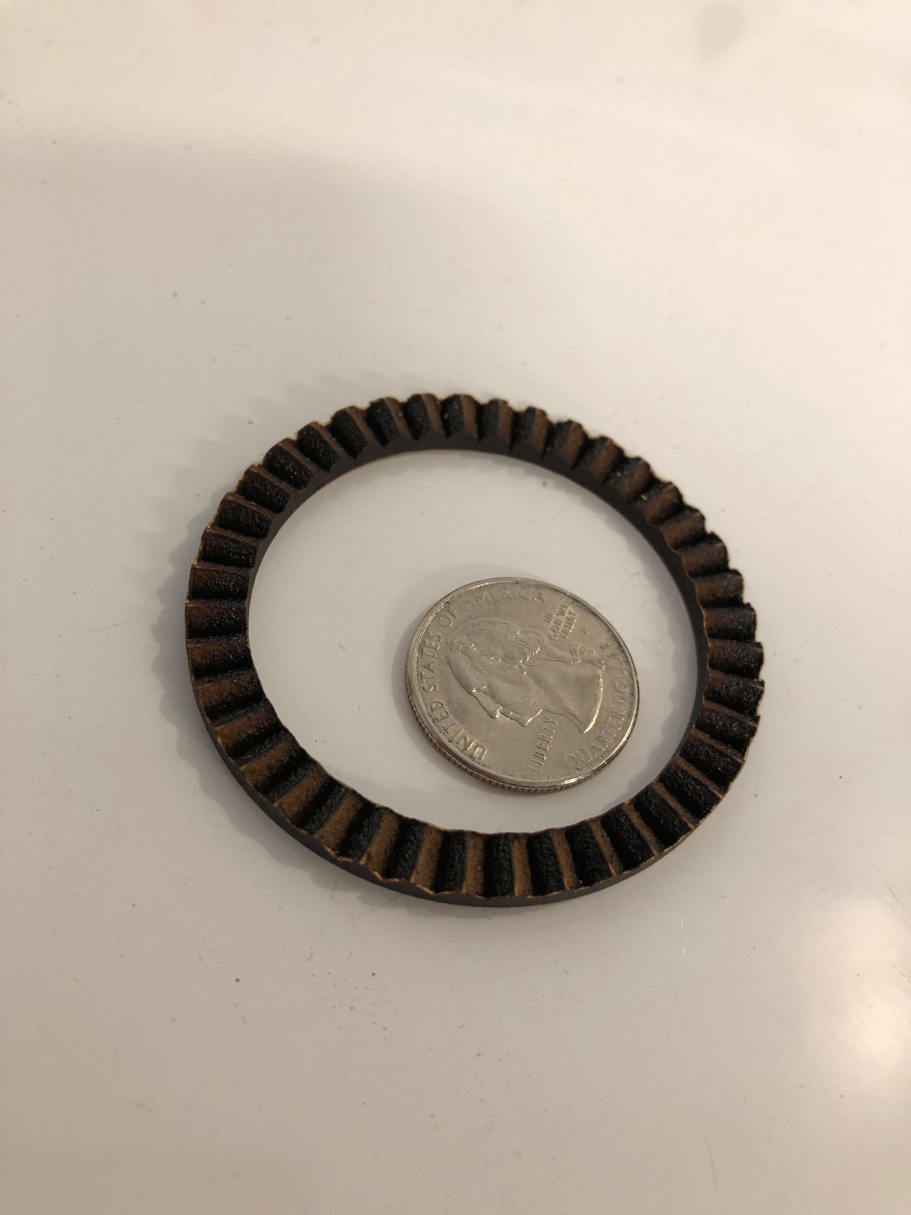

Had (yet more!) guests recently, so I was delayed in responding -- I've managed to semi-successfully cut a crown gear with a laser using the info posted above by Ya-Nvr-No, shown (attached) with a quarter for scale.
You'll notice some roughness on the outside perimeter of the crown -- this is because the laser turned out to be more accurate than I'd expected (and my software, meanwhile, LESS accurate than expected), and so my final circular cutting pass left a wee smidge of full-height material at the edge. Which was broken off with a fingernail, hence the roughness. The height map also got a bit squashed, since the penetration of the laser is not perfectly linear with power. If I were being paid to do this I think I could establish an adjustment curve, but I'll leave that as an exercise for the reader...
...anyway, point being, it seems to work well enough for extremely low-force low-revolution purposes, which is fortunately all I care about! Yay!
