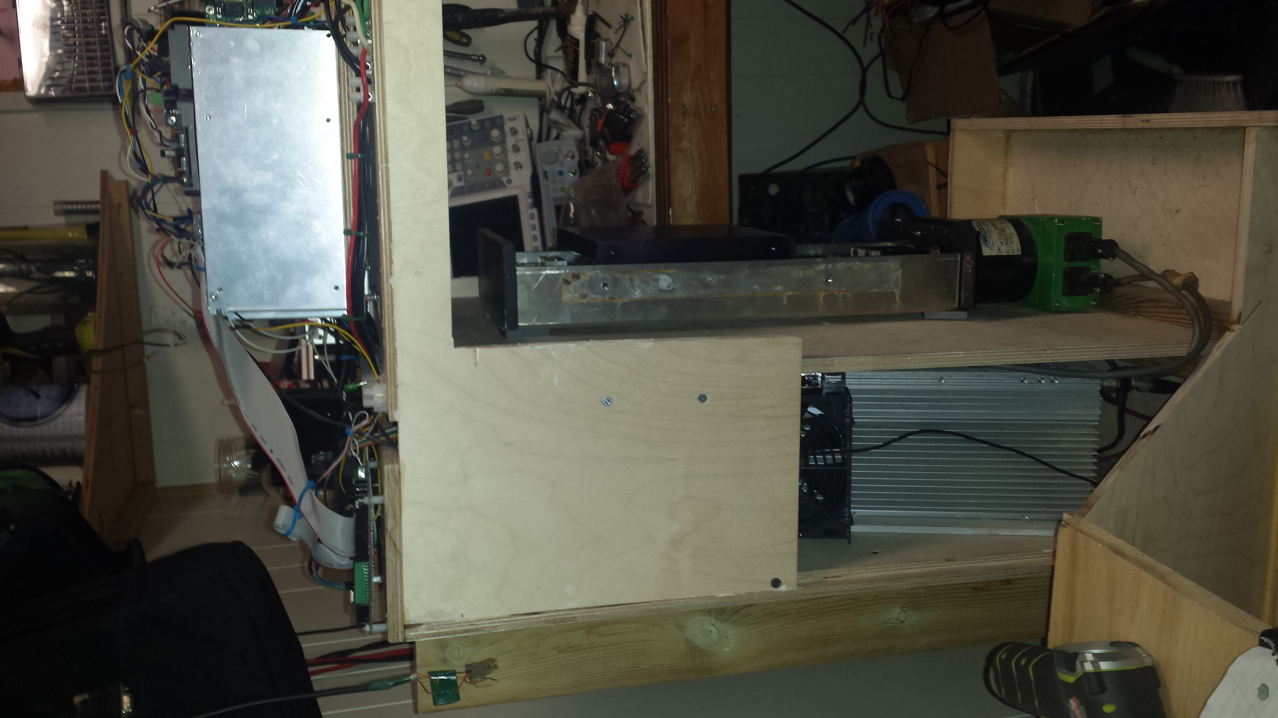

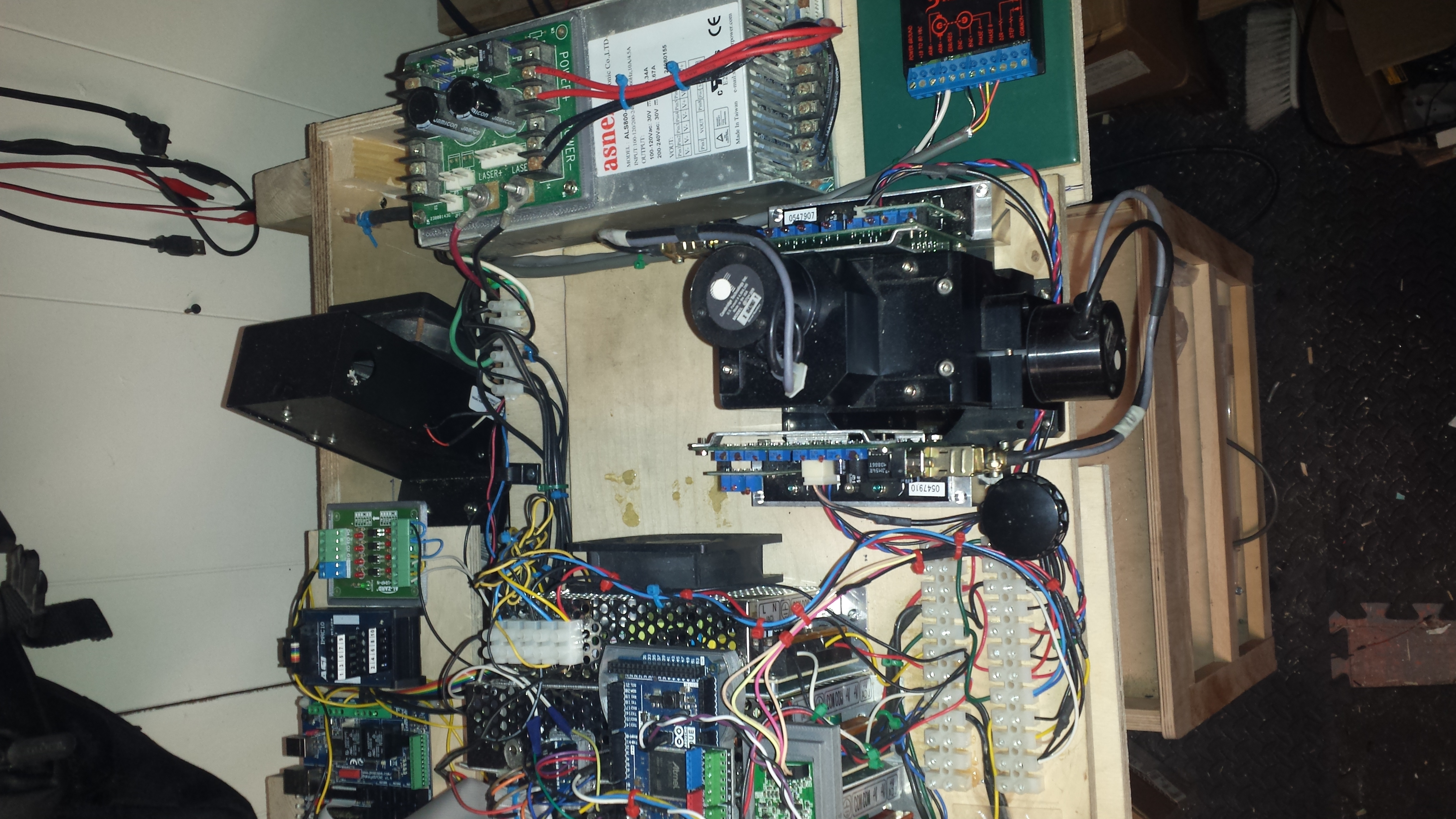

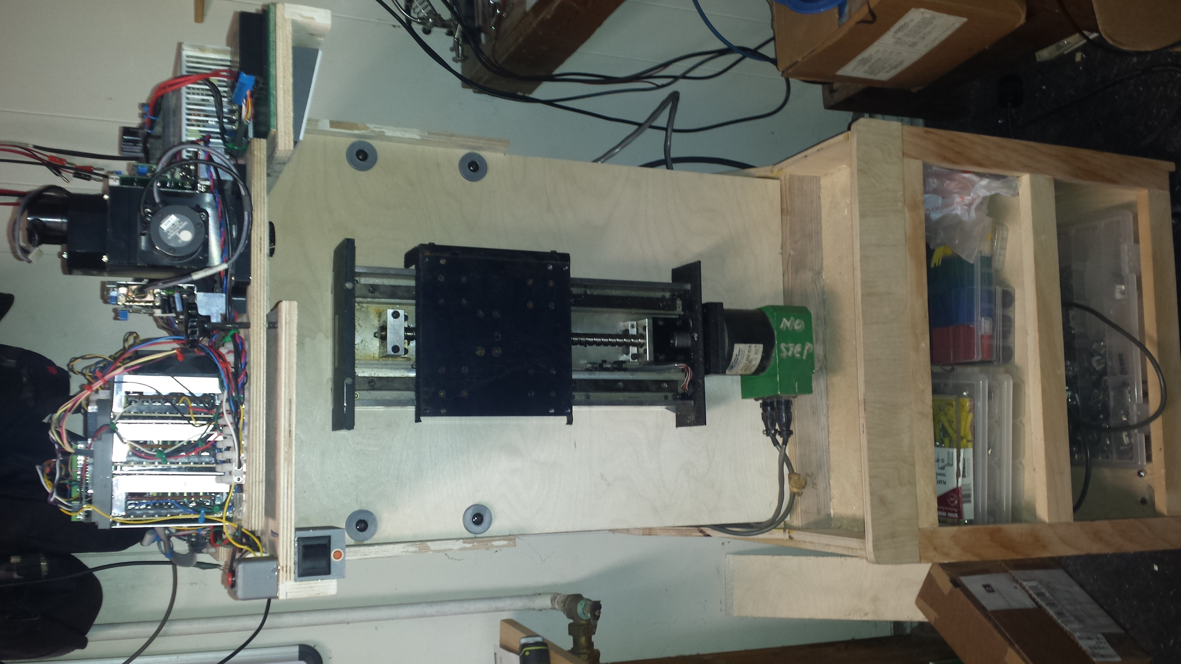

Heres 3 photos on my unit so far, from left, top and front.

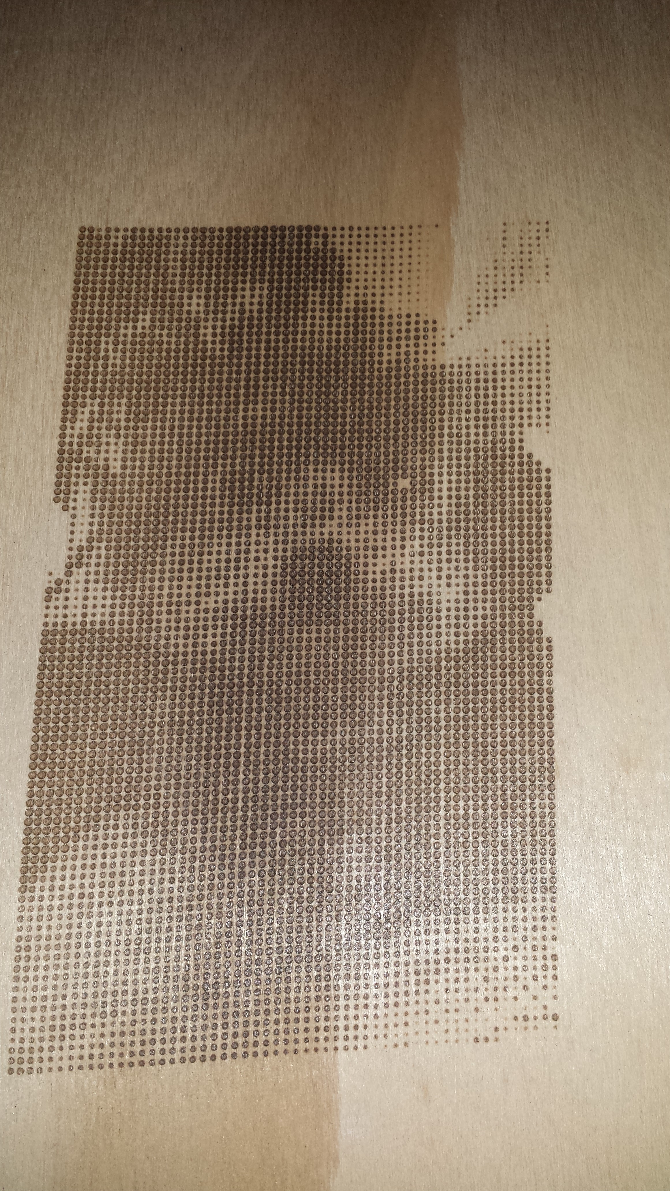

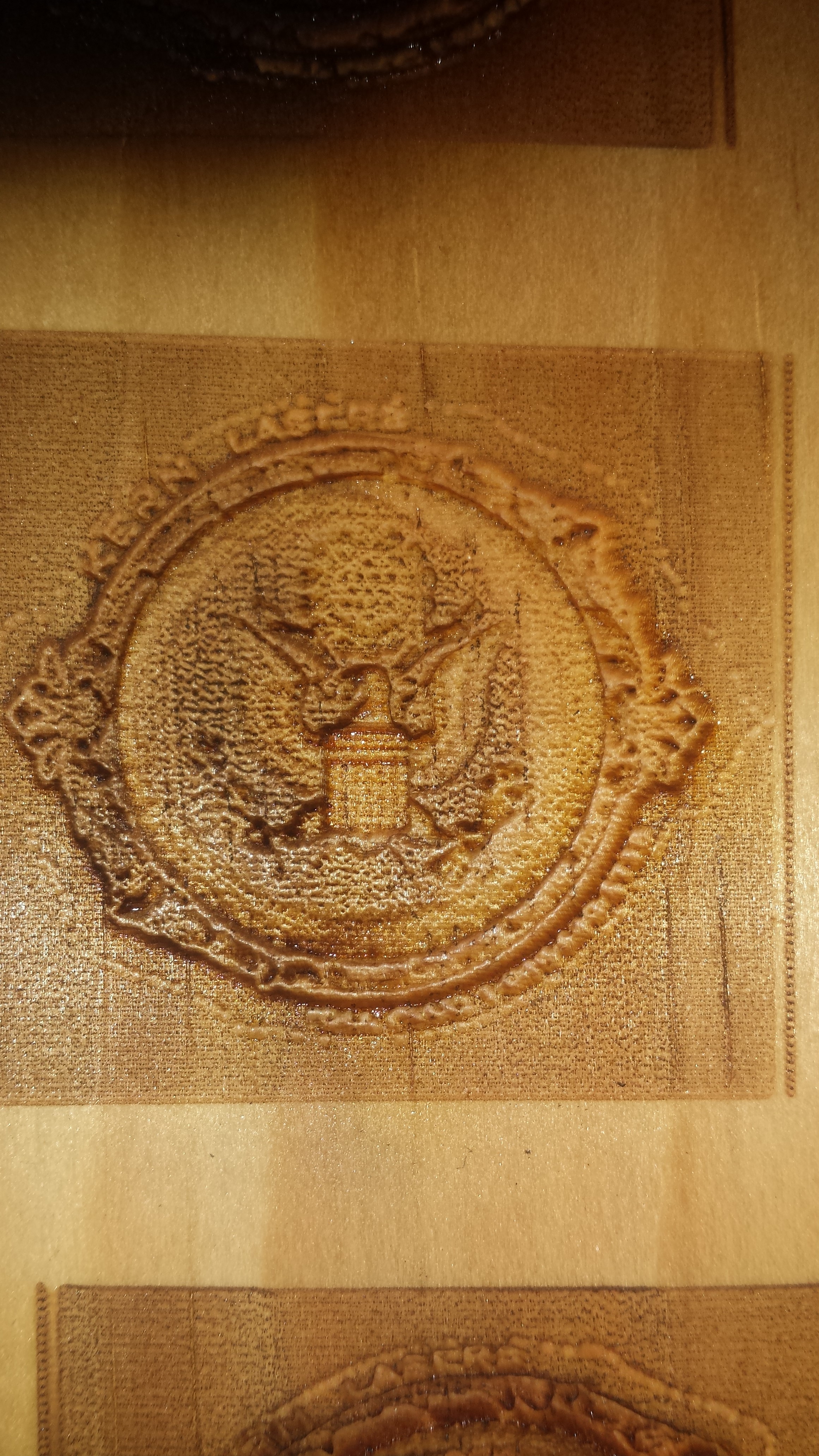

Re: Galvo Lasers
Well, heres an example, ( not great but first try) of a photo
in a new mode in auggie that increases discreet power levels
to more than 255, so one can have a distinct power per each grey scale.
This is a coarse 1mm dot pattern.
I raised my lens closer to the mirrors and now have 170x170 or so
as a field.
Re: Galvo Lasers
Looking good Art.
That is exactly the halftone technique required for Impact Magnet images on metals so could be a very useful future addition to Auggie's capabilities.
Re: Galvo Lasers
Hi Tweaky:
This is done with a new command effect. The Command
G04P1 is a 1 second delay. The Command G04P.005R50 is a laser shot
for .005seconds at 50% power. This is in normal operation.
But, if in Augment Mode ( an Augment image is loaded), the command
is ignored if the X,Y is outside the image, and modified if X,Y is in the image
to a time from .001 at power 1 (tickle) to a max power of .005 ( from the P
parameter) and the power varied from 1-99% all based on image density.
The command while in an image then sets max power and time both. This changes
the actual power per shot from 1ms at 0-100% to 0-max ms at 1-100%, which means
a great more grey scales or magnet power levels per strike.The algorithm will deduce
both power and time to arrive at a scaled valule of both that fits the image density
at that pixel. Soon it will supersample the image data to get sub pixel densities from
surrounding areas of the pixels density.
Also, Vexx has been changed to allow a "FastPost" of any drawing to a quick
Gcode file ( G0,G1,G2,G3 ) of any drawing group selected. Auggie then can
use that file for general vector work.
This means one can do a pattern Gcode in Vexx for a quick paste into any
augment file to change the pattern of the burn, this allows for other than
raster or circle patterns in the image burn.
These changes should all be in the next release. Auggie too will be updated as
it also has the distance correction changed to be much more accurate at smoothing
out corners, accel and decel zones for power linearity. Not perfect yet, but getting
much closer. the old dist correction was sometimes causing a dot at the start of motion.
Sorry for my slow updates lately, but the galvo project has a lot to learn from. :)

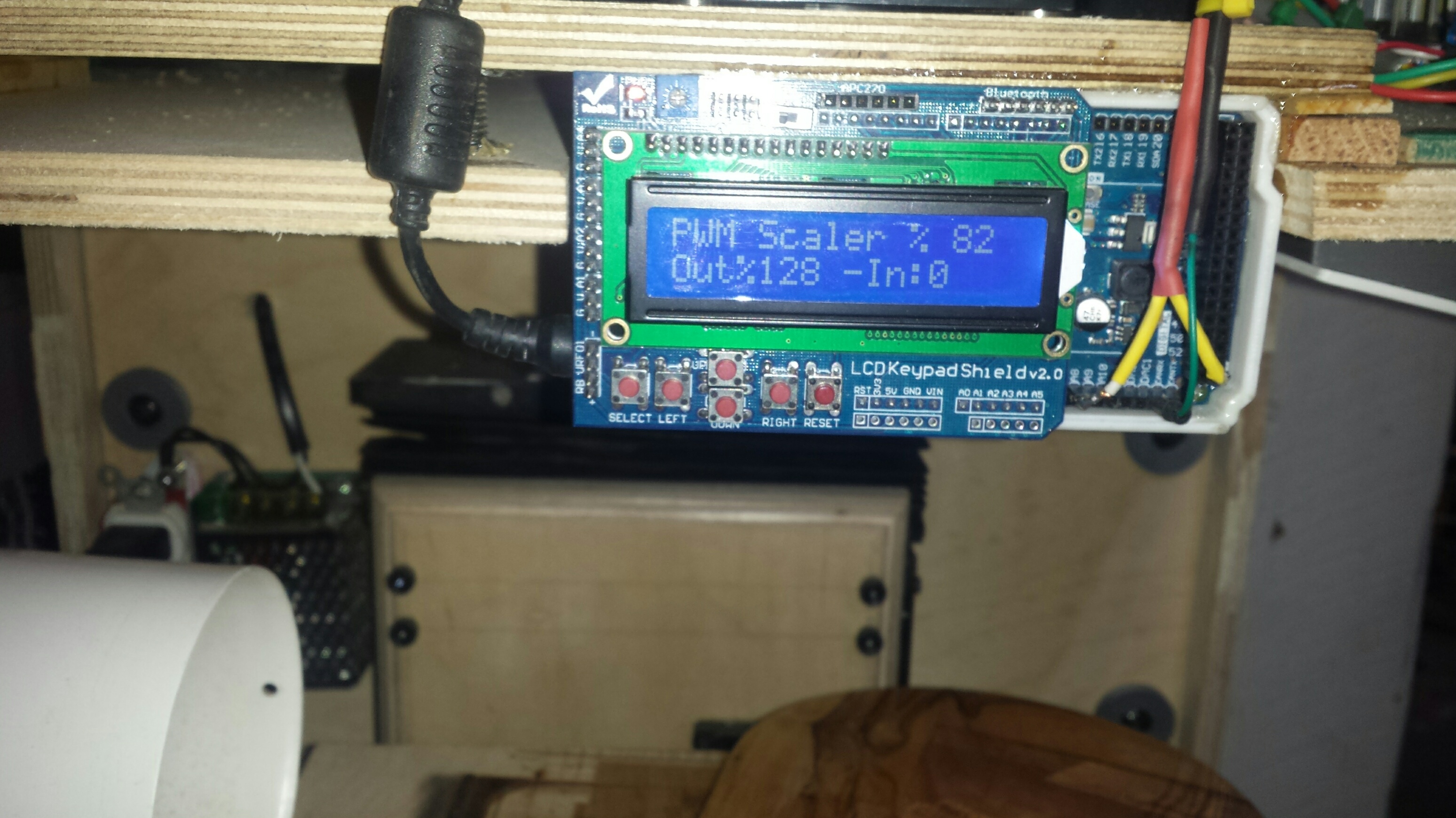

Re: Galvo Lasers
Tweaky:
In dwelling on your comments it occures to me I probably
should just add an Arduino that does nothing other than
control the PWM incoming pulses as a % of max. I think
Ill do that and have a "Power Scaling " hardware pot on the
engraver end. I could let Auggie run at 100% then and get full
scale on any power as a function of % scaling desired.
Arduinos are cheap. :)

Re: Galvo Lasers
To me, that sounds like the way to go.
