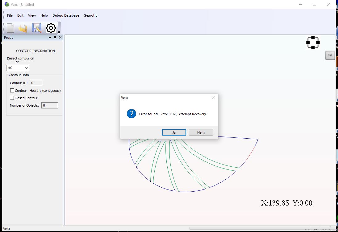

When I have selected the node by klicking on it once and hit the Delete button, VEXX deletes the whole segment.
When I have selected the node by keeping the left mouse button pressed and hit the Delete button, VEXX deletes the whole curve and I get VEXX error 1161.
Attached a screenshot and the file (generated with Gearotic)
best regards --- Peter

    Anyhow as to Error 1161, it is likely caused from the fact your active menu wasn't closed properly before jumping into another feature of Vexx? Users must click the OK button once any editing is done,  in order to jump out of that mode, failure to do so may results in similar errors. I believe you get to reload your project once it reboots, however some users have reported at times it doesn't work so well and you must start from scratch. Always wise to backup your work often?
Moving forward, your observations have been noted, they will undergo a review at one point, any changes or clarifications will be posted on this forum for all to see. Again, thanks for your input.

  Just a mention here for archival purposes, in the menu of Vexx is a Debug Database menu item, it will be removed probably shortly, but its there for any database errors you may get,
these show up as errors, or as a condition where the contours have trouble being selected or seen. If this happens to anyone, select "Debug Database, Reset/Reset All.
 This rebuilds the database. Originally, I had a great many database troubles, they are much less frequent now and mostly the result of the trimming algorithms. As you might imagine, figuring out the intersection points of these curves, which can get very complex, is a hard
thing to get a handle on, so errors creep in. I think Ive caught most of them , I dont get many
errors myself, but should it happen, use Reset, it usually calms the trouble and can help get you to a spot where you can save a file, or reload a corrupted one.
