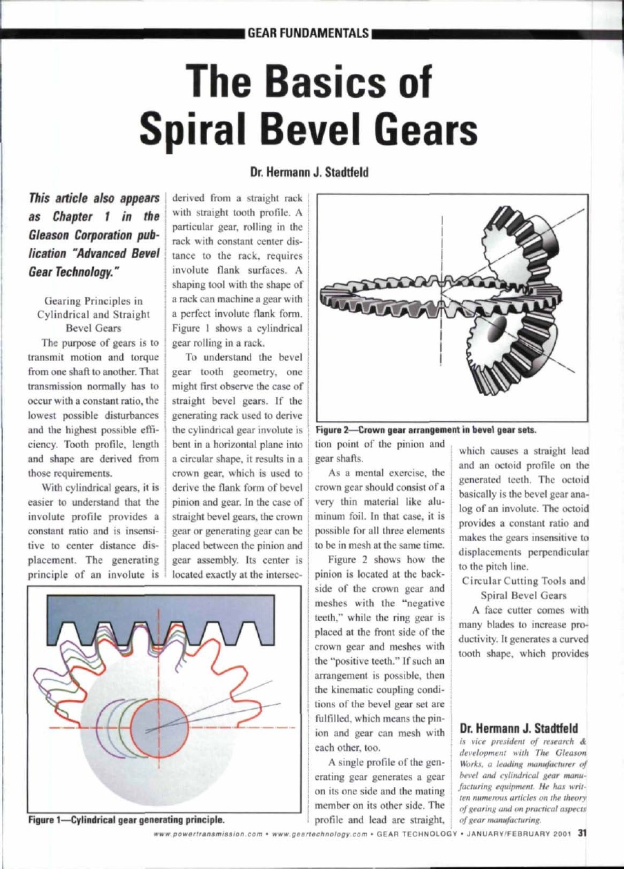

  Heres a photo of an octoidal generation. If the rack in this picture were not bent into a circle, the output
woudl be an involute tooth. BUT, as I suspected if you simply bend the rack into a circle, the result is an
octoidal tooth. Thats why no math formulas seem to exist. Its a physical manifistation of the bending of the rack to a circular form.
  Now..the golden question. I generate my bevel "Involutes" by formulas derived from standard involute teeth ( so a linear rack ), BUT then I bend those teeth into a spherical form in order that they taper
correctly in a bevel. If a octoidal is generated by a straight rack bend round, then is a tooth generated from a linear rack but then folded spherically now a proper octoid? I highly suspect the answer to this is yes. If we consider just the infinitely thin outside tooth of a spur for example, mentally its easy to see that if you take this tooth and fold it upwards in bevel form so it fits a spere, you have folded a modification into that tooth. I would submit its the same process as folding the rack and then generatign the tooth prefolded. I would have to do a great deal of math to prove that though, its simply my intuition that tells me this is so..
  I will give this more consideration, but I highly suspect an octoidal tooth is what we have. It cannot, after, all be called an involute tooth as the process of folding it into a bevel has changed its shape, so if it isnt an involute..what is it?... I suspect perhaps its an octoid. Since the term "Octoid" refers only to its contact pattern and not its shape, I can only surmise this as yet..
  SO perhaps just putting out this tooth shape for grinding will work..

Hi Alf, yes i think you're right. If you get a straight rack and project onto a sphere you will get 2 crown gears. But what happens to the tooth form when you get closer to the centre? This is where the octoid comes in. If you take one tooth flank of that crown gear, and another flank on the opposite side and imagine a surface that runs through those 2 flanks. As if you were holding a circular disc of paper and on one side twist it to that flank angle, then on the other side twist it to the other tooth flank angle. If you look at this shape side on, it looks like a figure "8". So microscopically where the tooth flank is, so so minisculely, it's slightly "s" shaped. Would be nice to prove it mathematically. And remember this is just the crown gear, not yet bent around a smaller gear. What'd you think?
