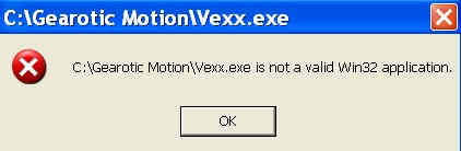

Is this a general problem or just my Mac?
Re: Release update
First Ive seen of it, it runs on all the windows machines Ive tested it on, but it is compiled under Win10 compilation tools. ( Though I run Win7 myself.).
Lets wait a day or two and see if anyone else has the same issue.
