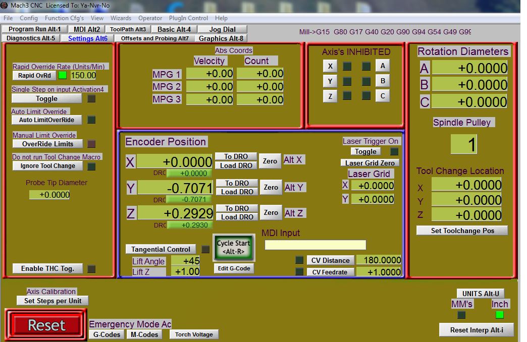

Re: Need Help Cutting my first 4th axis gear
Thx to YaNvrNo for sending me a photo of the setup screen, the DRO is labeled A Axis Diameter. I used
the setting rarely enough to forget its location..
Heres a snapshot, all rotations axis may be set this way..

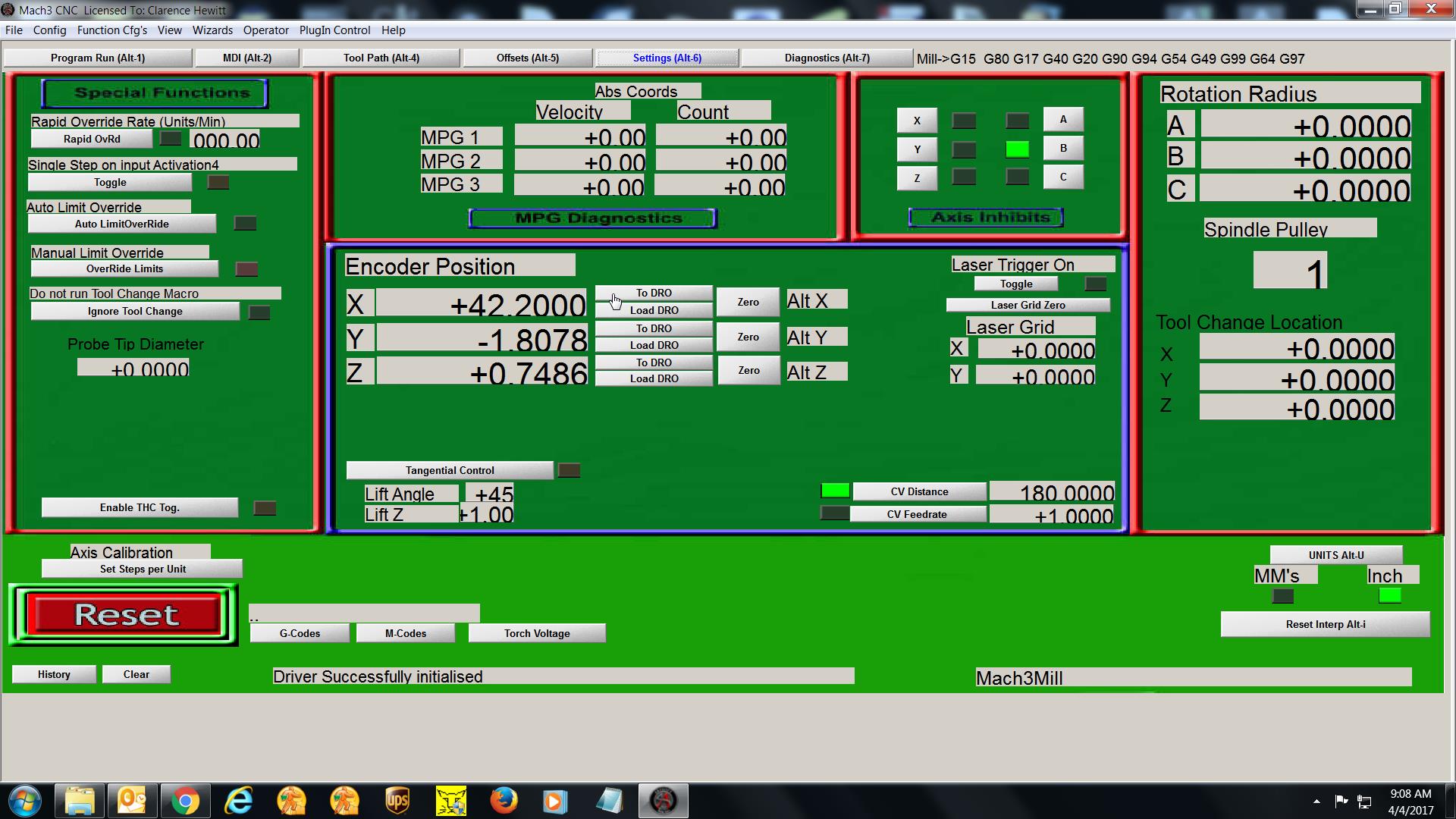

Hmmm. shouldn't the screen say radius like mine? But am not sure why or how I was able to set it to radius.
ArtF wrote: Thx to YaNvrNo for sending me a photo of the setup screen, the DRO is labeled A Axis Diameter. I used
Seems to me there was a couple versions of that screen Dan, you may have an older ( or newer ) one..
