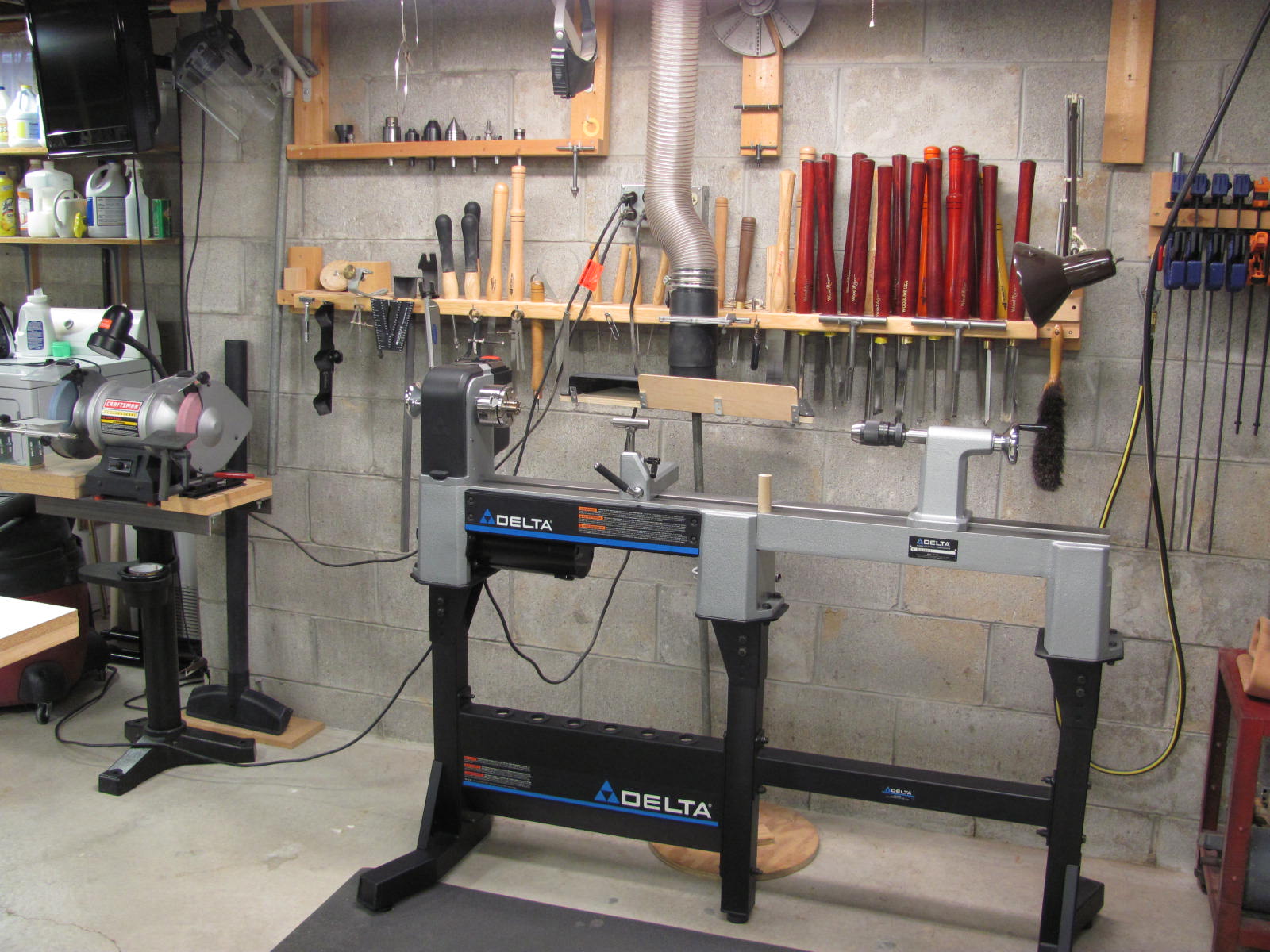

I too missed it the first time around; impressive.
Your shop in the background is impressive, too. I don't think mine has ever been that neat and organized. Is that a Grizzly wood lathe hiding in the background, only caught a quick glimpse of it?

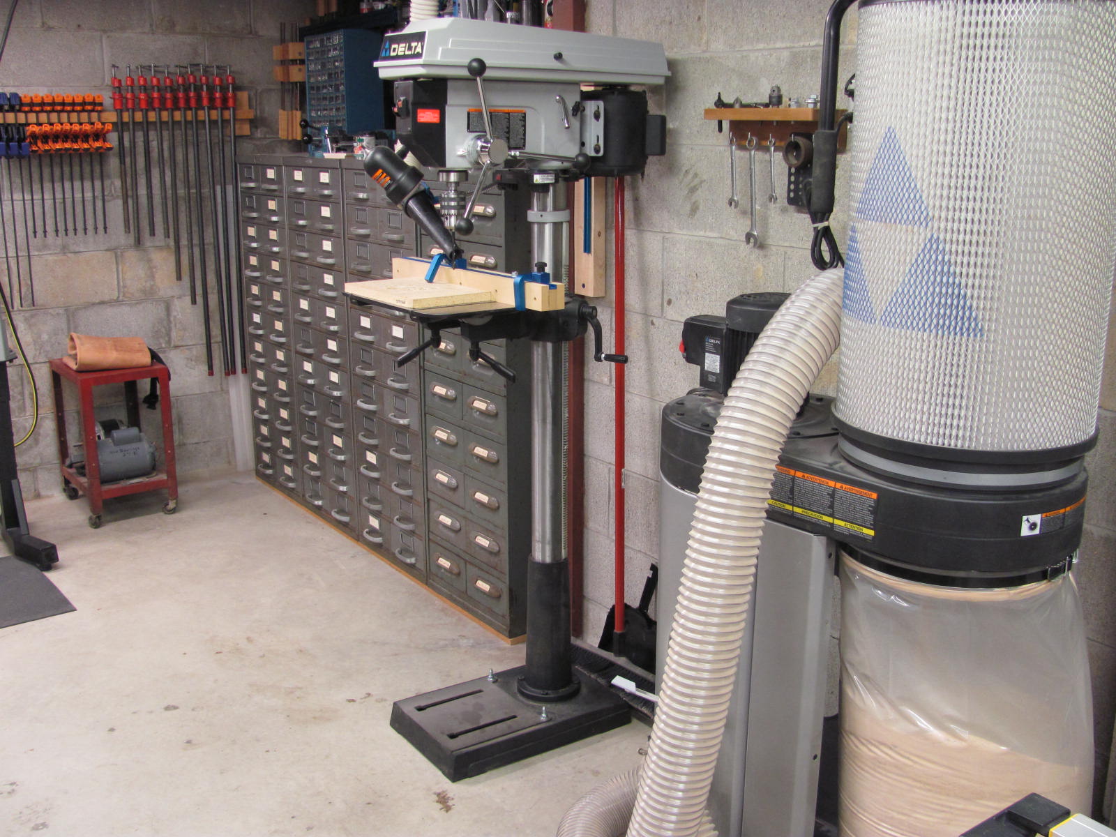

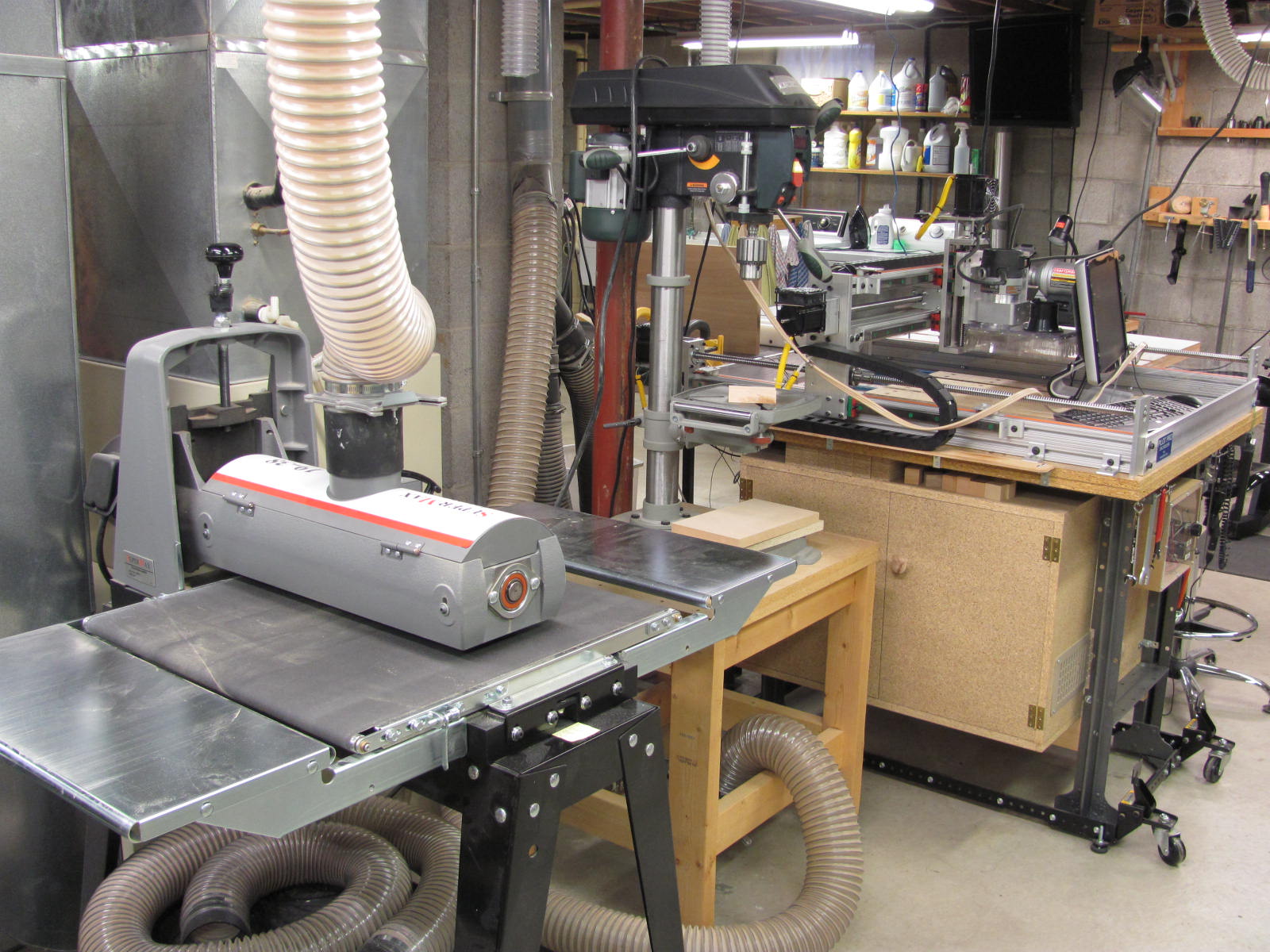

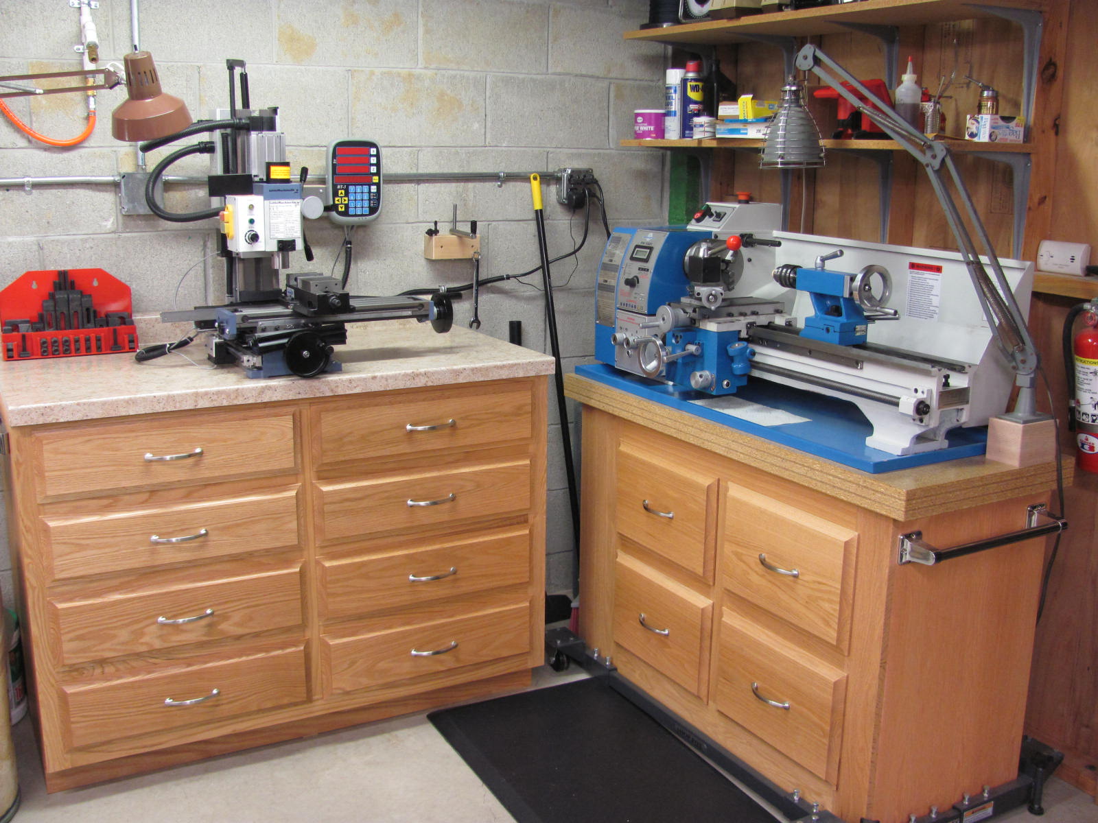

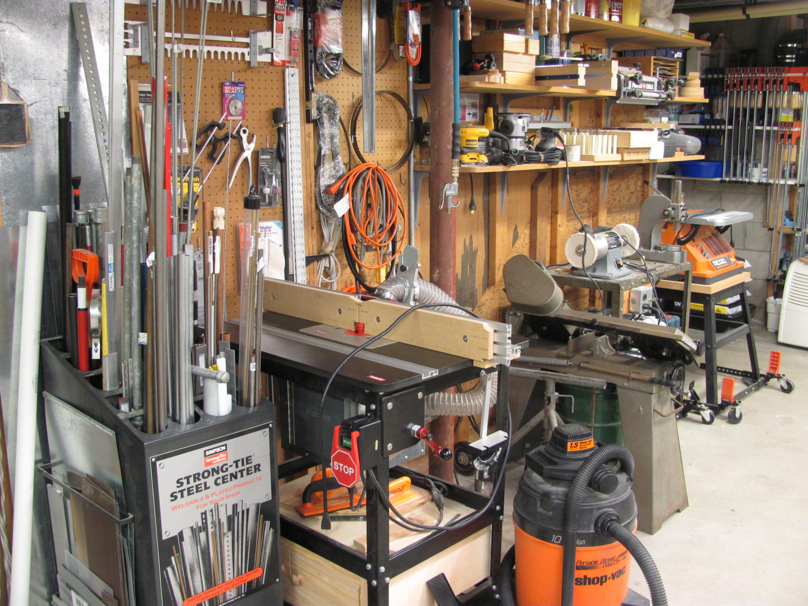

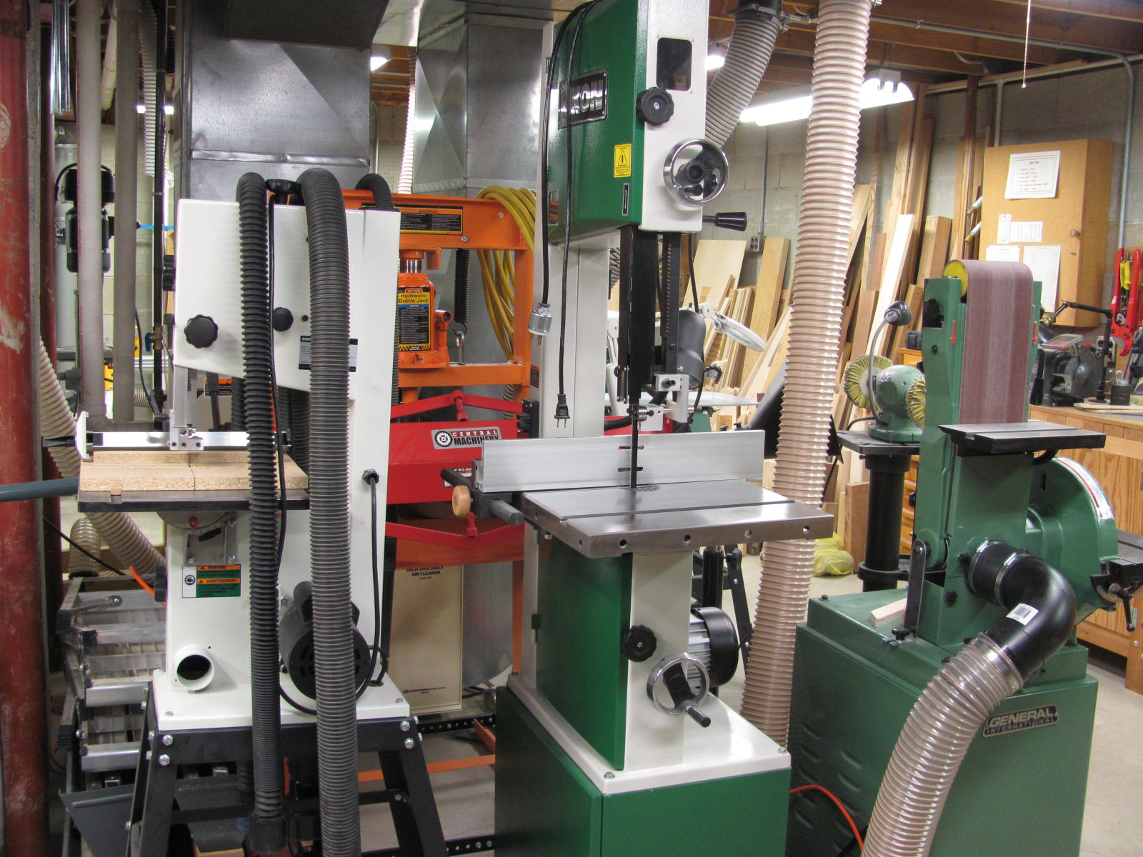

Re: Reciprocating Arms

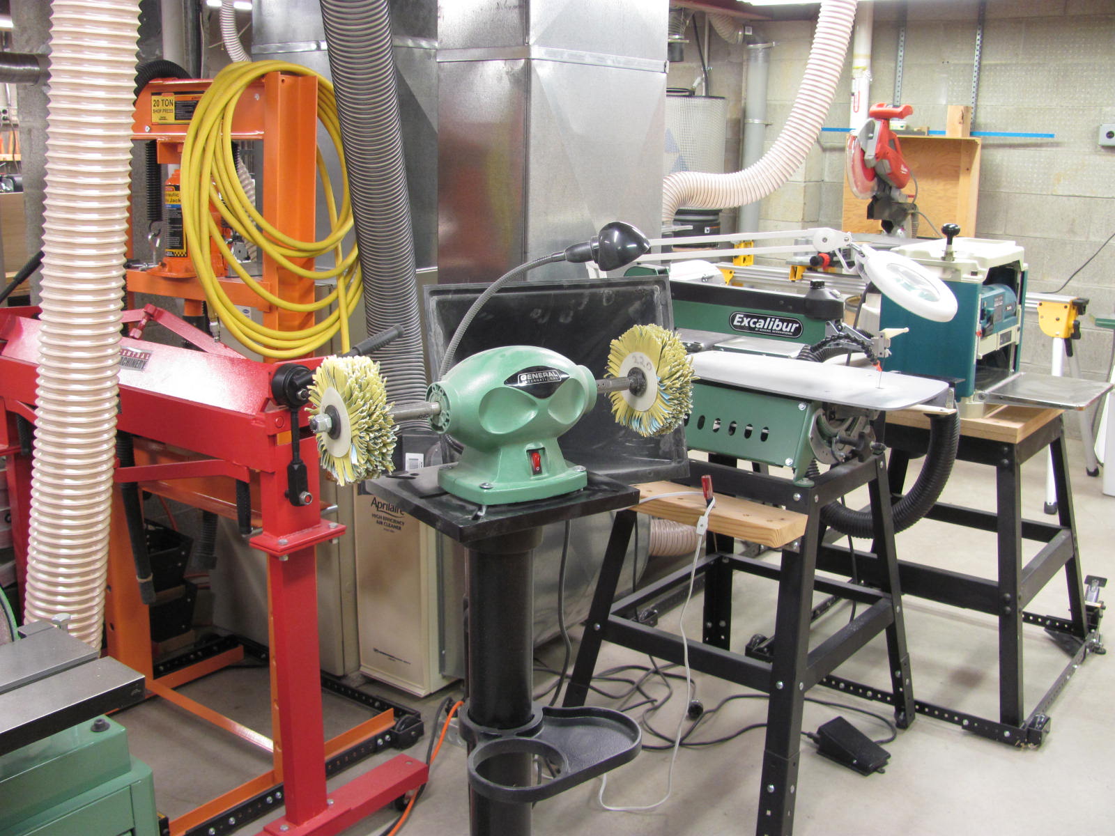

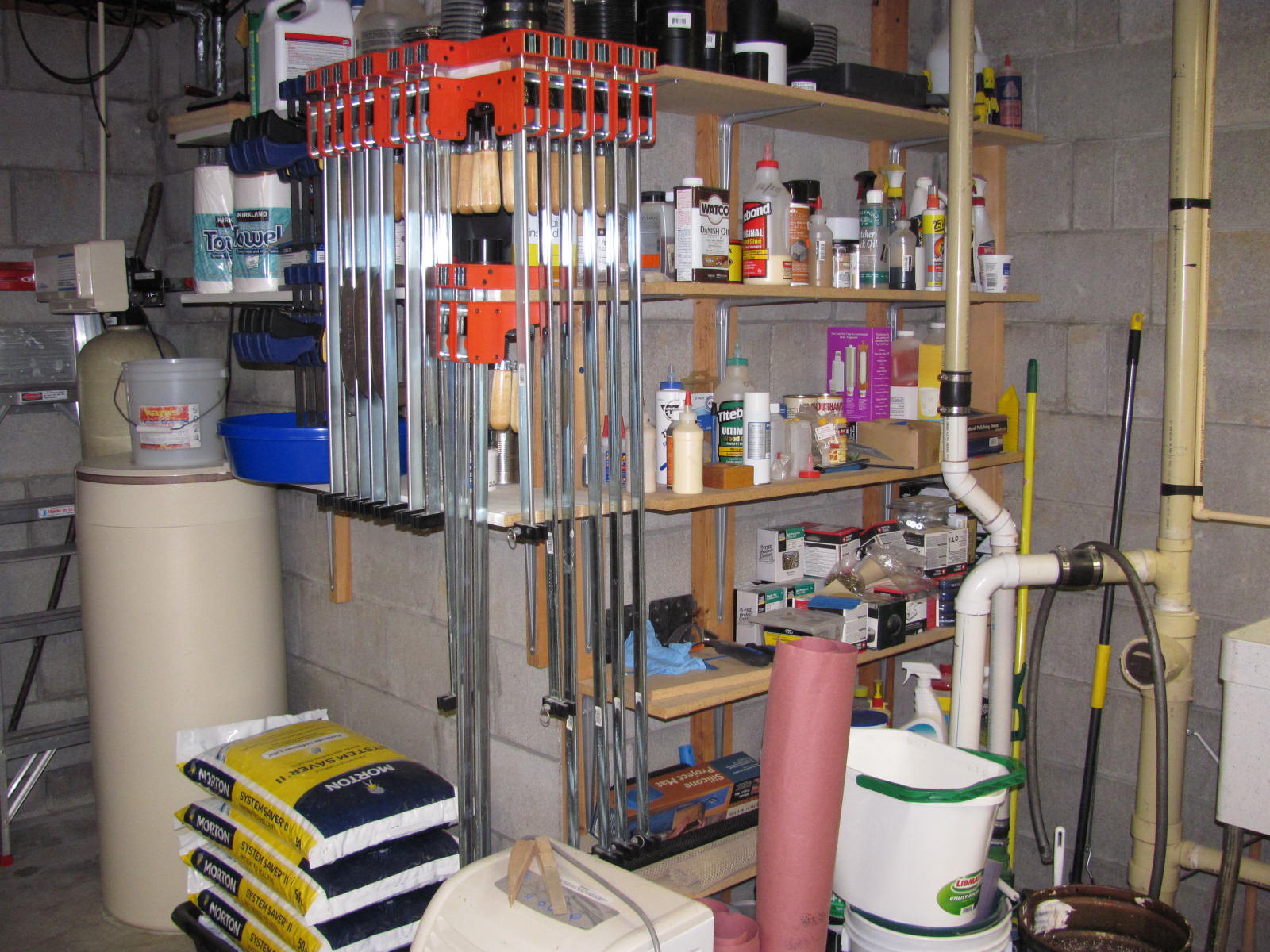

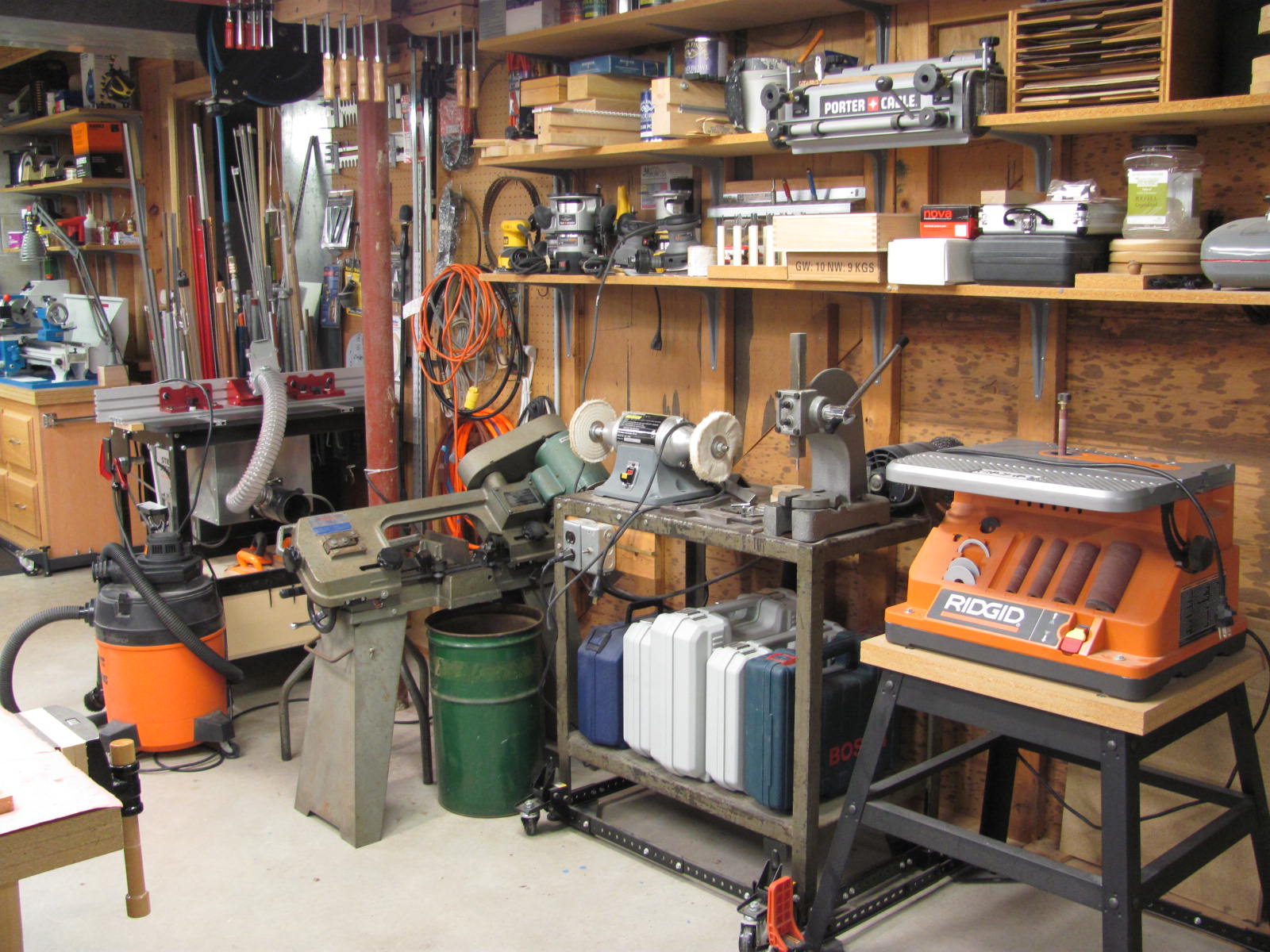

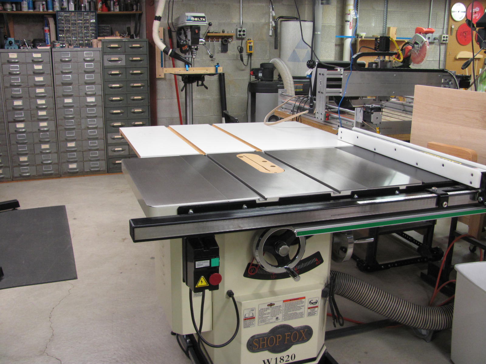

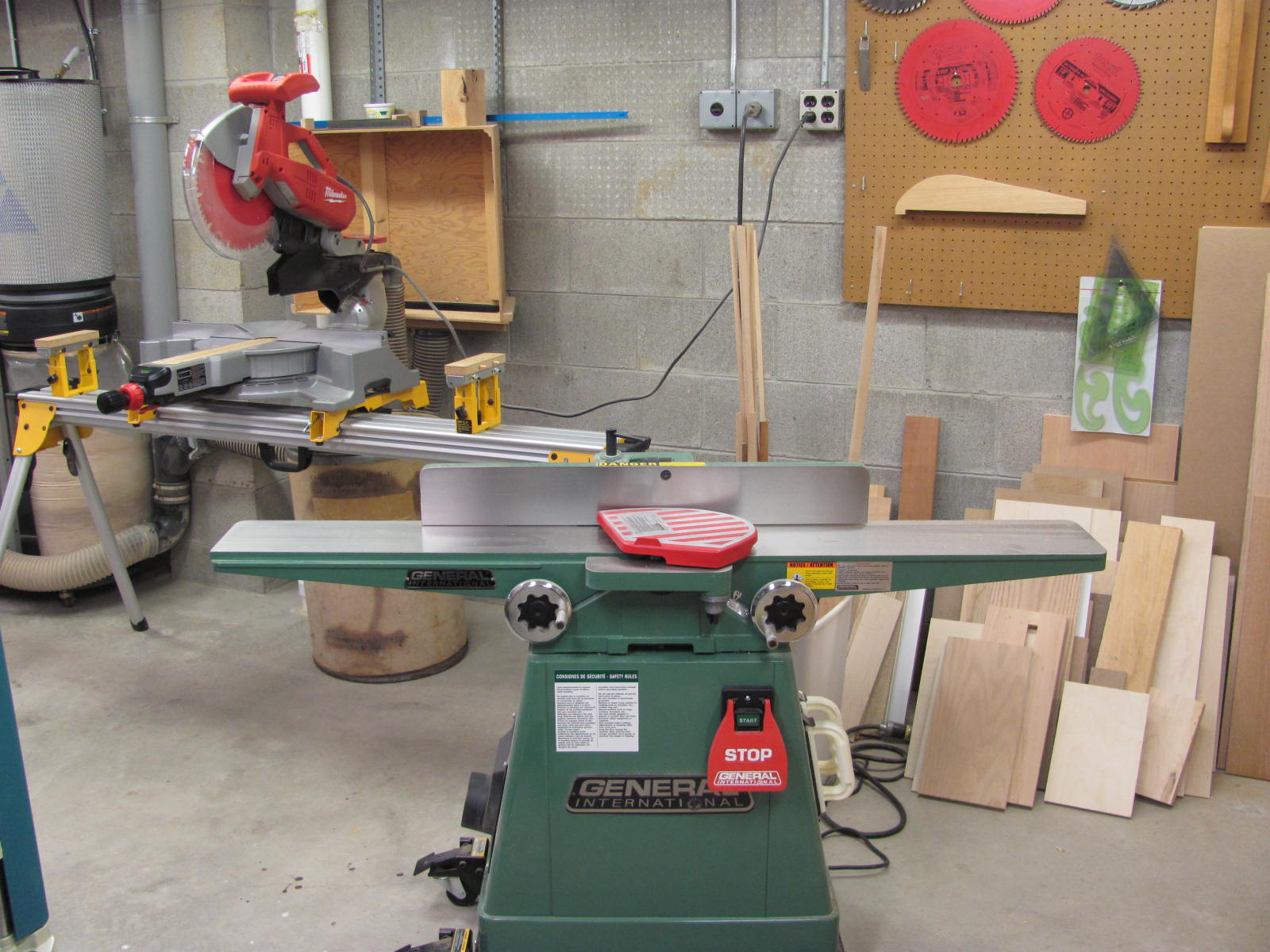

You opened a can of worms asking about my shop. Others have commented on it from time to time so I will give you a little pictorial tour. FYI, my shop is not overly neat, it varies depending on the state of my work in process. I will probably have to post over three messages due to the number of photos. Since I have limited space (don't we all), most stationary tools are mounted on wheels and I move them into a clear space as needed. One thing for certain, I have a very understanding wife!
Mark
Mark
I need more room and a bigger allowance :)
I looked at (online...) the tabletop Delta midi-lathe, but went with the 12" VS PSI since I've used one in the adult shop at the high school - if it holds up to HS students it should work for me. Had it about a week now, even made a couple things that didn't go into the woodstove.
We have the same metal cutting bandsaw, but mine is red and had a 20% off coupon. I'd like the Simpson metal rack, better than leaning it in corners against the wall...
Still impressed, and it's way neater than mine. Gotta get out the broom and shop vac, not to mention another sort and put away session, longer than the last one. Your pics are an inspiration!

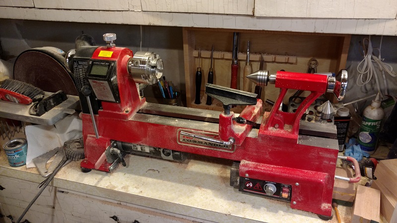

That Simpson rack was on sale at a building center that closed. I think I paid $10.00 for it loaded with all kinds of metal shapes and threaded rod. You will also notice lots of General brand equipment, I believe it is all made in Canada - very happy with the quality.
I never touched a wood lathe in high school. Purchased this one at a local hardware store for no other reason than I thought it would be fun. I spent the first year discovering that wood turning begins at the grinder, not the lathe. Once I got over the fear of killing myself, it's great fun and easy to make something in a couple of hours. It really comes in handy for making things like wooden clocks, kinetic sculptures and incidentals associated with Gearotic parts. Shavings are used in my gas grill to flavor meat.
Whenever someone posts photos of their projects, I always look at the shop behind the scene. Must be a guy thing.
Mark
