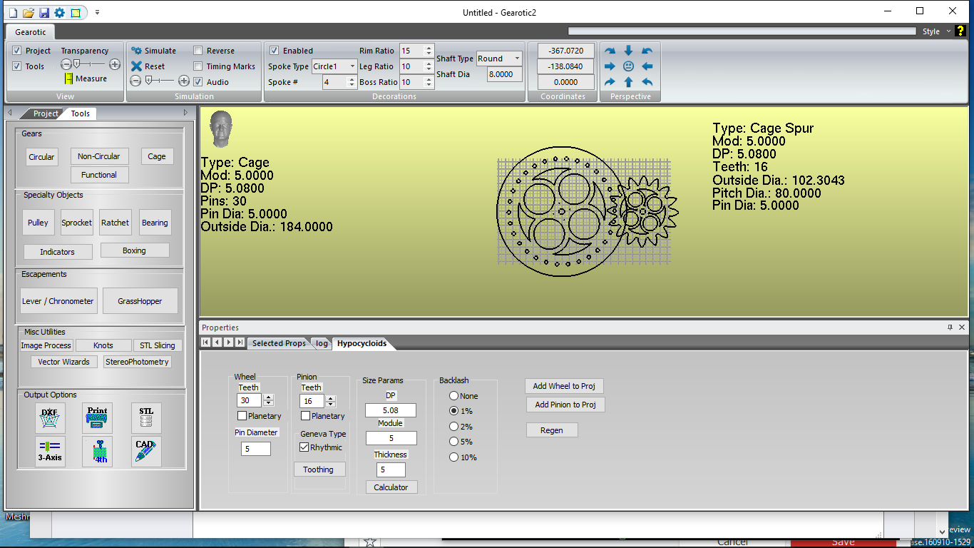

Re: Version 3.0
No project, I was just using simulation on the Tools tab.
I've attached a screenshot. Looks like I have rhythmic geneva checked, but no geneva. Hmm...
Re: Version 3.0
Hi Kirk:
My fault, I should remove at least one tooth in a rythmic geneva. It faisl if it has all its teeth
as it isnt rythmic anymore. Click on any tooth on the pinion to remove it and the sim will work
properly..
properly..

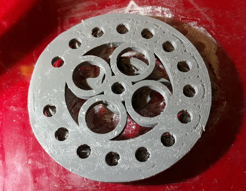

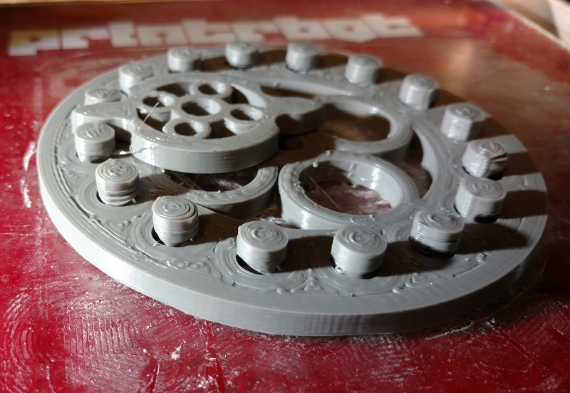

I drilled the baked in crud from the now discarded mystery brand cheap filament and resurrected the Printrbot, and made a two tooth rhythmic geneva. The pinion turned out fine. I selected all the pins and the cage wheel and created a combined stl object. No joy, all but one of the pin locations were created as holes, then the upper half of the pins dropped on the holes with no overlap - they were the same diameter as the holes. Just noticed when removing it that one pin was part of the wheel, but only one. Printed it for grins, anyway. Have a new spool of HH3DP gray to replace the mystery brand "silver", so this was a fair test of it. Good stuff.
In a perfect printer world the pins would have dropped into the holes, but they did print on top, with essentially no overlap, some of the plastic from part of the pin dropped into the hole and left a gap, and the pins wiggled a bit as the top surface was printed. Everything was sized properly, the pinion fit into the wheel when carefully tested, but any load will shear off the pins. Pic attached.
I expected the pins would have started at the base of the wheel and become one with it, then projected out of the top, as if the separate objects were merged before the stl was created.

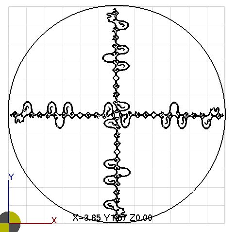

like that?
created a real narrow rectangle
fertilizer of 1 and motif of 1111111111111111's
did have to cut out a couple extra unneeded circles that got created.
Then just copied, pasted & rotated three more to see the effect
you can export one as a DXF then it can be used in gearotic as a spoke with some refinement of course.

Re: Version 3.0
::), but YaNvrNo unless ya try, so it was a surprise to me too.
I tried making it a spoke by first converting it to a polyline in autocad then center, scale and stretch to suit.
placed the resaved dxf in the spoke folder but found a few issues when used as a spoke. Pretty cool idea just needs a little attention to get a few things worked out. Hopefully we can get an option to save Vector/DXF as spoke. That's just how the development process works. Art makes some great tools and we find ways to push it, and it seems to inspire others to create things we never knew it could do. That's why coding is fun to learn, it opens possibilities.

Re: Version 3.0
Thanks, Art!
That picture makes the print look worse than it really is (except for the pins, a couple of which have already fallen off), although the temp and filament size needs to be tweaked for this new spool of plastic.
Could it be that the pins (except for the one that joined up) are too short and didn't include the gear thickness? Brass rod would make much cooler pins, but I need a better rod cutting device in that case, not too good with the short stuff.
